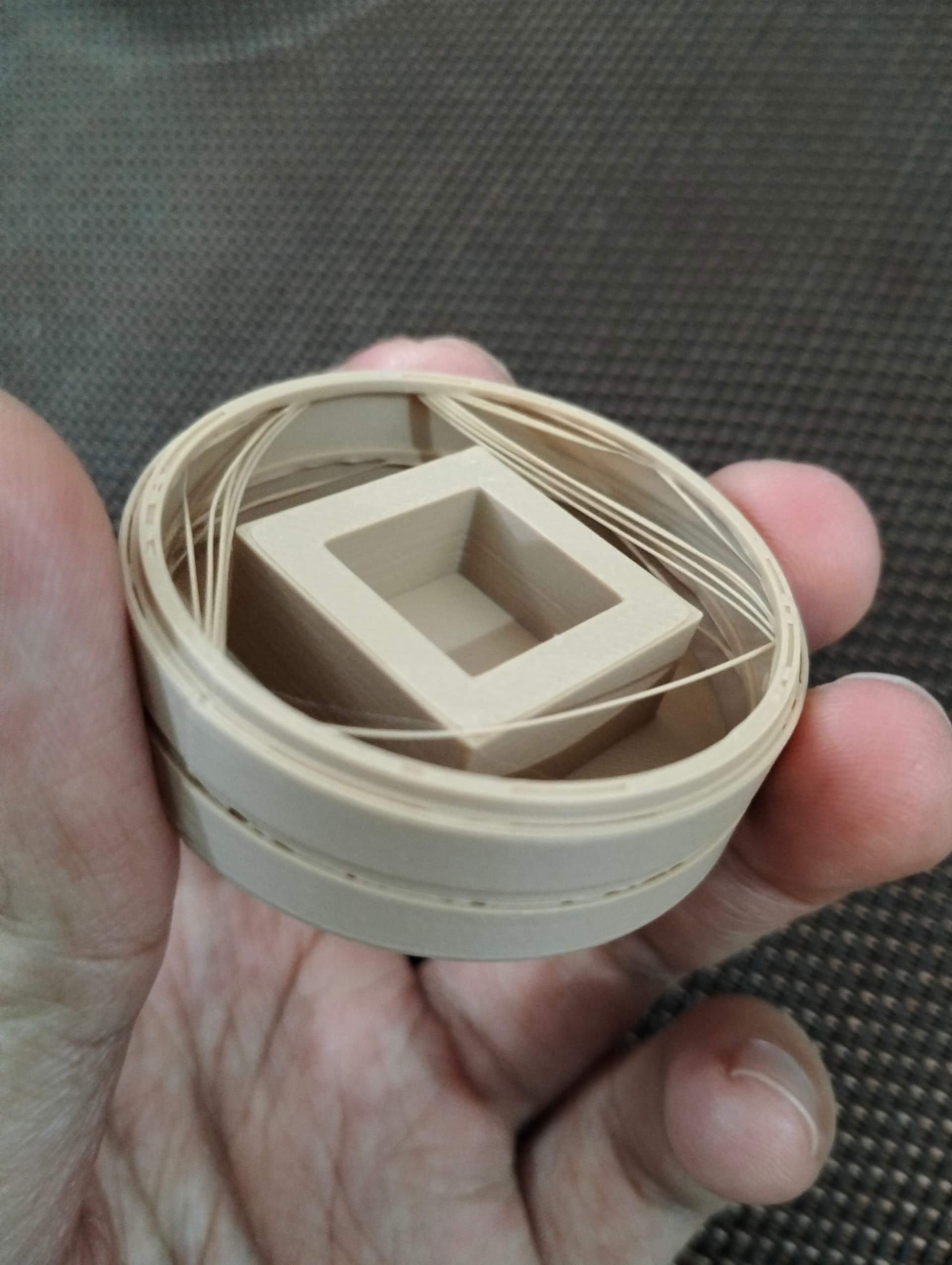

Layer on the top its broken
Hello, I get strange results at the top of the ob
ject always like this, is there any setting I should set to print a model like this?
It doesn’t actually look like the top layer I think it’s the bridge a few layers down because of the ridge. You could try enabling thick bridges under the quality tab and under the speed tab maybe try dropping the bridge speed to 20 mm/s.
If it’s your own design and you don’t really need the sharp edge at the bottom you could also make the slope more gradual from the inner wall to the that area. In general I think it’s a bridge problem so if you do a bit of searching on improving bridges it should help, but it’s best to avoid them if it’s possible for the design.
What layer height are you printing at? Lower layer heights help with anchoring overhang areas on curves.
