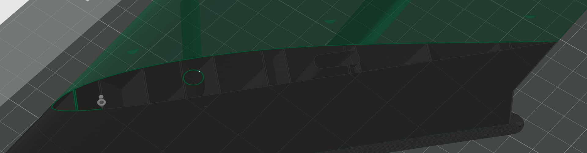

When printing a wing for an airplane, ia setting within bambu studio would be needed to set the direction of toolpath within the layers. In the case (shown at the pic) it is a left wing. The seem is set to occur at the back, now the upper airfoil section is printed first and the lower airfoil section including this spares is done afterwards. Lets call this “counter clock wise” direction.
If the right wing(mirrored part) is printed, the location of the upper and lower airfoil section is mirrored, but the tool path is generated in the sam e direction, that means the lower airfoil section with the sparse) is printed first and then the upper airfoil. As a consequence the sparse are visible at the upper airfoil section as they are printed first. I need a setting do control the print direction. In that specific case I would set from counter clock wise to clock wise.

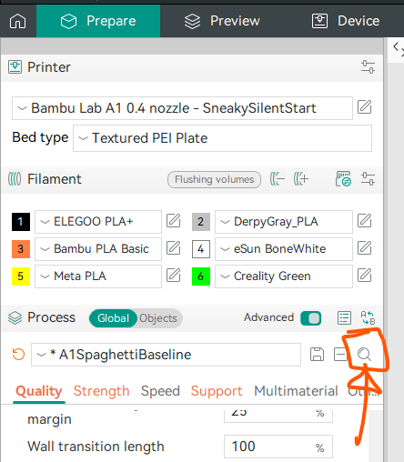

Also, since you seem like you knew enough terms to describe your problem, you should know this fun trick in the slicer:
Click this search button
Type in stuff
It’ll match on the various capabilities

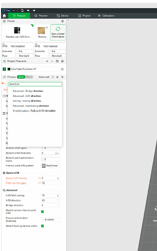

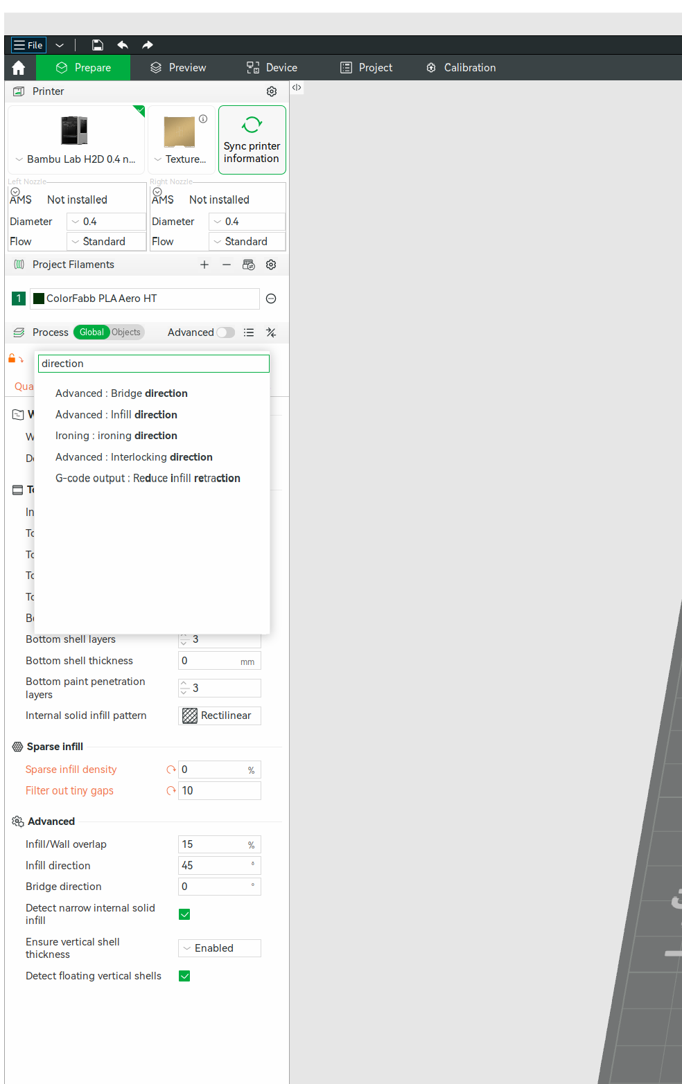

Thank you very much, I really did not use the search for this issue, but if I do so there is no Wall loop direction, why is this?
best regards.
That setting is not available in Studio.
Try OrcaSlicer.
…I come from Orca, but I own a H2D and afaik there is no orca templete for this machine, so I have to live with Bambu Studio.
@Bambulab Team: please make the advance settings available for multi extruder printers or make this “wall loop direction”-setting availlable for H2D-users anywhere else, at least.
