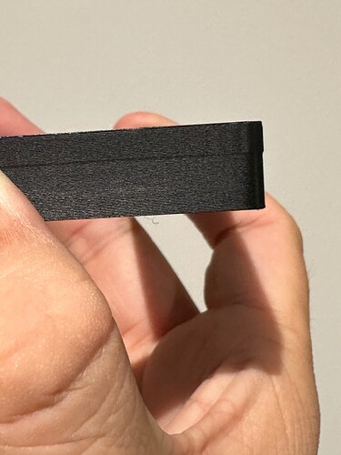

Hello everyone,
I’m experiencing a recurring issue with my 3D printing where there’s a layer shift as soon as the print reaches a specific edge of my model. I’ve attached a picture of the issue to illustrate it better.
As you can see from the image, the layer shift occurs right at the point where this edge starts. The print looks fine up until this point, but as soon as it gets to this edge, there’s a noticeable shift.
Has anyone encountered a similar issue or has suggestions on what might be causing this and how to fix it? Any advice would be greatly appreciated!
Thank you in advance!
Is it just this model or all models?

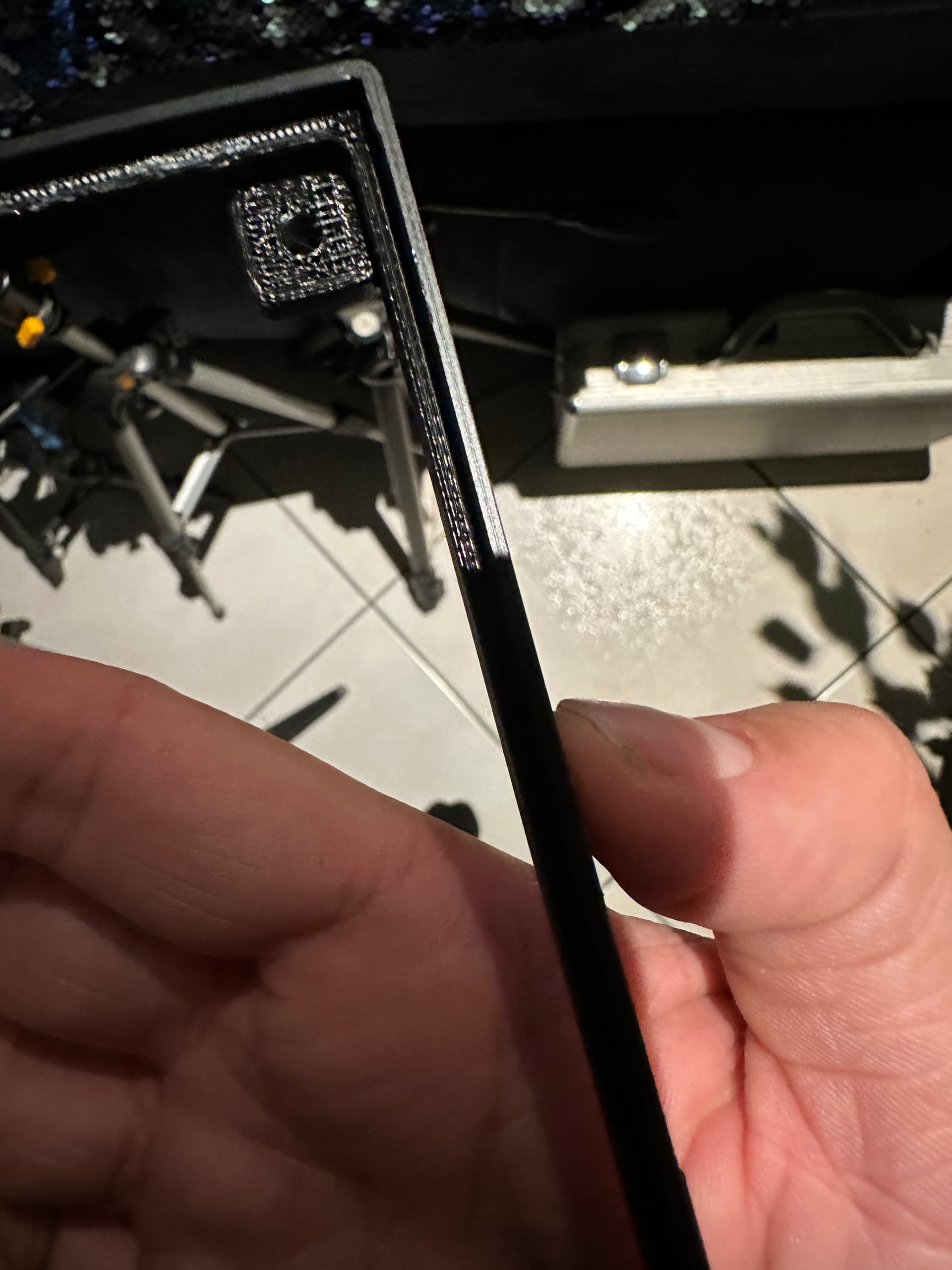

Hi,
I have the same issue here.
With every box I print there is like a layer shifting on the edge where the outer wall starts. I think just for 1 layer. Then everything is fine.
Did you get it to fix ?
Try changing it so outer walls are printed first thats what I had to do to take care of that problem.
