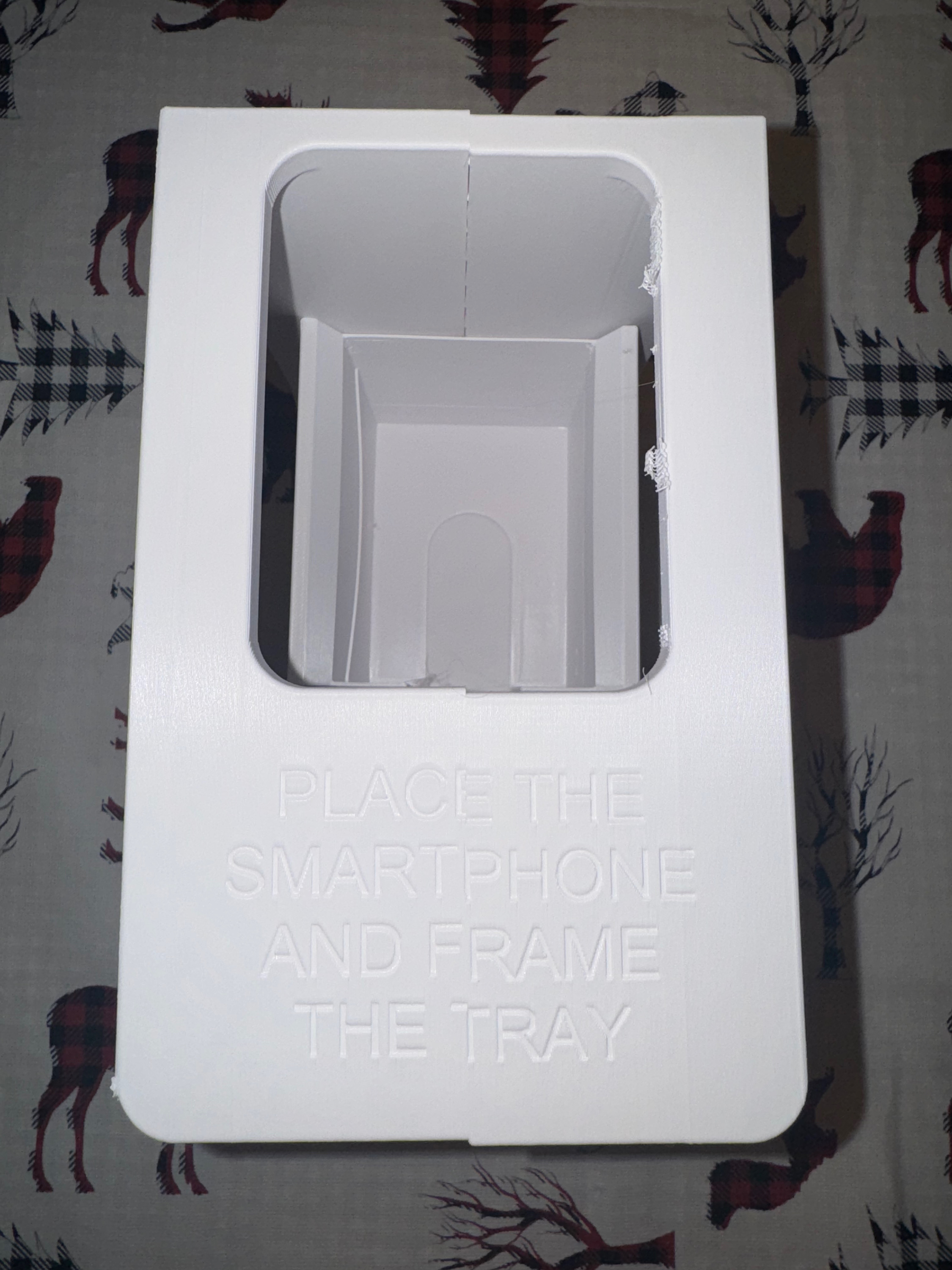

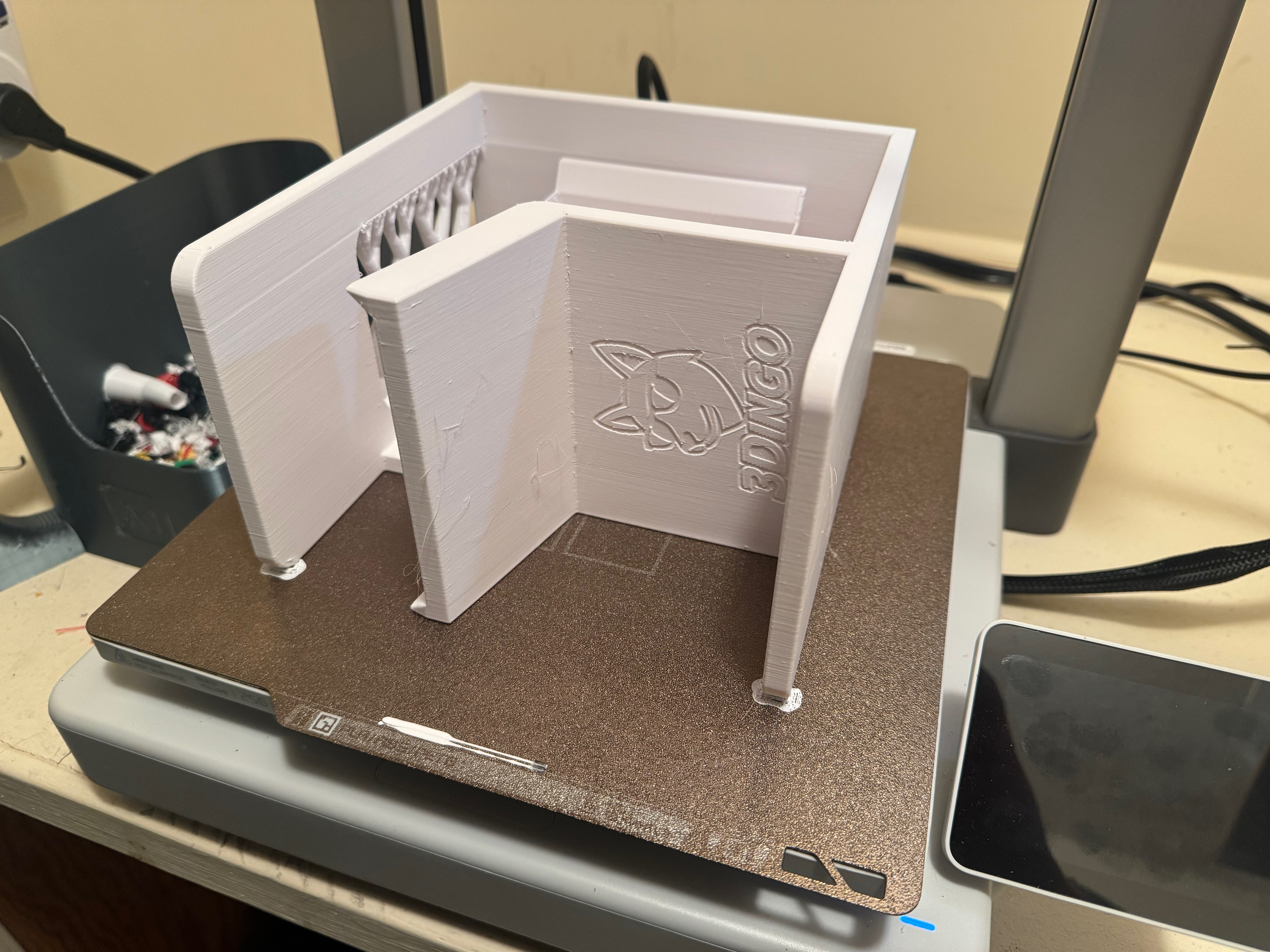

This is my largest print so far and almost exactly half way through I got a substantial layer shift…
The part may still be functional, but I definitely want to know what might have caused this and how I can prevent it from happening again. Can anyone help?

The pic looks like it probably came from an A1.
If you continually get it at the same Z height across many models - clean + regrease your z rods, z belt tension/replace, etc.
If you have a video of the print, look at that layer’s motions and see if the printer collided with the print and/or had an auto recovery incident (filament caught on spool, jerked around, parks, poops, retries automatically a few times). Collisions happen frequently from warping, if you check the flatness of the bottom of your print, is it curled up on any edge?
The pic with the dog logo shows the layer shift on the front 3 vert surfaces. The back surface has it too (mildly occluded but can be seen). How about that surface on the left?
Grid infill also exacerbates collision conditions, in case relevant. Use a noncrossing infill for tall prints.
Do you have a cat? Maybe kid(s)? Just a wild guess here…

It otherwise looks to be a clean print, no warping that I can see.
Yes, the entire print shifted at that height, so it seems like something happened between one layer to the next?
Yes it is grid infill, thanks for that tip!

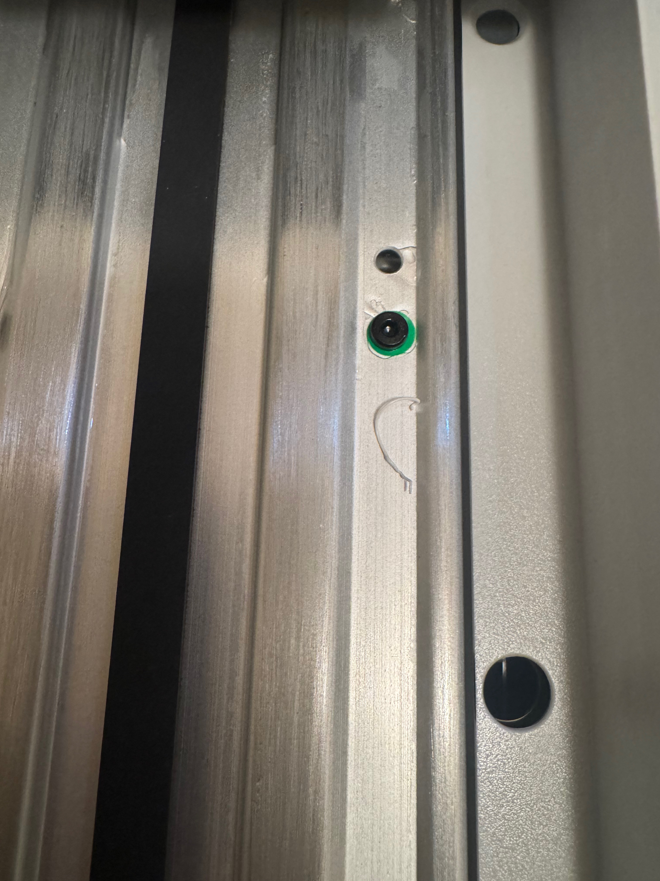

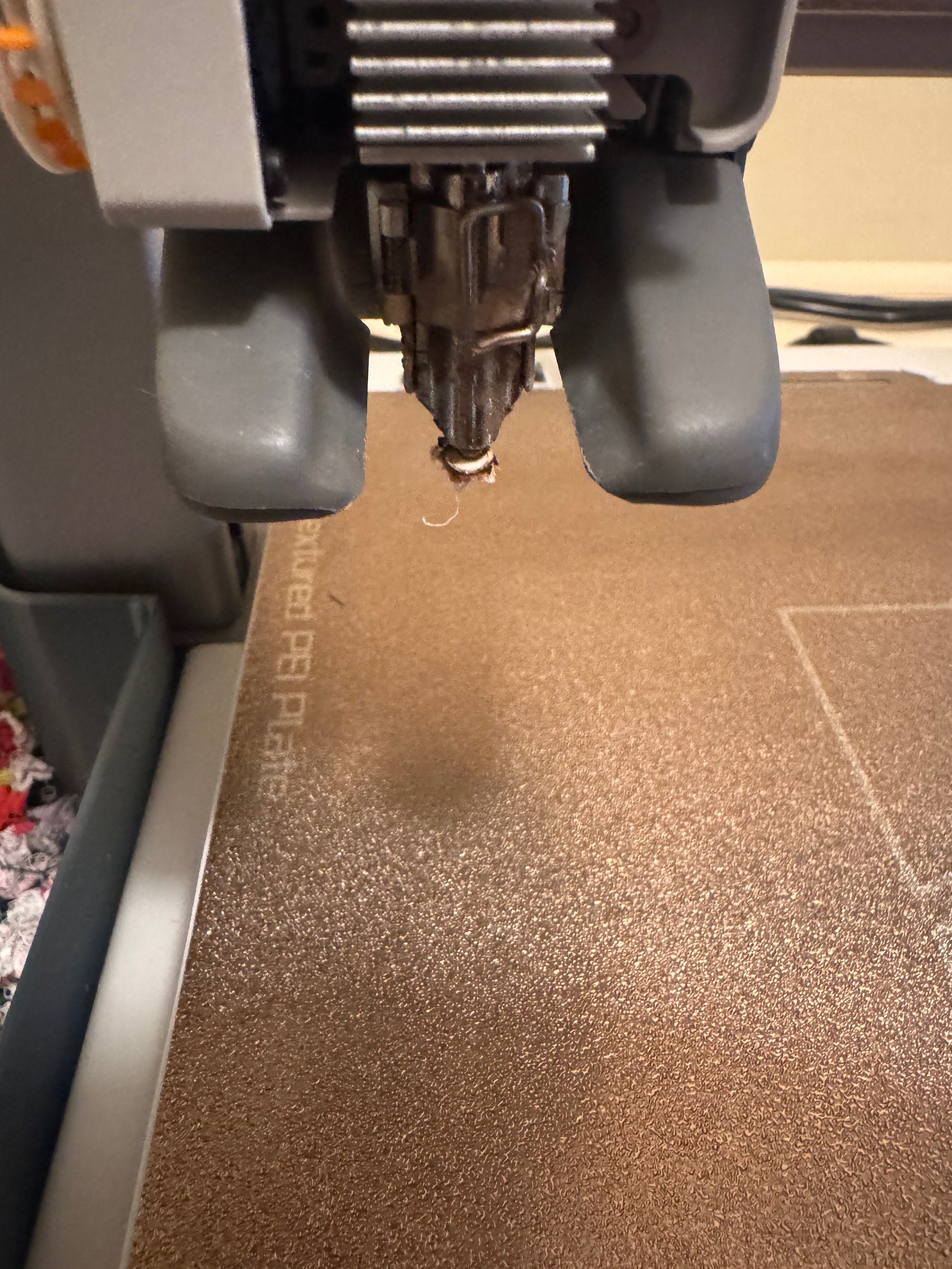

Could this potentially be the culprit, or unlikely?
Wispy bits of filament in the tracks could potentially interfere, but frankly i’ve never seen it happen and I’m guilty of letting that crud accumulate in the Y tray as well, lol.
That nozzle tip is a little gross but if its just plastic thats fine. (heat, brush away) Maybe for giggles do a flow RATE calibration test to make sure you’re not overextruding.
