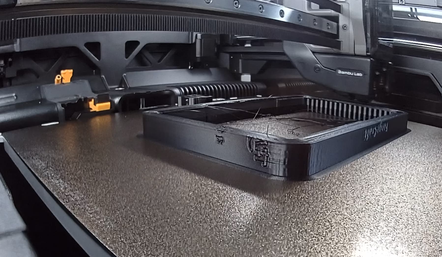

My problem eventually came down to a mismatch of layer heights between my model and my support interface.
Something like:
Layer Height: 2mm
Support Interface Layer Height: 1.6mm
I don’t remember the exact parameter names and numbers right now, but basically I was leaving too large a gap between the interface and the model to succesfully lay down that first overhang layer.

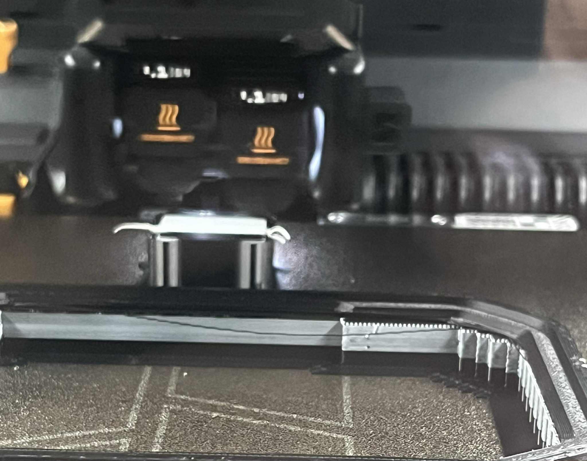

Bit late I know. When using support interface material the Z top and Z bottom distances are best set to zero. I am pretty sure the latest Studio version added a warning suggesting this when you select a different material for support interface.

i believe the problem is the flushing volumes;
i’ve seen on the web that people are setting these to 800 so that the previous filament doesn’t print embedded into the current filament.
Same issue. All of my prints that required supports, they failed at the interface. Even more worryingly, the ai never detected spaghetti or air printing, and continued to print as normal. Im suspecting its something to do with the “independent support setting” and that its “invalid” if prime tower is used. Which to mean it means that it ignores any change to top-z and the interface should be fused to the supported surface. But no, in the photos you can see the area even warping and lifting away and even spaghetti… SMH seriously 2.5 for something my p1 and nep4 tackle like nothing… and nep4 isnt even supposed to be printing ABS…
BBL solve this, PLEASE, i love the printer but this is just breaking it for me…
I tried using PLA as a support interface layer with a PETG for the first time and it looks like the first layer of PETG after the interface layer failed to fuse.
I’m using an H2D so separate nozzles for each filament. My support settings were:
Type: tree (auto)
Style: Default
Threshold angle: 30
On build plate only enabled
Support base: PETG
Support interface: PLA
Top Z distance: 0mm
Bottom Z distance: 0mm
Base pattern: Rectilinear grid
Base pattern spacing: 2.5mm
Pattern angle: 0
Top interface layers: 3 layers
Interface pattern: Rectilinear Interlaced
Top interface spacing: 0mm
Independent support later height enabled, but prime tower also enabled
Purge into objects’ support disabled
Any suggestions on where I went wrong would be greatly appreciated.
