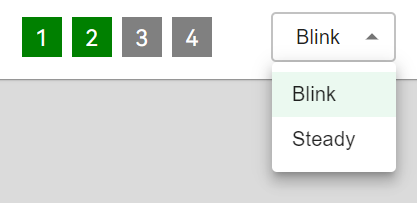

Is there a code snippet which can be utilized within the cyber brick ecosystem which will adjust the brightness of the included LED pixels?
Currently there are only two choices within the applications each LED. “Steady” and “Blink”. But not a selection for changing brightness.
