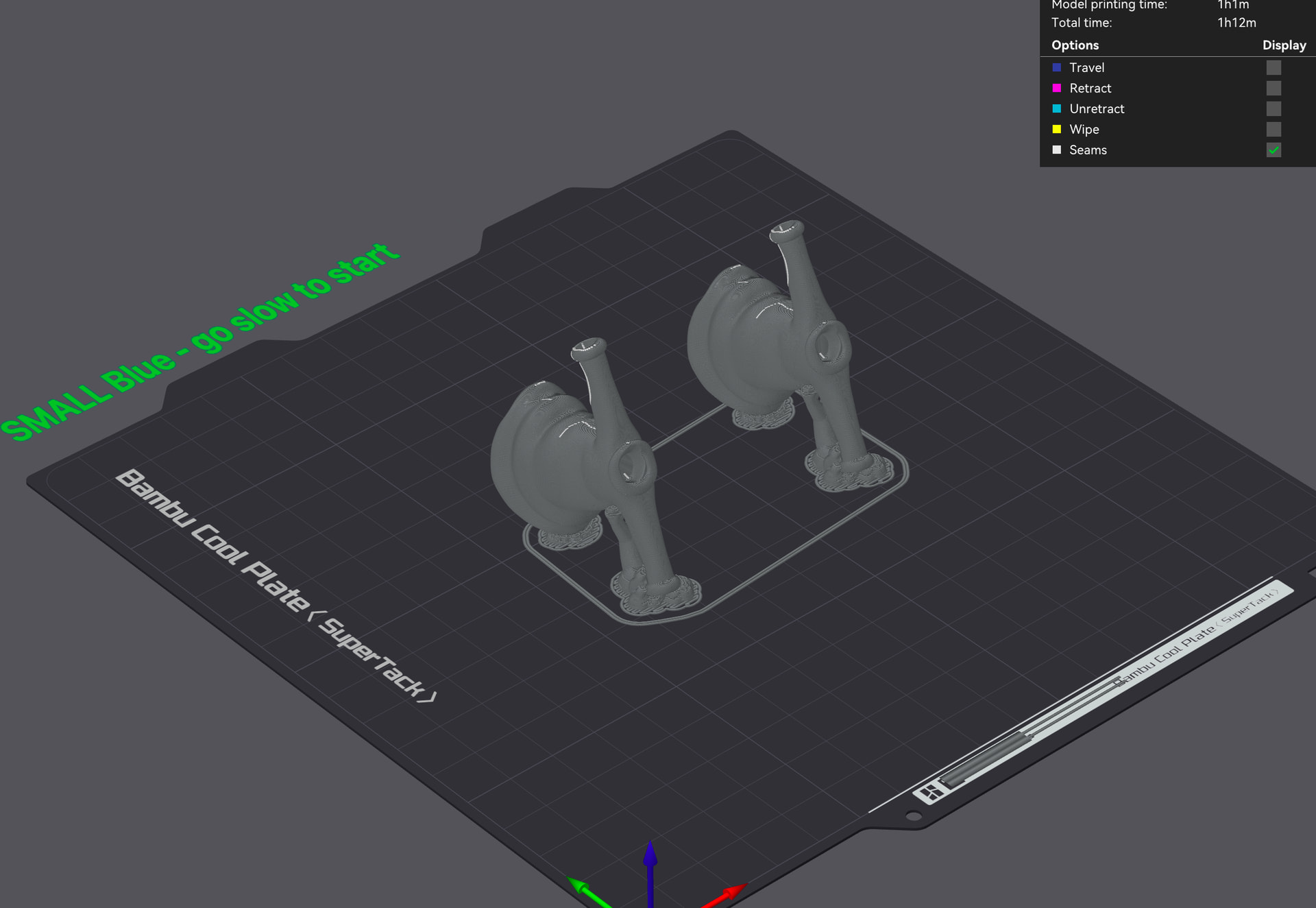

Im printing 2 identical models on the same plate, and the left most one keeps failing half way through! ive tried 4 times now and even moved their position on the plate - but the left one keeps failing.
am I going mad?! Is this just chance or could there be another reason for this? As always there are obviously lots of variables at play, but I was wondering if there was anything inherent in anything that would make something on the left more prone to failing?!

Sorry, ive been really vague. I should probably have done more investigation before posting really - and taken a photo of the issue.
By failing I mean, id just come back to the print and the left object would be a mess of filament half way up.
I used to be able to print 2 just fine. Ive got a feeling it might be something to the humid/hot weather (im trying to try the PLA currently). Im just surprised how its just the left one that would fail and not the right.
Im printing one on its own now and it’s workin just fine. Ill dry the filament a bit longer and see if anything improves

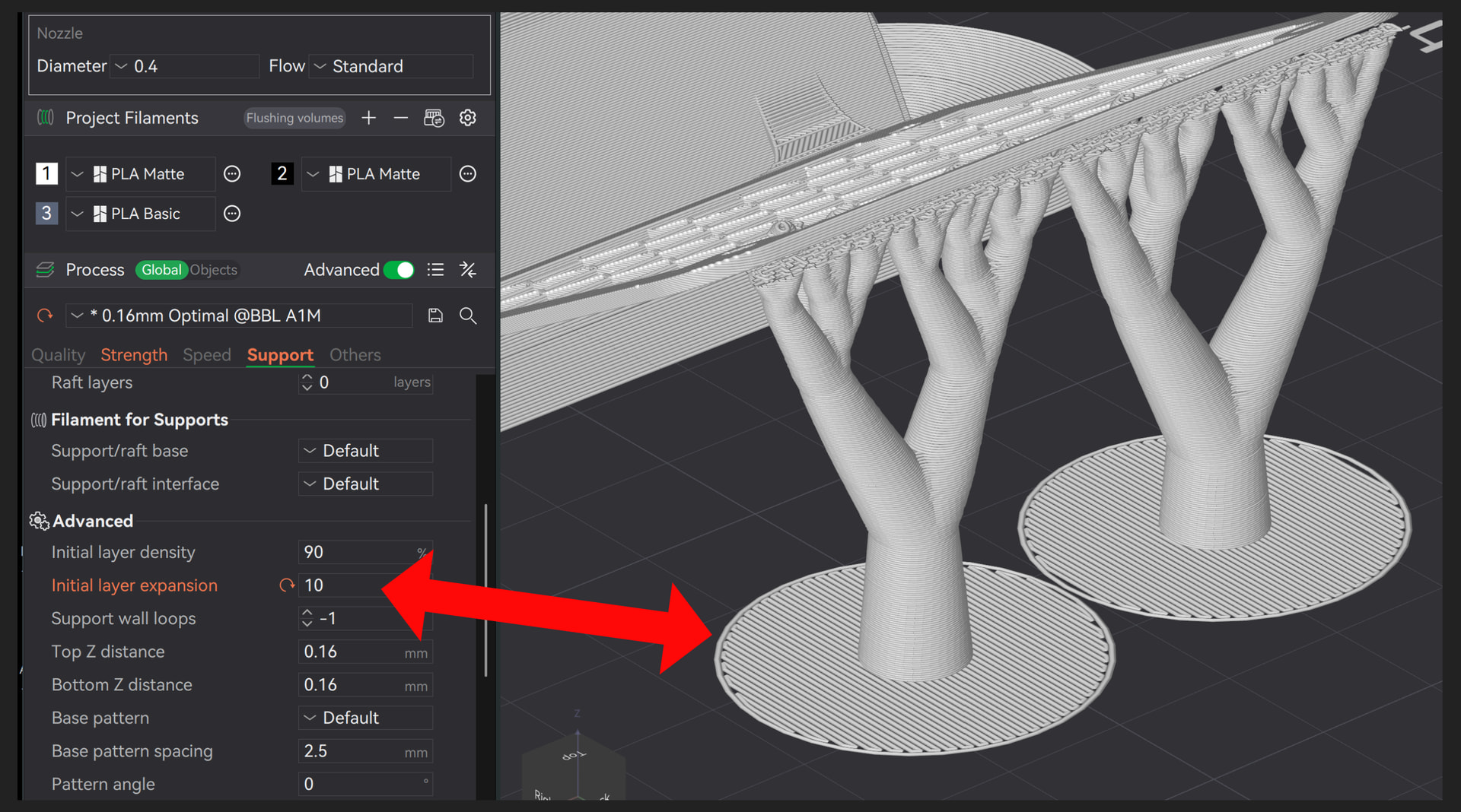

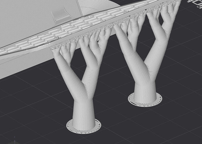

So, without getting too deep into troubleshooting right now, I can already tell you that your inital layer of support is too small and the object is practically asking to fail. Keep in mind: The taller the object is, the less stable the whole structure becomes. More support wouldn’t hurt, but it’s not a must.

Why does this always happen on one side? Because the nozzle is probably moving from one object to another and either hits it - or stringing - and then the object fails. So either your filament is stringing, your infill is hitting the object hard, or you need to optimize settings like the inital layer of support and speed.
