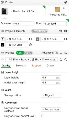

It appears that you can’t set PPA-CF as an external spool in the printer firmware menu, but thanks to Neijlt above, I was able to set it in Bambu Studio. However, I’m having another issue that I can’t figure out. As shown in the pictures below, the device menu shows that the external spool, which is PPA-CF has been loaded. But I don’t see it in the Project Filaments, and when I try to print, it shows that PLA is selected, and when I click the dropdown to select the external spool, a message pops up that mentions that the filament type (PPA-CF) does not match with the filament type (PLA) in the slicing file. It then says to install PPA-CF instead of PLA and change the slot information in the Device page.
Any idea what I may be doing wrong?
Print
I was able to figure it out, thank you. The filament selection was listed under the AMS types, which it’s not, but selecting it anyway allowed me to use that type in the slicer. There seems to be several issues in either dealing with external spools, and/or PPA-CF.
