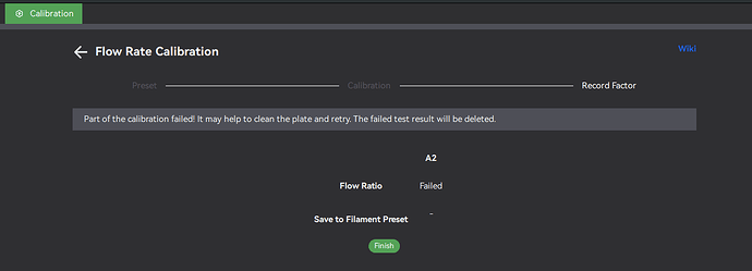

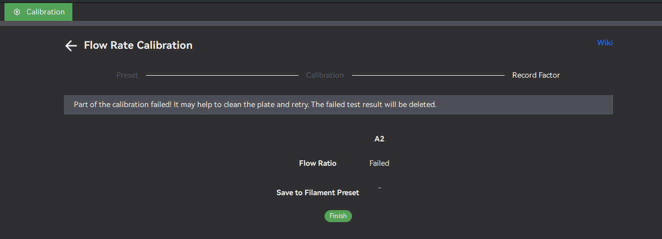

Just tried with the new update to Studio (v2.1.0.59) after going back to FW 1.09 again. It actually runs the calibration now - properly loading the correct filament and printing test swatches - but it fails every single time to actually read the results.
I give up. This just isn’t going to work without a new firmware update it seems.

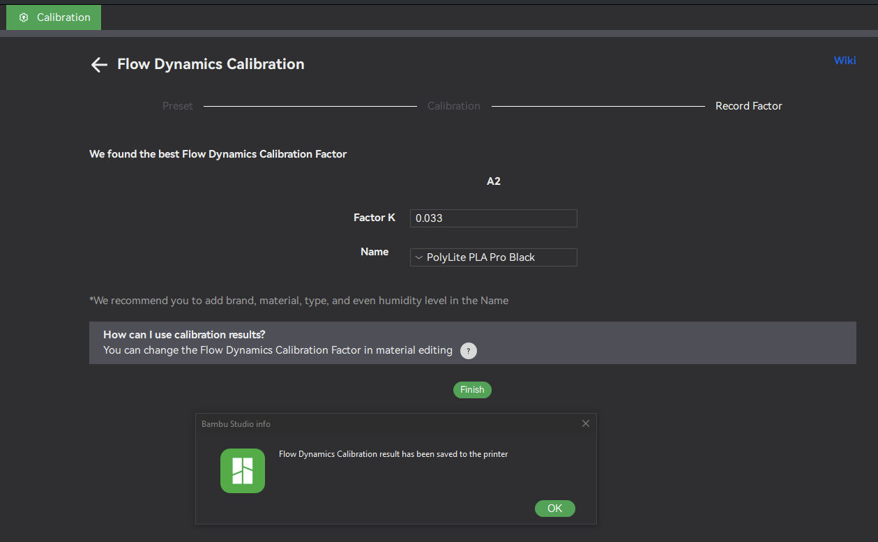

BUT! PA tests worked!?
So it looks like only flow ratio tests don’t work now. :crazy_face:

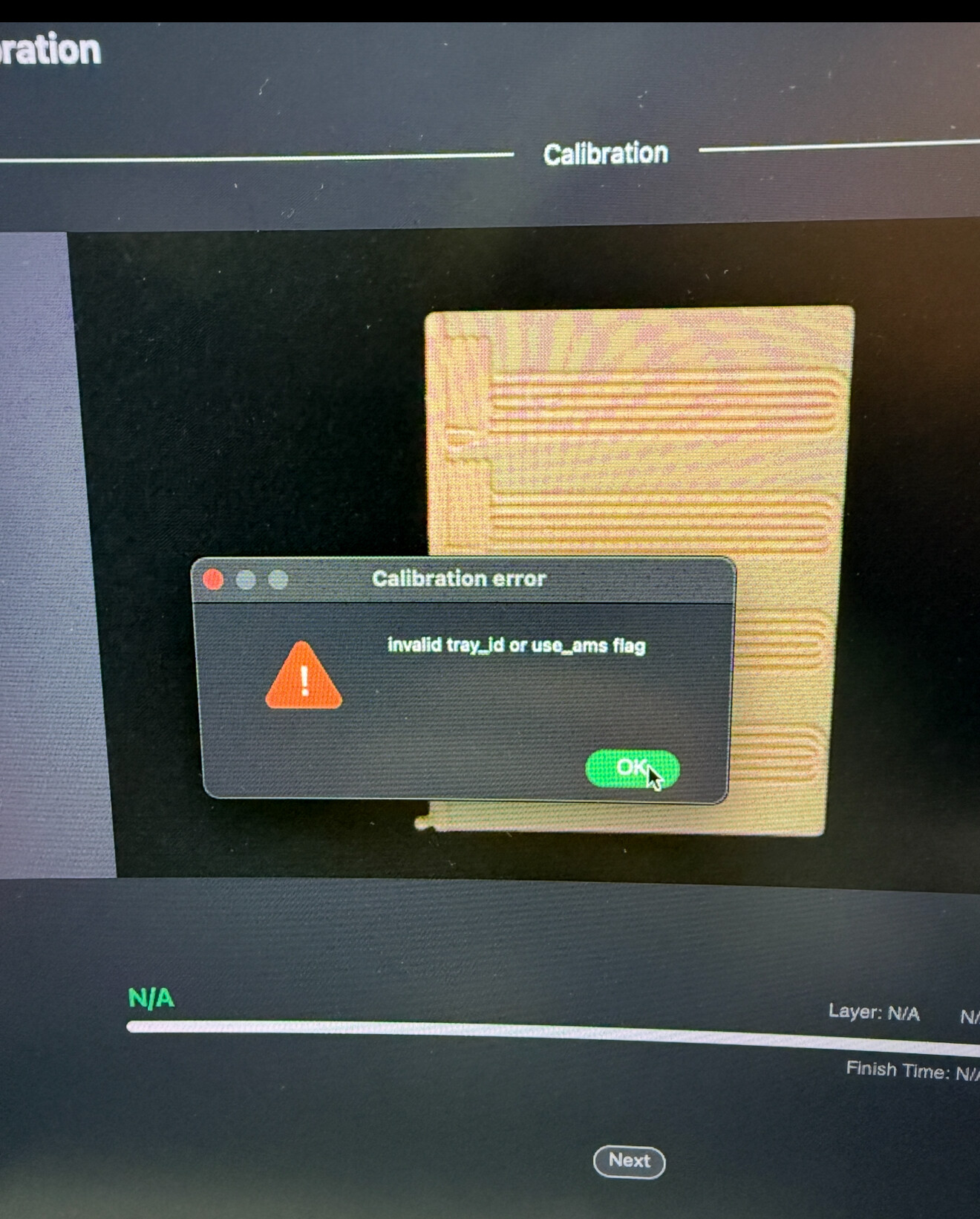

Updated to 01.09.01.00 on both of my X1-C’s. One of them works perfectly. Can run both auto calibration tests no problem. The other one just gets this error and won’t even start the test.
Edit: seems to only be an issue with the AMS-HT. Normal AMS works fine.
