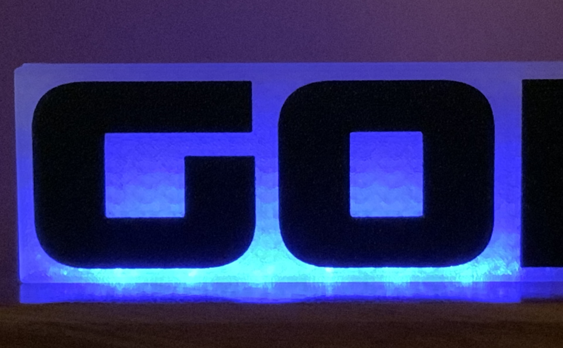

best is to add a diffusion layer of 0.4mm
tried flow 1.03 it was too much, had some graining. now trying it at 1 and adjusted the overlap to 45% let’s see.
ALWAYS add the diffuser. It provides a single layer (I usually choose white, but have used fluorescent) which basically holds everything together and makes things much more robust.
Everything else I use is default.
I design, make and sell lightboxes and since using the diffuser layer I have never had a box returned for being damaged.
so you are using default settings? with default the from layer details are getting torn apart.
what thinness of the diffusion layer are you using?
and thiknness of the front layer?
I’m betting Wayne uses the same settings I do - 0.2mm layer height with the front/design 0.6mm thick (3 layers) and a 0.4mm thick diffuser (2 layers).
That seems to be a sweet spot for good colors when illuminated and good strength in the design and from the diffuser holding everything together.

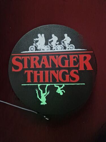

You can also change the diffusion color to get additional colors! Found that out the hard way by not having white as one of my 4 color options so it printed as the lightest color I had in (yellow) So now on my Blueridge Mountains lightbox, the blue river turns green when I turn the light on. :man_facepalming:

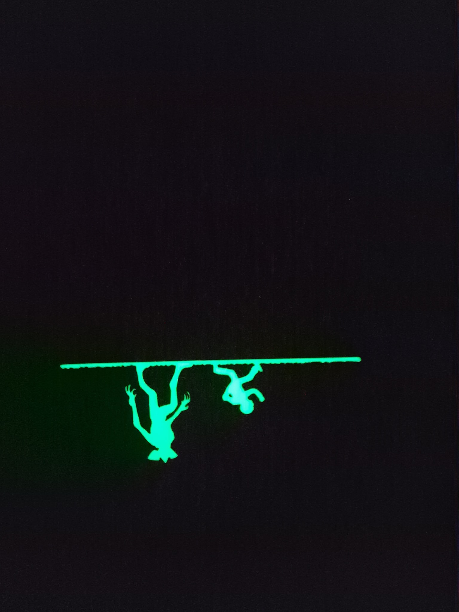

There’s some other cool things you can do too but it moves the creation process into other tools. You can add extra “colors” with thickness too like lithophanes. And with UV-reactive filaments. Only thing in UV stuff it may make it where you can’t use a diffuser. We need a UV-transparent filament for that but don’t know if there is such a thing.
