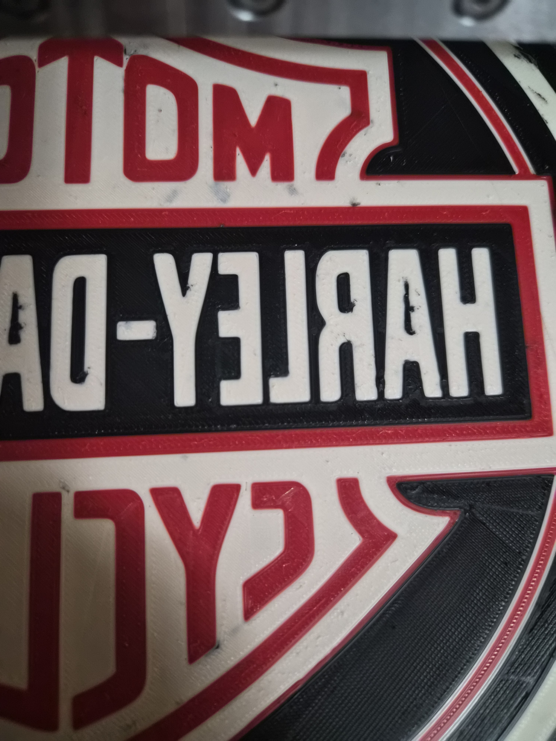

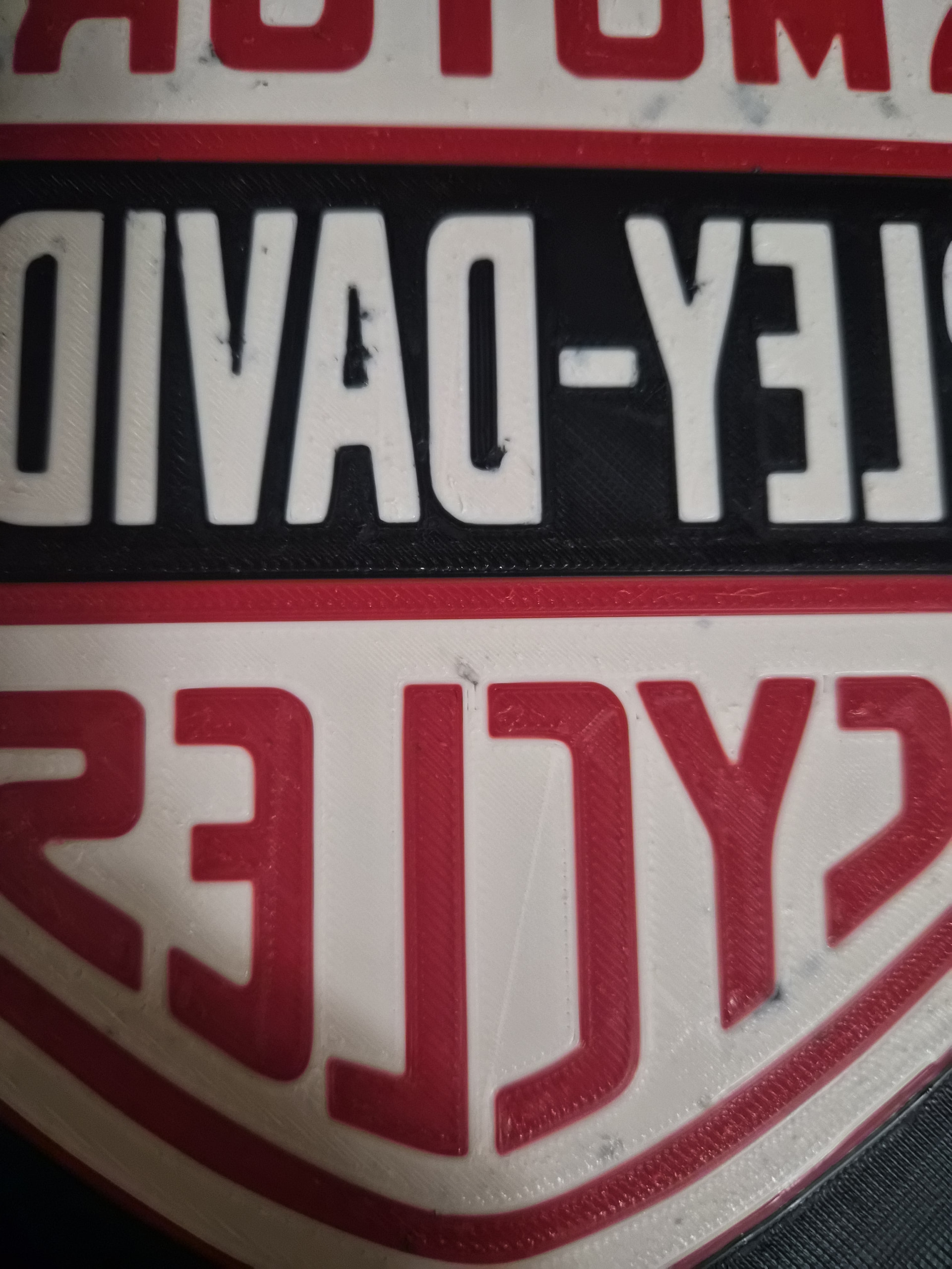

I’m new to this. I’m on an A2L and trying to print a light globe. It looks great till you shine light through it then you see sloppy lines and random chunks of filament.
How are you managing the moisture level of your filament? Moist filament often causes stringing which is the artifacts that you are seeing inside your print.
