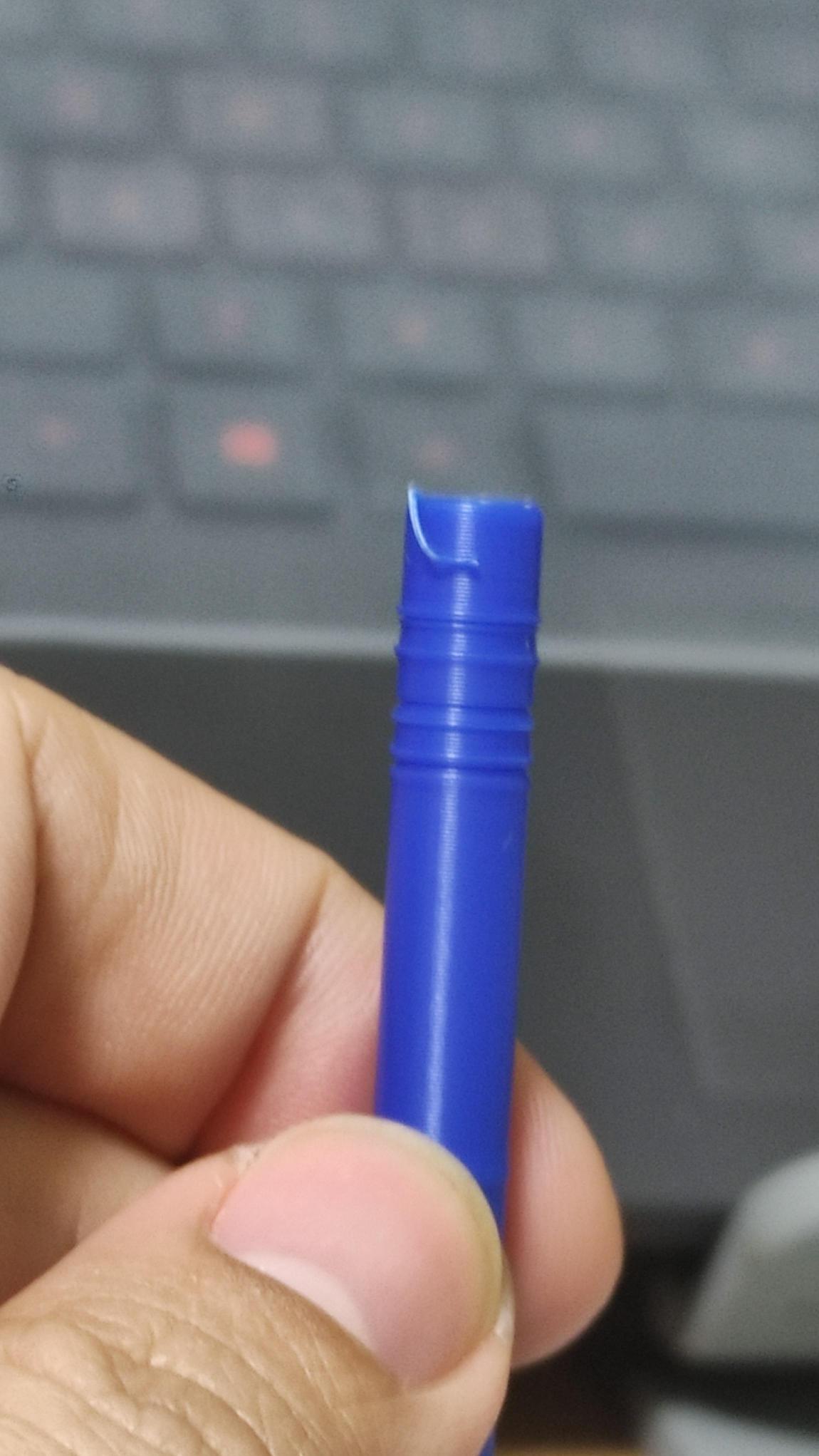

I am encountering this issue also. I already replaced the hotend, PTFE tubes, lubed all rails and rod, calibrate multiple times, use a better roller for filament spool.
Left thing to do is to disassemble the z axis, clean and re-lube the rod, and tightened the coupler.
I think there is a z hop since the filament are squished at some areas, especially at the mid print for basic objects like tube or tall bar.
New account, cant embed media :frowning:
Sample prints above. Losing hope for this printer. I am not new in this hobby as I started in Ender3 years back. I have 350+ print hours on my A1 mini.
What I did so far:
  1. Cleaned and lubed all axis rails/rod
  2. Tightened belts and Z motor coupler
  3. Replaced hotend
  4. Replaced PTFE Tube
  5. Use better filament roller
  6. Recalibrate multiple times
  7. Using new dry filaments(Elegoo, CC3)
Maybe the Z motor is failing?
