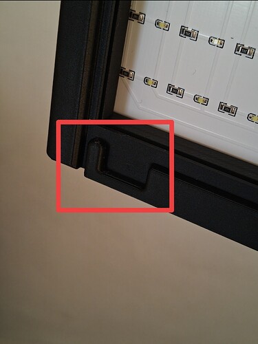

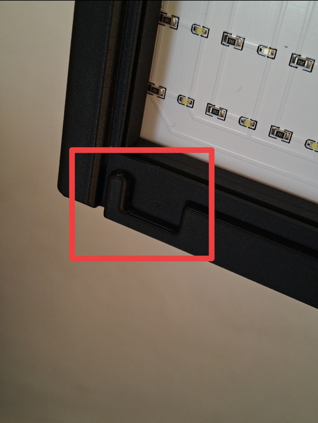

I finished printing the lithophane frame from the “Make a lithophane” maker but don’t understand what these tabs are supposed to be for?
Any ideas?

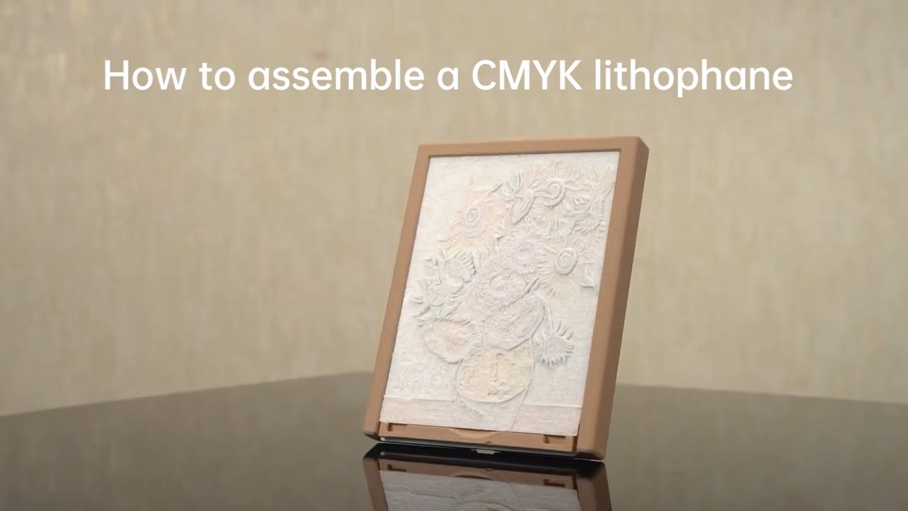

From the YouTube video, it appears to do nothing.

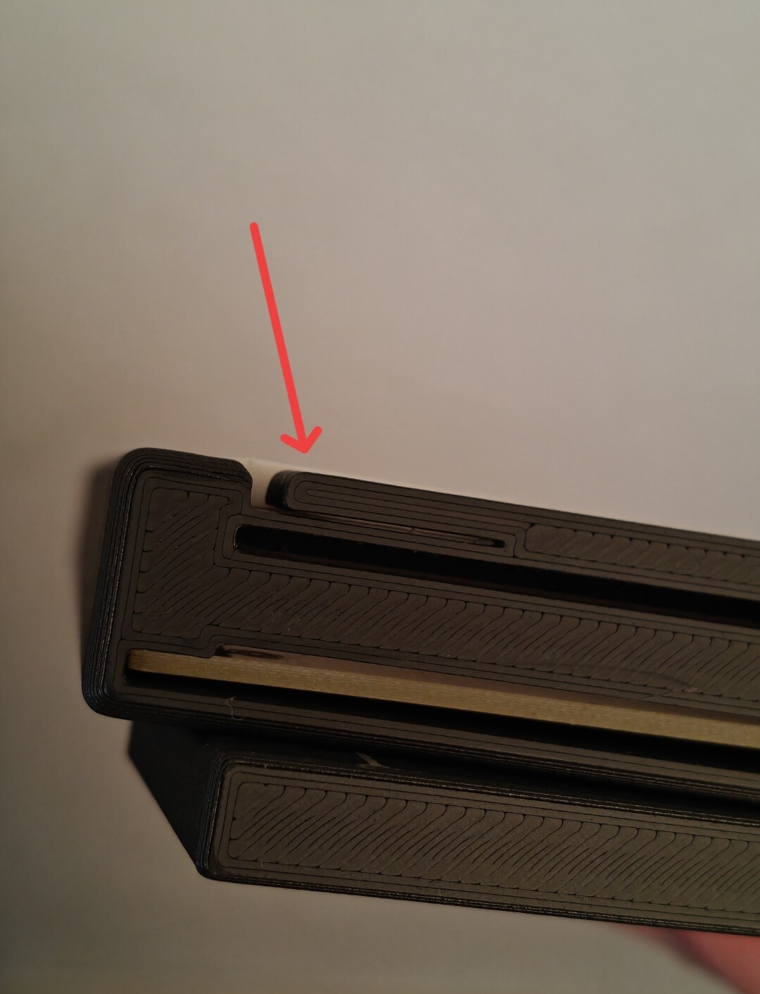

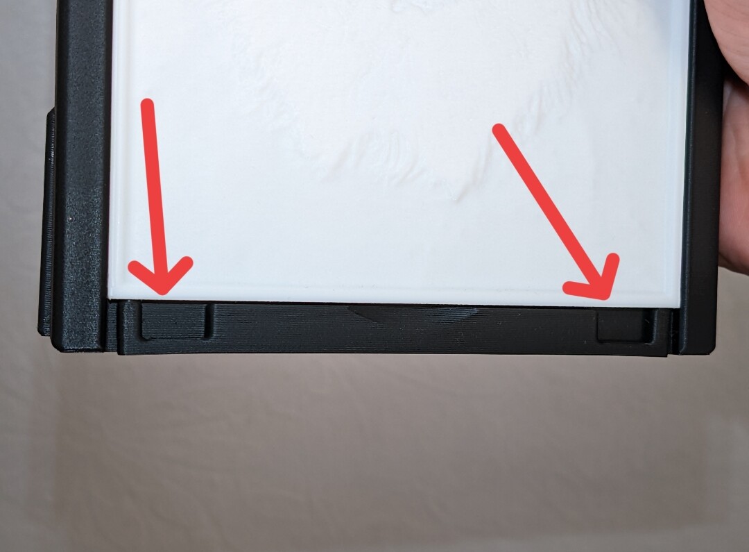

Actually, i found out what they are: “Springs/Tensioner”. The pegs sit slightly higher than the rest of the frame in that area. If you insert the lithophane you slightly push them down making the fit tighter. I just ripped them off to test something and now the lithophane just falls out of the frame if you tilt it.
