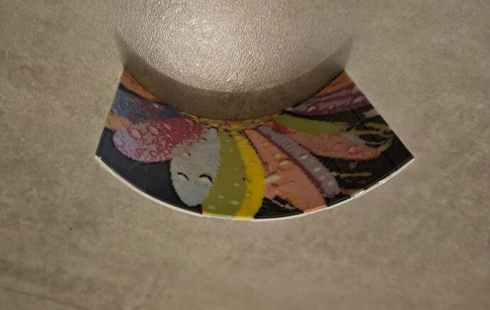

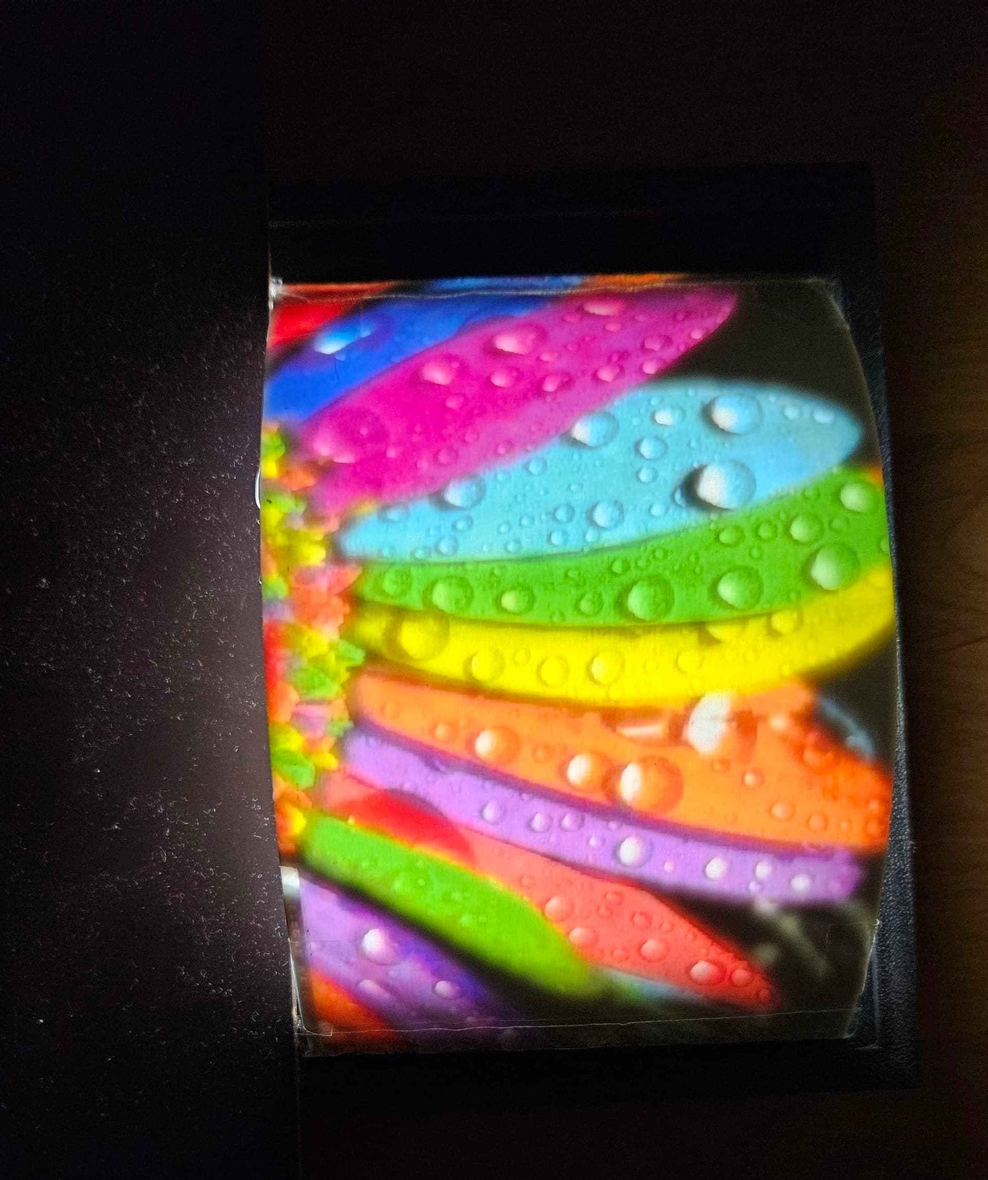

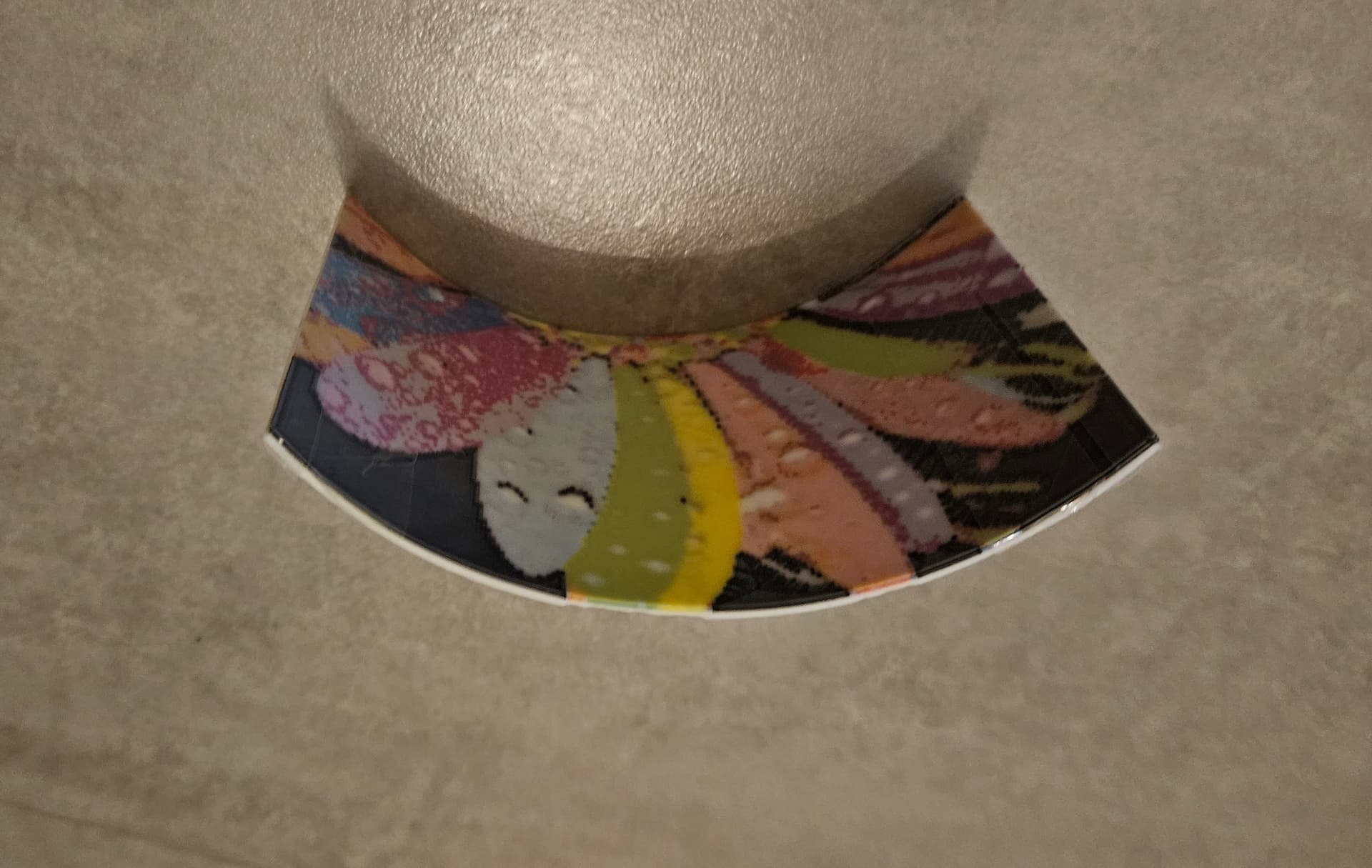

Hello,
I used 2 filaments for the skin color: beige and latte brown.
What is the -C curve parameter used for?
Hi,
Sorry for the late response.
The -C mode is for creating curved lithophanes.
I tried it out to see if it was possible to make curved lithophanes in color.
The textured part is printed upright, and the colored part is printed flat in two passes (to maintain flexibility).
I made a prototype but quickly gave up and didn’t pursue it further.
My conclusion is that it’s better to do it through thermoforming…

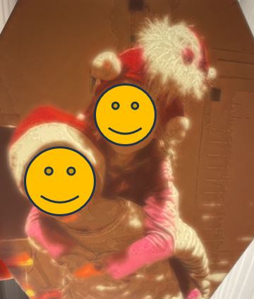

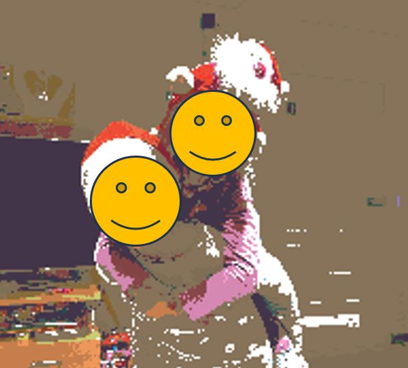

But I have some kind of problems with the darkness of my images. If I generate the lithophane most of them ends in a very dark result. I need a very strong light source that the colors are visible and sometimes all looks like it would be covered with brown mud ![]()
Here some example pictures
Original Image:
Color Preview:
Result with strong light:
Important to know, I just use the 4 Basic colours CMY+White and a 0,4mm Nozzle.
Do anybody have some hints, what a photo needs that the result have more brightness? Or is there option in PIXEstL to generate more shining results?
And a second question is with the " -M" parameter. With the default all result prints have a maximum thickness of 2.63 mm. If I change the setup to “-M 2.8” the results have a maximum thickness of 3.6 mm. That confuses me. Can someone explain that parameter to me?

Hello @martin.fischer.sbw,
There are several complications in your case:
- The first and main problem is that it’s very difficult to produce light colors with CMY filaments.
- The second problem is that your image contains “skin” color. This color is very difficult to achieve.
- The third problem is that you have black in the image (the TV). So a mix of dark and light colors.
Regarding CMY filaments, they are great for producing bright colors, with saturated colors, but very limited when it comes to getting pastel and/or pale colors. At this level, lightening the image doesn’t really have an influence.
To make lithophanies of clear images, it’s preferable to use light filaments. At BambuLab, you have Sakura Pink and Ice Blue which work very well. (I also need to test their new “desert tan” which seems promising as well). With these filaments, you could emulate light colors, but not vibrant colors and even less so black.
The ideal is to move to more than 4 colors, so you’re no longer constrained to using only light filaments, and you’re no longer constrained to using only vibrant filaments. If you also add a skin filament (BambuLab’s beige filament is perfect) and a black filament (for deep blacks), you’ll be able to print almost any image.
I personally use the following filaments:
- IceBlue : PLA Matte Filament avec bobine / 1 kg / Bleu glacier mat (11601)
- Sakura Pink : PLA Matte Filament avec bobine / 1 kg / Rose Sakura mat (11201)
- Beige : PLA Basic Filament avec bobine / 1kg / Beige (10201) | Bambu Lab EU
- Cyan : PLA Basic Filament avec bobine / 1kg / Cyan (10603) | Bambu Lab EU
- Magenta : PLA Basic Filament avec bobine / 1kg / Magenta (10202)
- Yellow : PLA Basic Filament avec bobine / 1kg / Jaune (10400) | Bambu Lab EU
- Black : PLA Matte Recharge / 1 kg / Brun latte mat (11800) | Bambu Lab EU
Now, if you have no choice but to stick to 4 colors, here are some tips:
- Choose images either with bright colors or with light colors, but not both at the same time; and adjust the filaments accordingly.
- Try the 7-color mode with 1 AMS that I developed. It’s not perfect but it can help.
- Try reducing the layer size to 0.07mm to “lighten” the CMY filaments a bit (see this thread: Thought you might be interested · Issue #4 · gaugo87/PIXEstL · GitHub or this thread : First Go Round, and some questions. · Issue #6 · gaugo87/PIXEstL · GitHub ).
The parameter -M solely determines the maximum thickness of the texture layer, not of the entire lithophane.

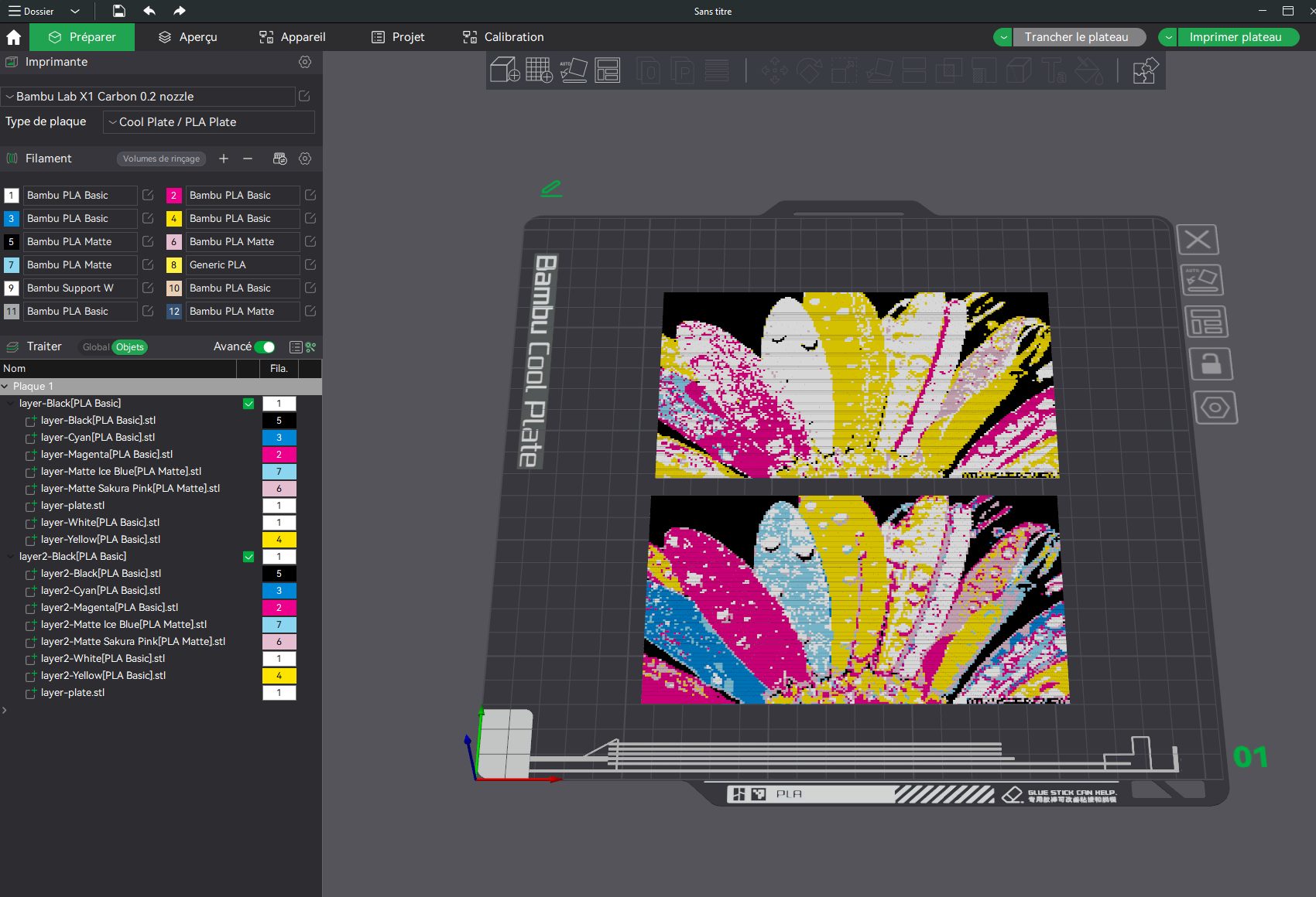

Hello! I wanted to try to the 7 colors with 1 AMS method too, but in 2 tries I got the wrong colors. Like in the Pictures belowPrintedCookie
I get pretty good results using Lithophanemaker. com and using the “Printed Solid CYMK” color pallete instead of the suggested default eSUN one as recommended by Bambu
Hello @PrintedCookie,
For some time now, Bambu Studio has added an option to add the possibility to force the sequence order of filaments at a given layer (in addition to the first layer). So it is no longer necessary for PIXEstL to add a white layer for color changes to occur. This white layer had a significant negative impact on the final result because it diluted the color and prevented all the color layers from bonding together.
Could you try one last time with the new version and the new procedure ?
