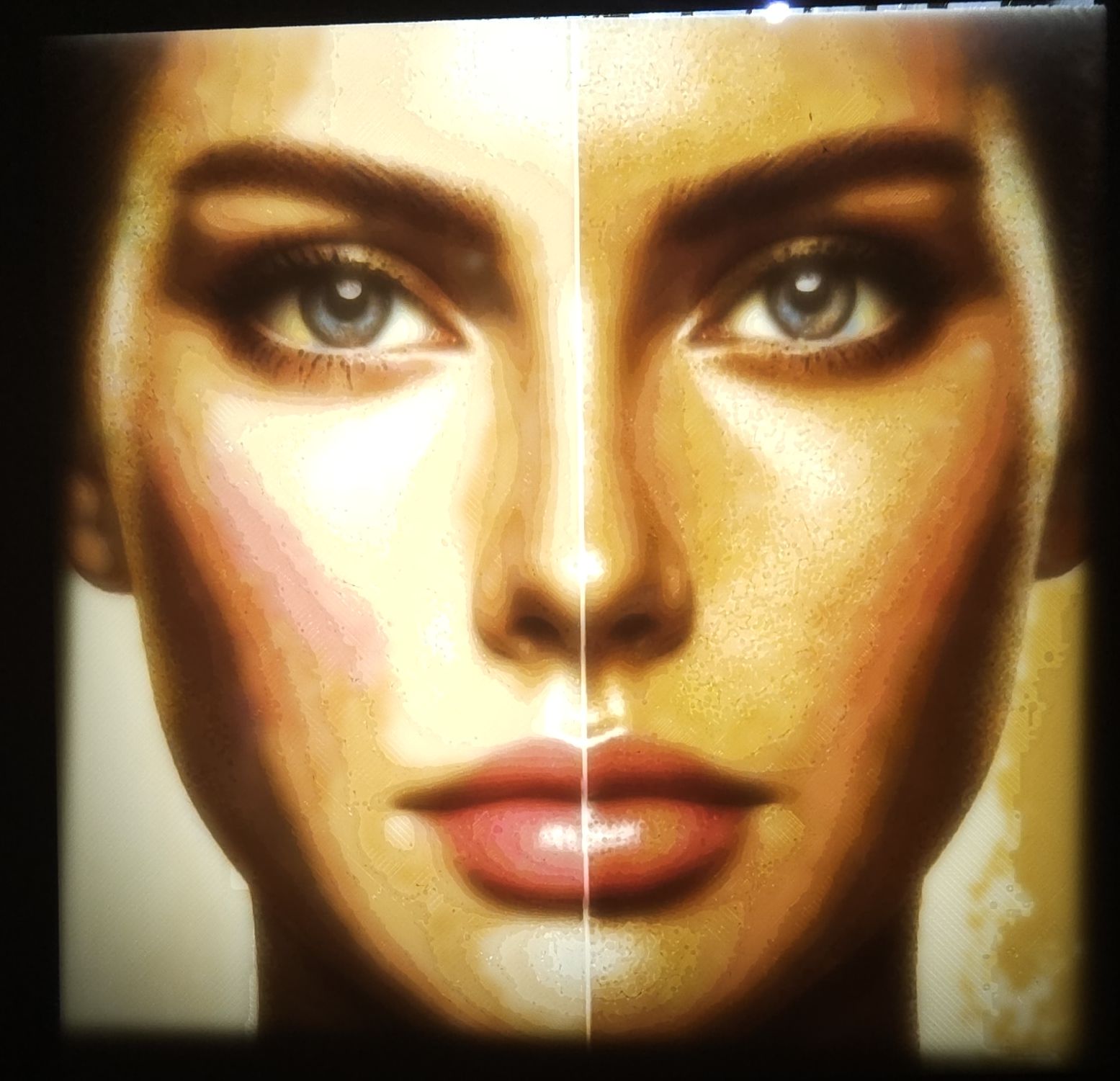

The best example is this litho rendering.
You can see that the right side is much more successful than the left side. The use of pink (in this case, sakura pink) often looks off and produces an unnatural result. I think it’s because there’s a no man’s land in tone between beige and pink. I believe finding a filament with a very light pink would make it work better.
Finally, note that you don’t necessarily need two AMS units to add colors. Both lithos you see were made with just one AMS (4mn nozzle with 0.1mm layers). They were done in 7-color mode with one AMS.
I used this combination for the layers:
Layer[0.0]: Cyan[PLA Basic], Magenta[PLA Basic], Matte Latte Brown[PLA Matte], White[PLA Basic]
Layer[0.7]: Cyan[PLA Basic] --> Beige[PLA Basic], Magenta[PLA Basic] --> Matte Sakura Pink[PLA Matte], Matte Latte Brown[PLA Matte] --> Matte Desert Tan [PLA Matte]
Since I adjusted the algorithm, the result in this mode has become very close to a print using two AMS units.
