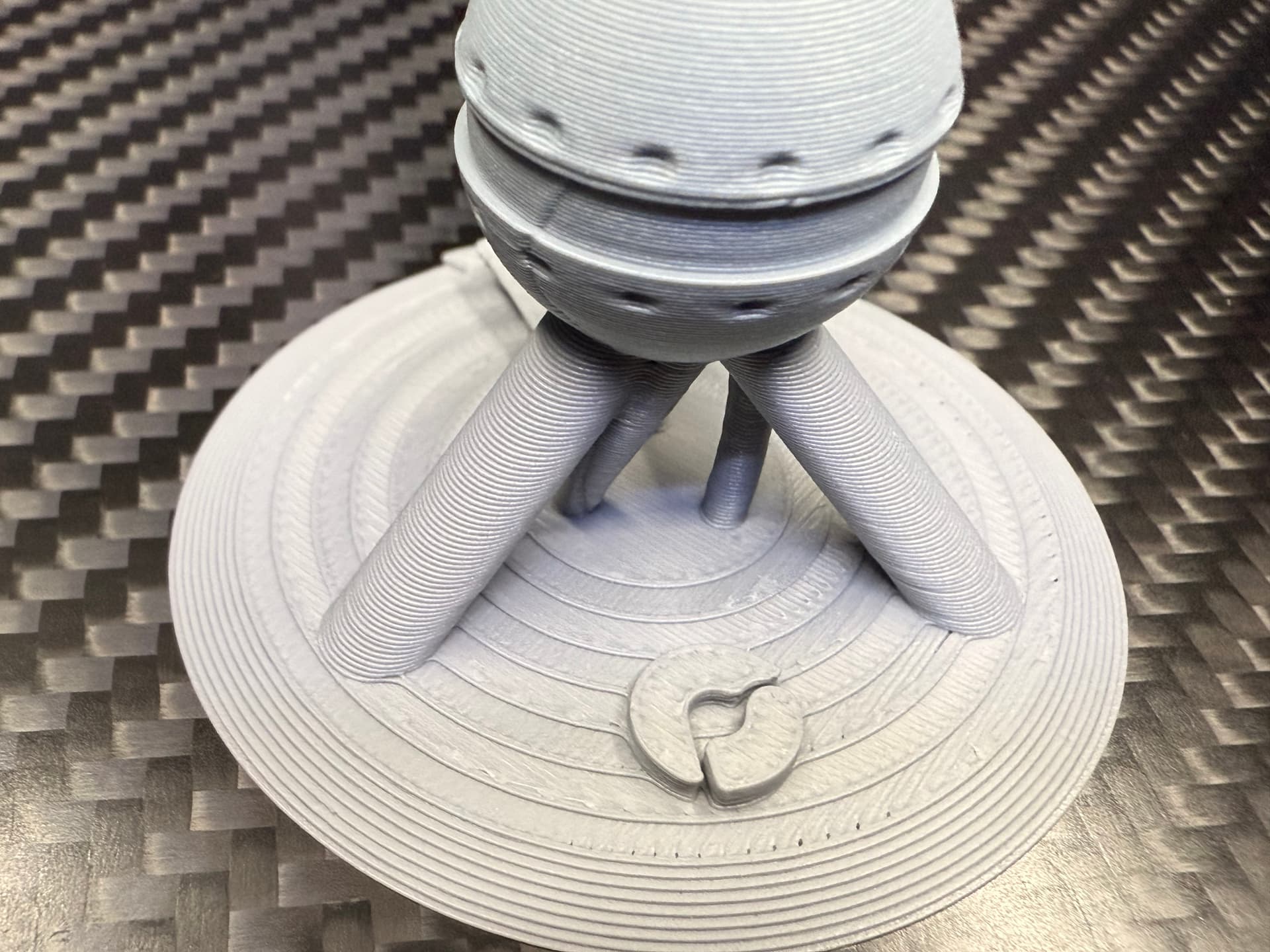

Not particularly thrilled with this. BL matte grey. Thought was printing .08 but guess I didn’t change it. Slicer says this .20 standard. Will do .08 tomorrow maybe, want to play with temps a little.
Why would another nozzle outperform stock on that model?
A hole is a hole, unless you’re printing insane volumes and speeds where heat transfer could play a role there’s nothing to gain.
Also meaningless without specifying settings/print time.
The impress-o-meter is not hitting high so far.
Erm, well, yes, off-topic, but, fair enough, I do not judge (or disagree).
I am interested in the answer to this.
I hope you’re not asking me, cause I really don’t care at this point. Just not happy with what it did print.
I’m suspecting temps and cooling had a more impact on this file than anything else, given the benchy after calibration was very nice. Meaning I did all the repairs and part swaps correctly. THAT was important to me.
