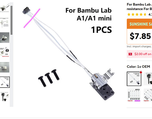

I dunno your goals but, you can just connect DC 24V to the heater core’s wire from a bench supply. no pcbs involved at all, it heats up manually
There’s not really a good point to attach. Do you go for the exposed metal on the ceramic?
I was thinking of doing temperature control too so the thermocouple would be useful.
Creating PCBs is not really a biggie with the fabs out there now…
cut there, add own connector or clips. limit to 1amp when you’re driving it manually. Your choice what to do with the thermister - its the 2 thin wires, and technically could still be useful depending how fancy your other end is.
You might also want to check continuity with a multimeter before wiring anything permanent. A few of the community pinout diagrams floating around are slightly inconsistent between revisions, especially around the thermistor and fan pins. Better safe than frying a board or heater.
Yeah, not cutting wires for an unclogging. Plus I already have the PCB.
