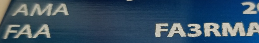

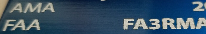

And yeah, this diode laser won’t cut metal (as well as many other materials). But it will etch Anodized Aluminum.

It won’t. But the laser will easily remove anodization exposing the base Aluminum again (which immediately oxidizes and turns white). You get something that looks like this:
You can buy blank anodized Aluminum stock on-line. Many shapes, sizes, thicknesses and colors. I have a stack of blanks that are business card sized, and some that are like dog tags (both military and the pet style).
I have plenty of bottle openers made from anodized aluminum, but I used pure aluminum as a test to show others that it won’t even leave a scratch.
