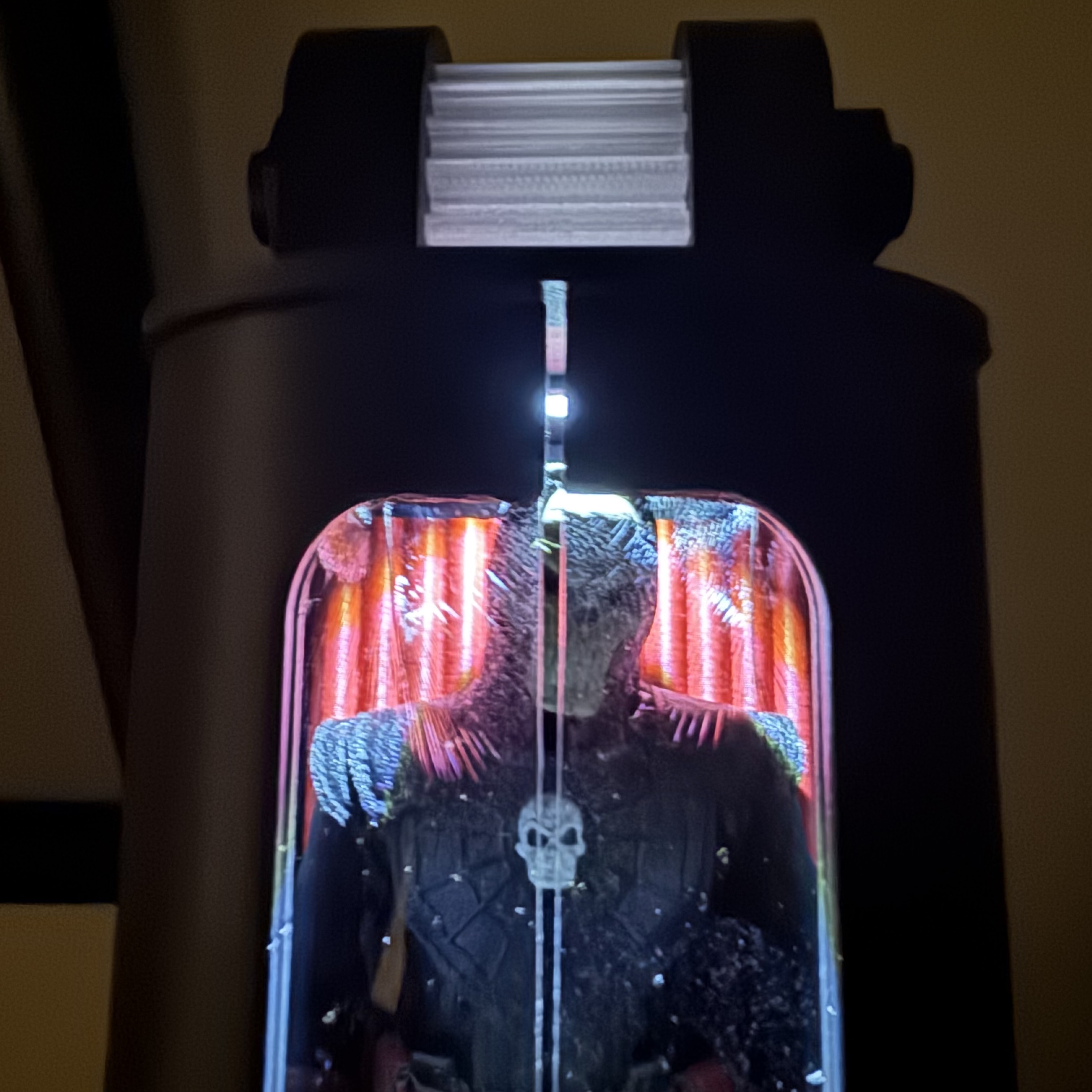

I have a project that requires 2 acrylic glass windows per unit each 110 x 22mm. It for a 1/12 scale cryogenic chamber I designed which is of a mad scientist laboratory based on an action figure and comic. I have customers that been waiting months for me to finish this. So I need at least 50 to a hundred windows. Acrylic sheets 1mm thick 8.5” x 11” are only $8 on amazon. I have to figure out how man 110 x 22 mm windows can fit on one sheet.
I tried using the cutter attachment I bought but it was only able to score the surface which then resulted in having to break or snap off the surrounding excess. This would sometimes inadvertently cause the windows to crack.
