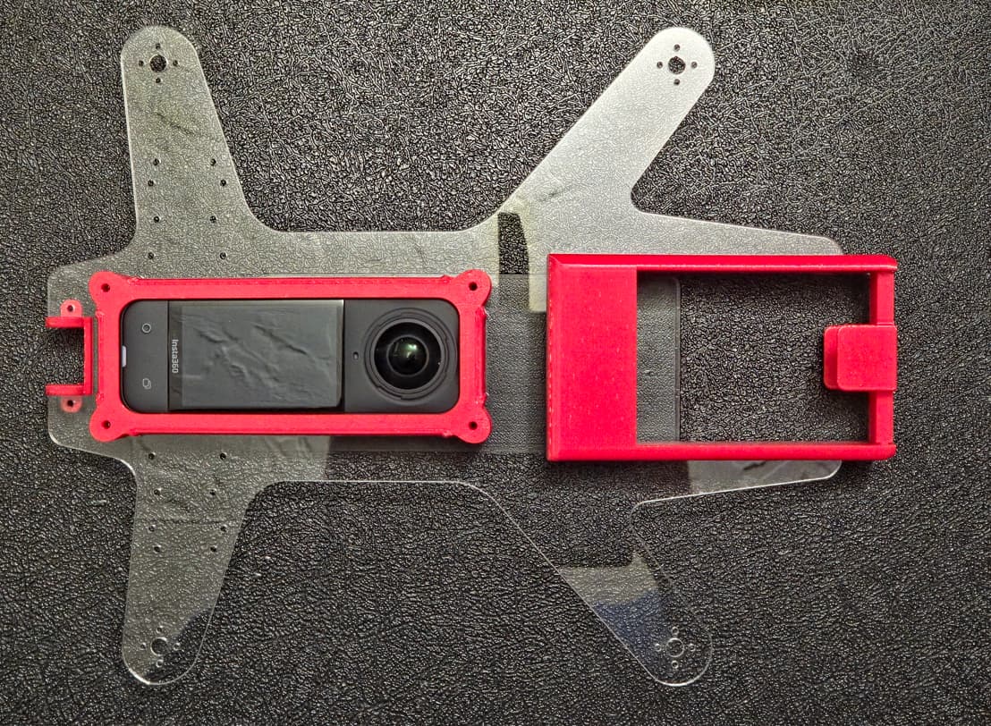

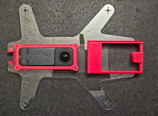

I’m designing a quad copter (aka “drone”) to carry an Insta360 camera. If I did my math right, the body of the copter will be invisible, like a selfie stick. It’s a combination of 3D printed parts I made with my printer, and a clear 3mm Acrylic frame I cut with my CO2 laser.
That’s really nice work! Are you in the US? Would you be interested in taking the job to cut the windows? I was just playing with the design and I can accommodate a window thickness from 1-2mm. 2mm would be great. The window is 110 x 22mm. The smallest Acme Plastics lists on their site that they cut is one inch and I have to wait to call them on Monday to see if they can do shorter. They use inches. Using the estimater on their site using the closest dimensions they charge $100 for 100 pieces. For 50 they still charge $100. 50 pieces would allow me to build 25 sets. If I could pay for atleast 50 pieces to get done it would be great. No hurry.

Alas, I have limited free time. I’d be happy to do it for you but there’d be no way I could give you a solid commit on getting it done. :frowning:
