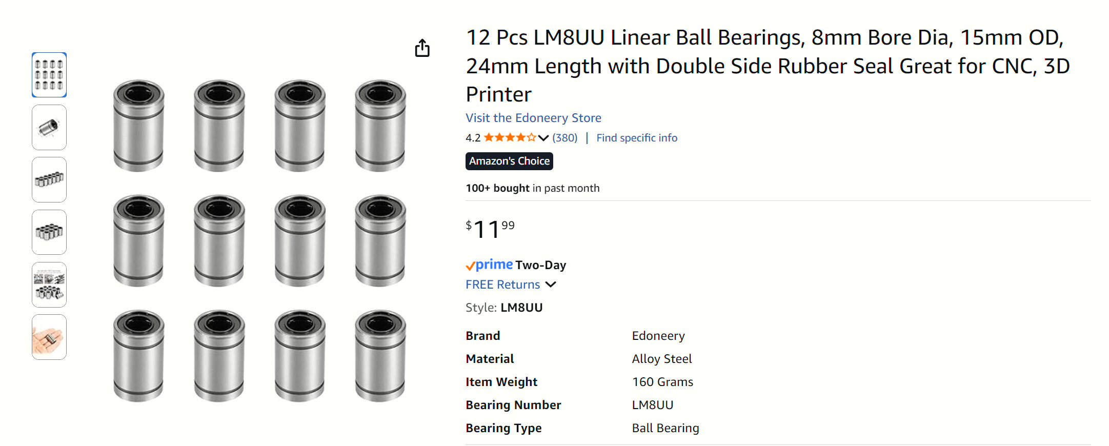

The parts you’re referencing are called 8mm linear motion bearings. They have an inner diameter of 8mm and an outer diameter of 15mm.
They are standard in 3D printing and can easily be found online. Here’s an Amazon search link:
https://www.amazon.com/s?k=8mm+slide+bearings
They range from $1–$2 each but are usually sold in bundles of 4 to 12 units. You can also do a web search for “LM8 linear ball bearings”. Any local Grainier supply or McMaster Carr would likely stock these too but expect to pay 10X the price.
