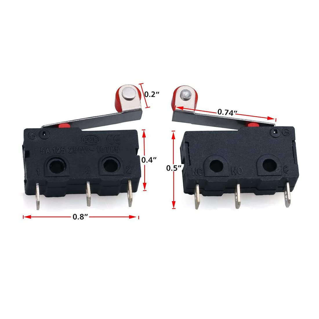

To be clear, I’m not making excuses. Bambu could easily address this issue with a simple limit switch. These switches cost about $0.20 in volume and are straightforward to integrate. All that’s required are three wires to detect when the switch is closed.
From aliexpress:
~US$0.3 for each, imagine if you buy in volume.
