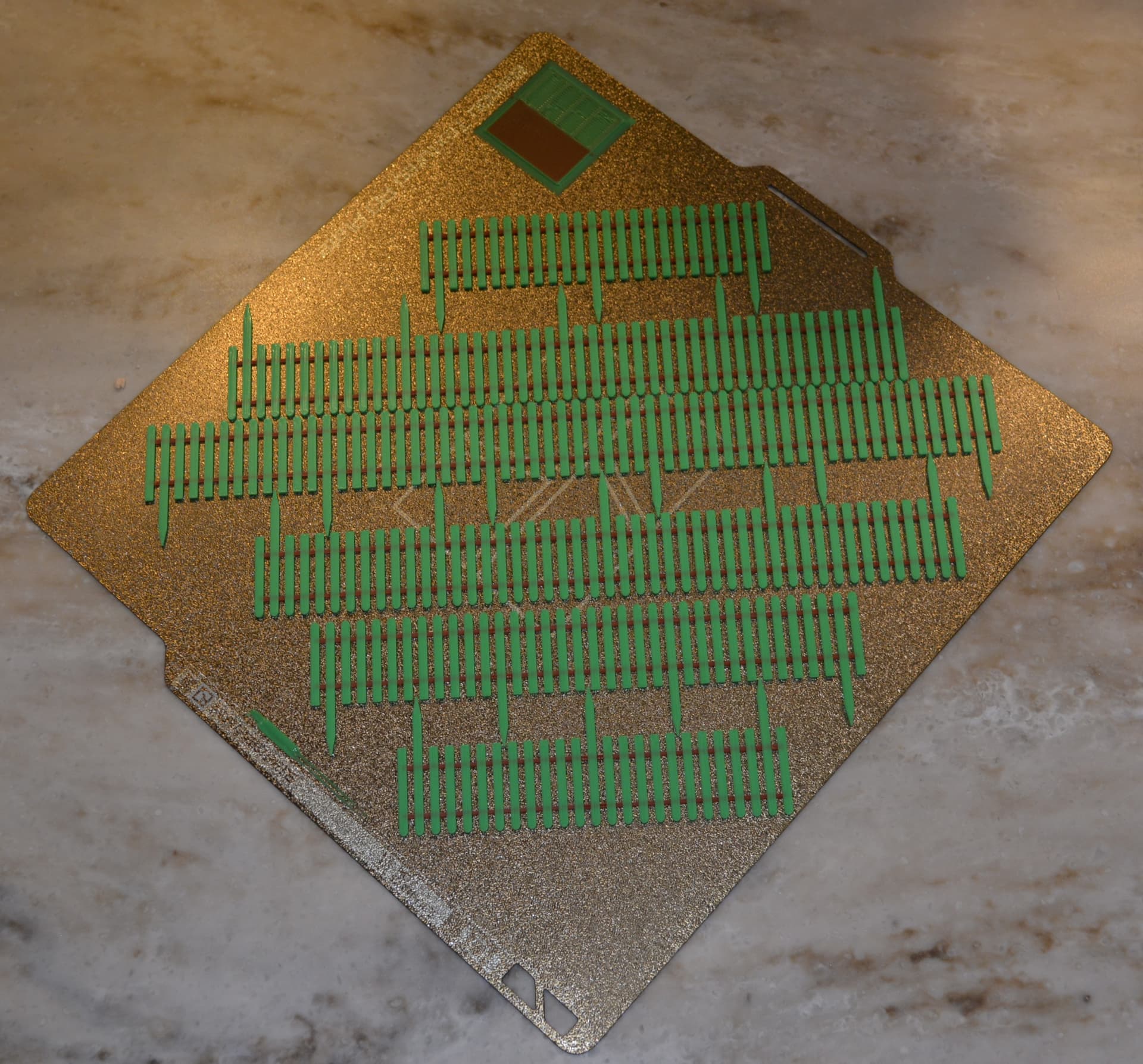

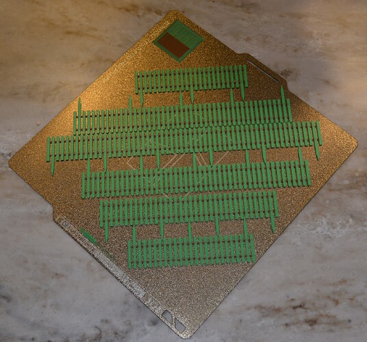

In the EXACT SAME setup using the EXACT SAME filaments (although not again dehydrated despite a couple weeks of insanely humid, raining weather) and the SAME MODELS, I have printed more than 5 kg of filament with ZERO problems. I follow the EXACT SAME plate cleaning procedure to include a light application of hair spray after cleaning.
Previously I found it nearly impossible to print multiple instances of the same object no matter how small or large. The one time I attempted the “fill bed with copies” to find utter disaster I was convinced that the option was a joke! At best I could fill about a quarter of the bed with these exact same things in various arrangements. The first machine could not complete the adhesion layer on a full bed. It could not make it past the second full color switch for more than 1/4 of the bed. This utterly maximized bed printed PERFECTLY!
