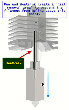

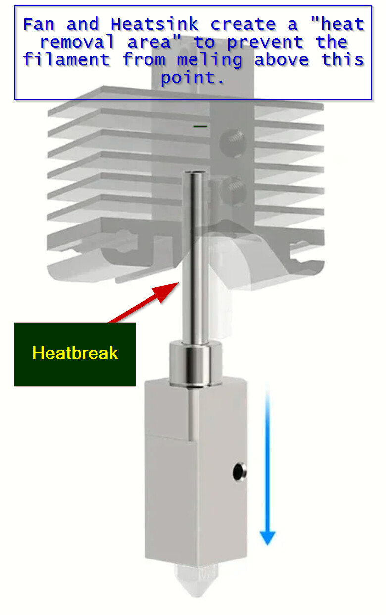

Likely Cause: Heat Creep – A well understood problem and easy to remedy.
Your issue matches classic heat creep. PLA softens sooner than PETG, which may explain why it’s the only material causing failures. If the heatsink isn’t shedding heat effectively and/or your chamber air is hot (50°C+), this creates ideal conditions for jams.
This diagram shows the heat break’s role. If cooling is inadequate, heat migrates upward, softening material prematurely and locking it in place. Unless I misunderstood your post, this sounds like what is happening in your situation.
