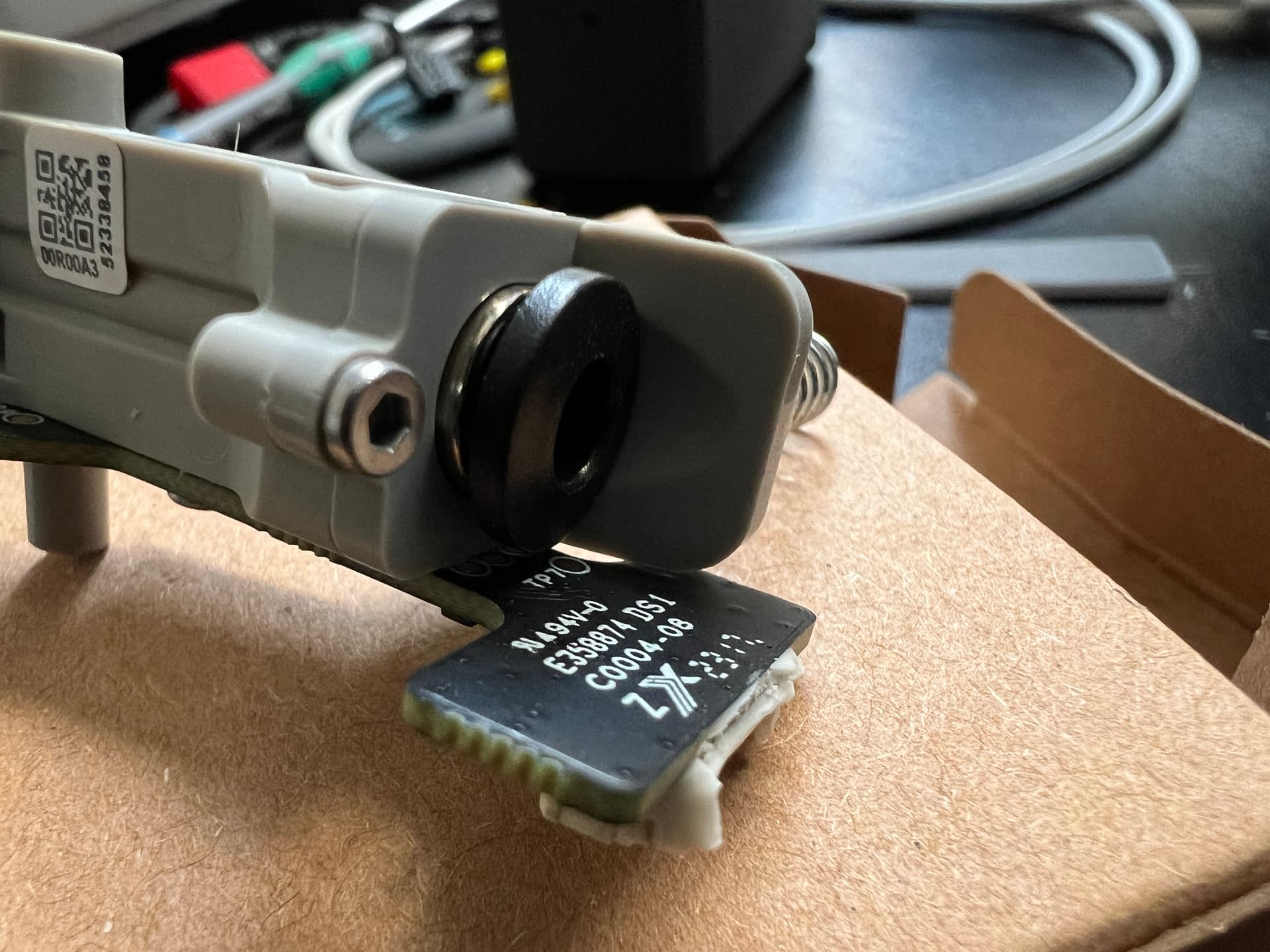

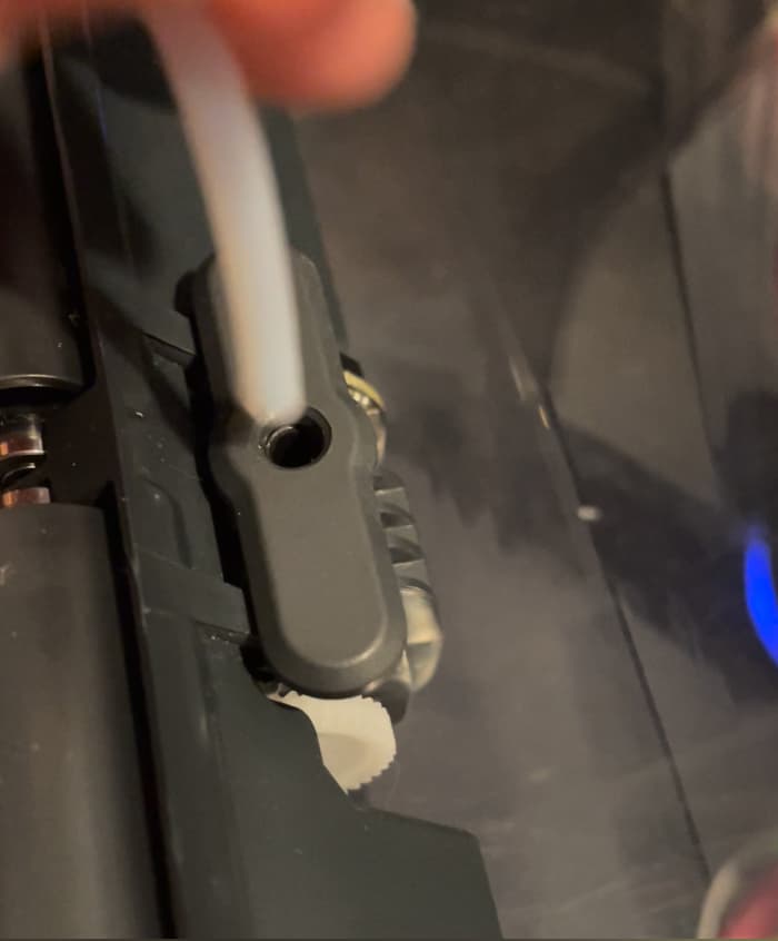

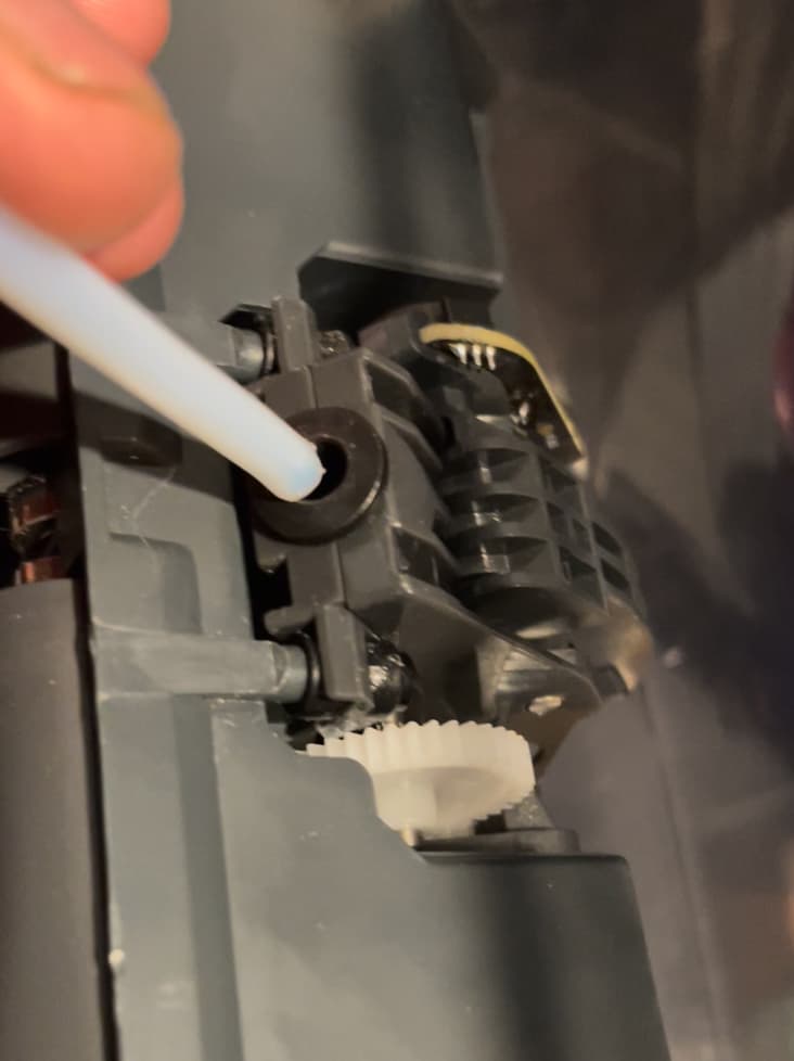

My wife and I on the advice of a top computer tech student went with the Bambu Lab P1S with the AMS system back in March. People have been amazed. We have YouTubed, read articles, this forum! and networked. So much joy. However, Since March with may printers we had a PLA Glo (all Bambu) run in June. Lots of amazing stuff using blue lights but trouble started. Ams wouldn’t pull, kept having errors, then manually adjust.
We cleaned tubes, ordered new nozzle, multiple recalibrations, I ordered spare parts from Bambu just in case (Troubleshooting. We replaced 2 first stage feeders. I hope these pics can help more than words bc we are flummoxed. We miss printing… Two pics attached (fingers crossed file format is okay :slight_smile: ) the tube isn’t gripping correctly. We are puzzled and many printer errors/fixes/troubleshooting hours!.

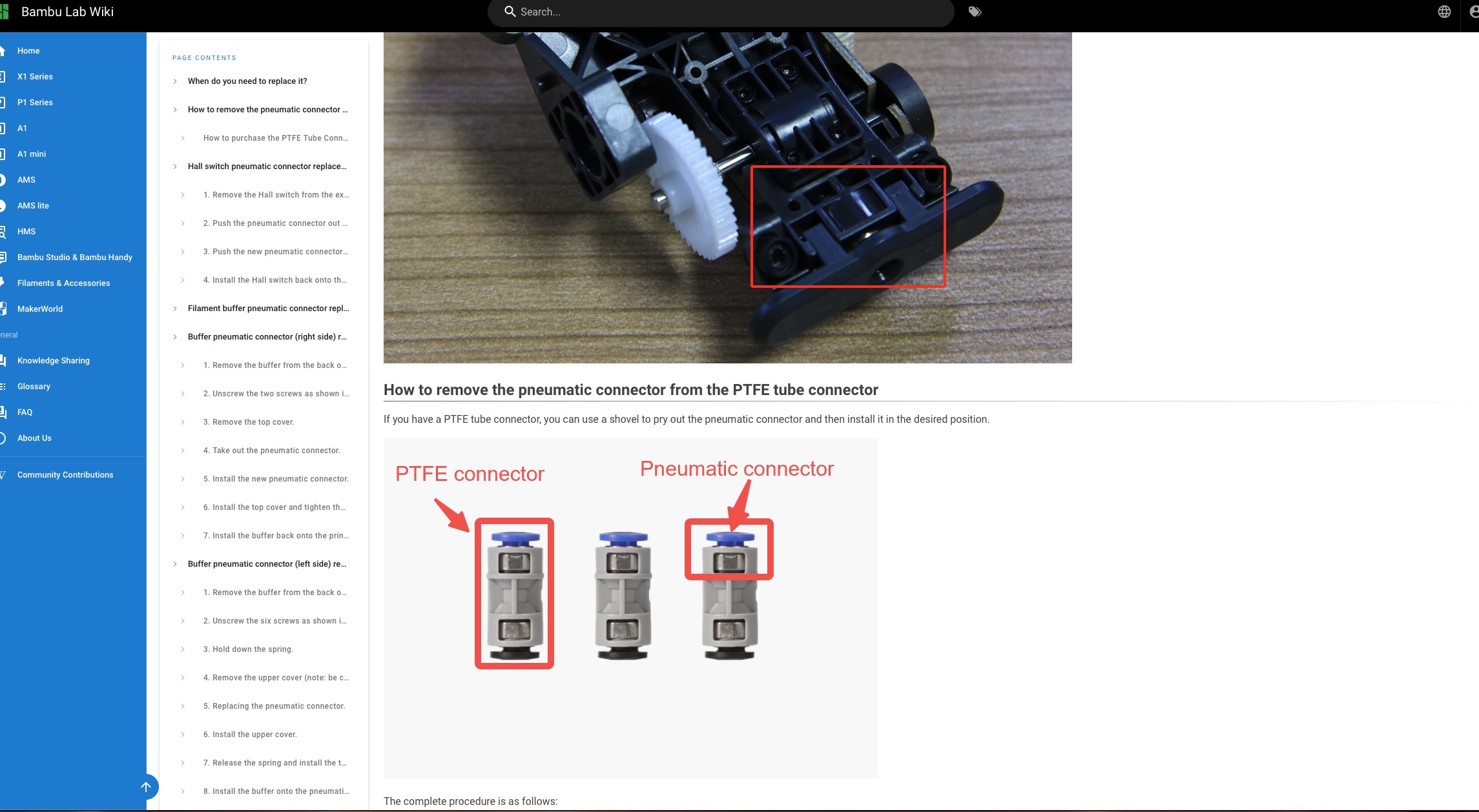

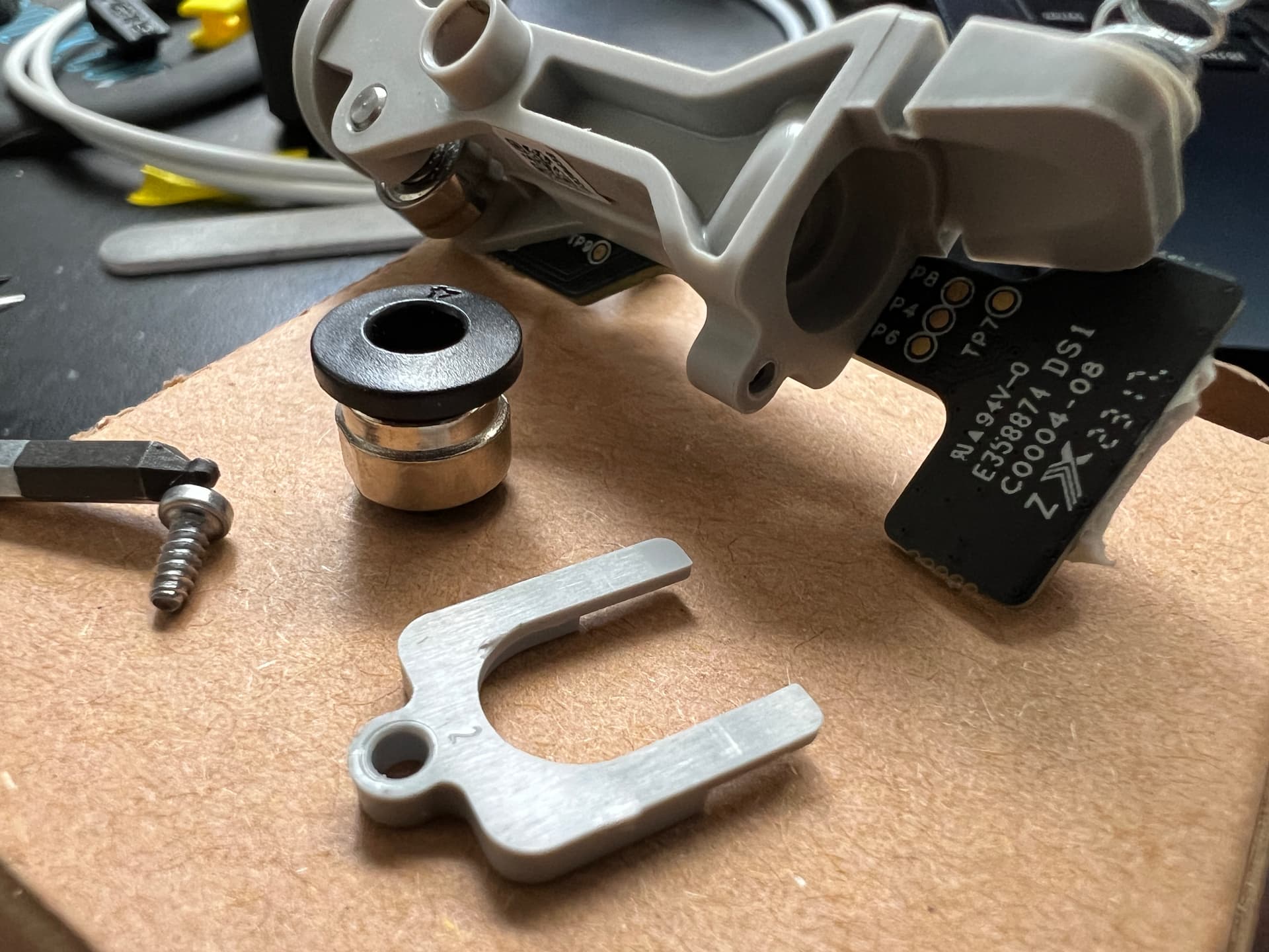

For some reason that pneumatic connector breaks out of the blue, its replaceable but you’ll need to open the Hub its attached to replace it. The part is available but not in standard form. This link shows the replacement item/donor part. The Wiki is really good for instructions which are in the same place. Replacing the pneumatic connector (PTFE Tube Coupler) | Bambu Lab Wiki
Edit, this link shows the disassembly better Dismantling and cleaning the AMS internal hub unit | Bambu Lab Wiki

In typical hoarding fashion, I managed to remember I had a spare Feeder. Just so happens I noticed you mentioned you’ve ordered/replaced one. The Pneumatic connector is the same, you just need to yoink it out of your spares :))

MIne broke and I cut it out of the PTFE connector that came with the printer. Who knew I could have just unscrewed a feeder to get it, besides not me.

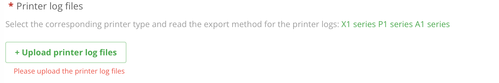

so they won’t let me submit a ticket without a log. I go to their tutorials. I only see for PC and for SD cards. I have Bambu Studio (which is better since update but not as good as Cura!). I use Bambu Handy app- very convenient.
How do I get the log so I can submit a ticket and see if they respond! I am still under warranty !
I know I’ve submitted a ticket without a log when I replaced my AP board. You don’t have to upload a log. It may search for one and just fail on the log after a bit and let you continue. Been a little while since I did it but I’m sure you don’t HAVE to upload a log
yeah so it insists that I need a log. I was able to get the one from Bambu Studio, but in hour number two of just trying to submit a damn ticket, I can not figure out to get past this just to submit!
right, did you click it and have it attempt to upload your log?
I believe if it can it just skips it. Pretty sure that’s how I did it, unless it’s changed.
When my AP board was down I couldn’t access the printer beyond turning it on. It could have been in the categories my support questions were in the drop down, but I know it timed out trying to upload a log, and I went on.
Like I said, if it’s changed then I apologize, but try it. Can’t hurt.
The logs update was confusing for me initially, it is a tad convoluted. The “studio log” won’t work, it has to be from the SD card transfer follow this wiki Export X1 series printer logs to a micro SD card | Bambu Lab Wiki
It was a rather large one from memory to upload but its what they want hmmmm :slight_smile: patience needed
I barely was able to put in a. ticket. I emailed them. They finally write back and want ticket number. Still no luck!
