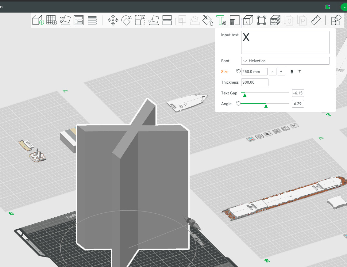

Or within Bambu Studio you could just add a text shape ‘T’ key - and set it to X and make it really big.
Hah, i really like this text scale, clever
