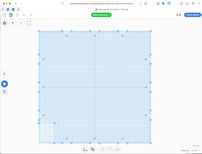

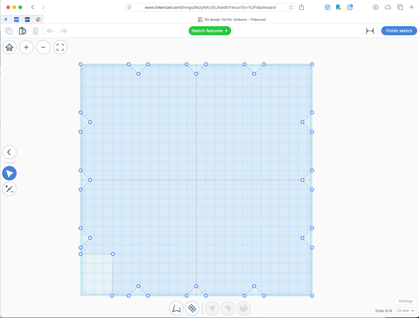

What I would do is create a model in TinkerCAD. Make a sketch, fill the volume, clip a corner to avoid the exclusion zone, raise to your height target, then export the STL and print as a vase. Here’s an example:

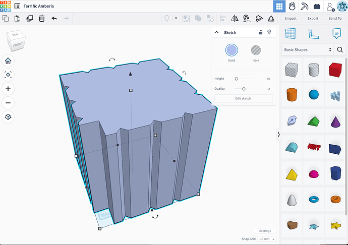

I added notches to the sides to add rigidity:

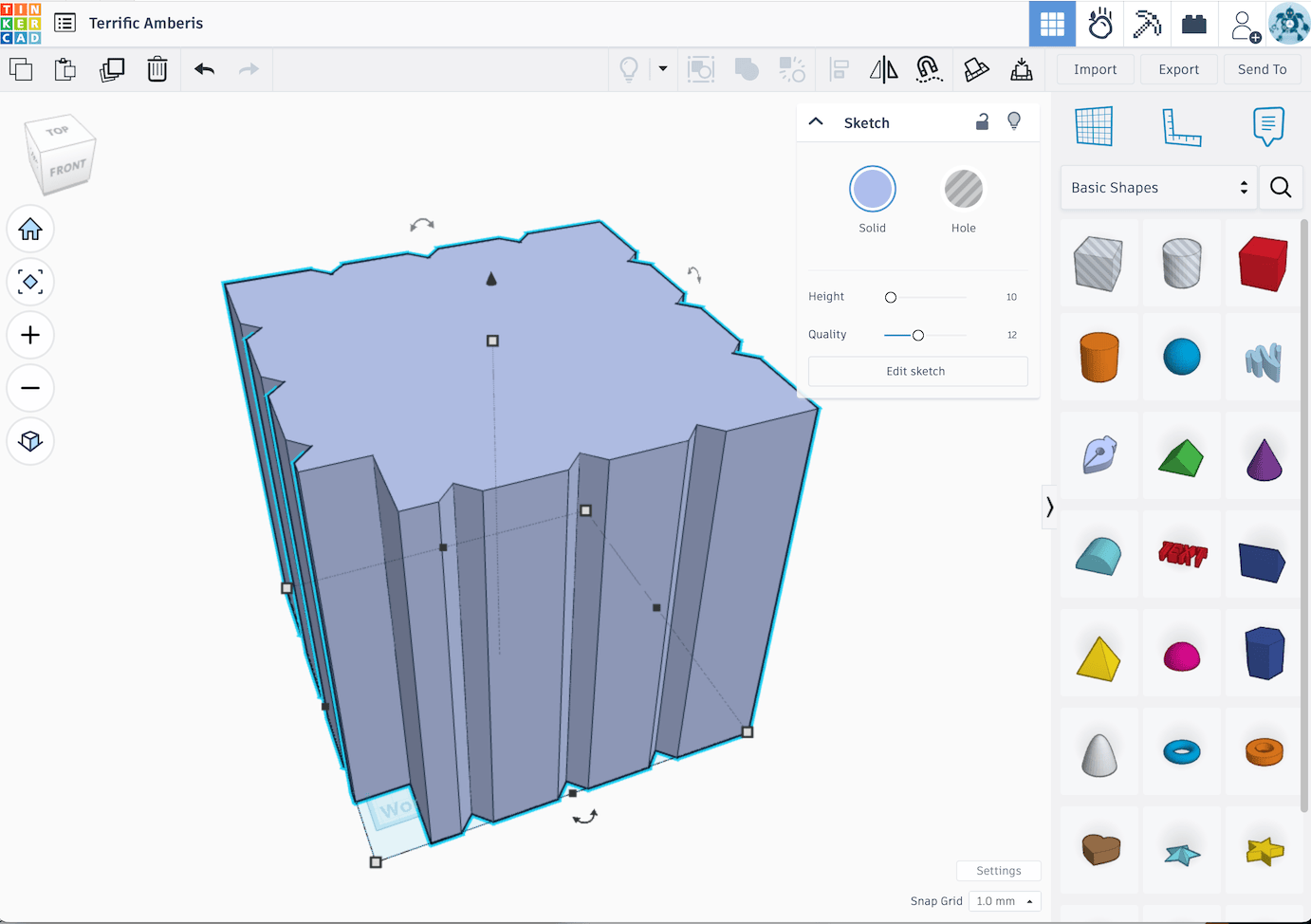

raise to 250mm (or whatever your target is):

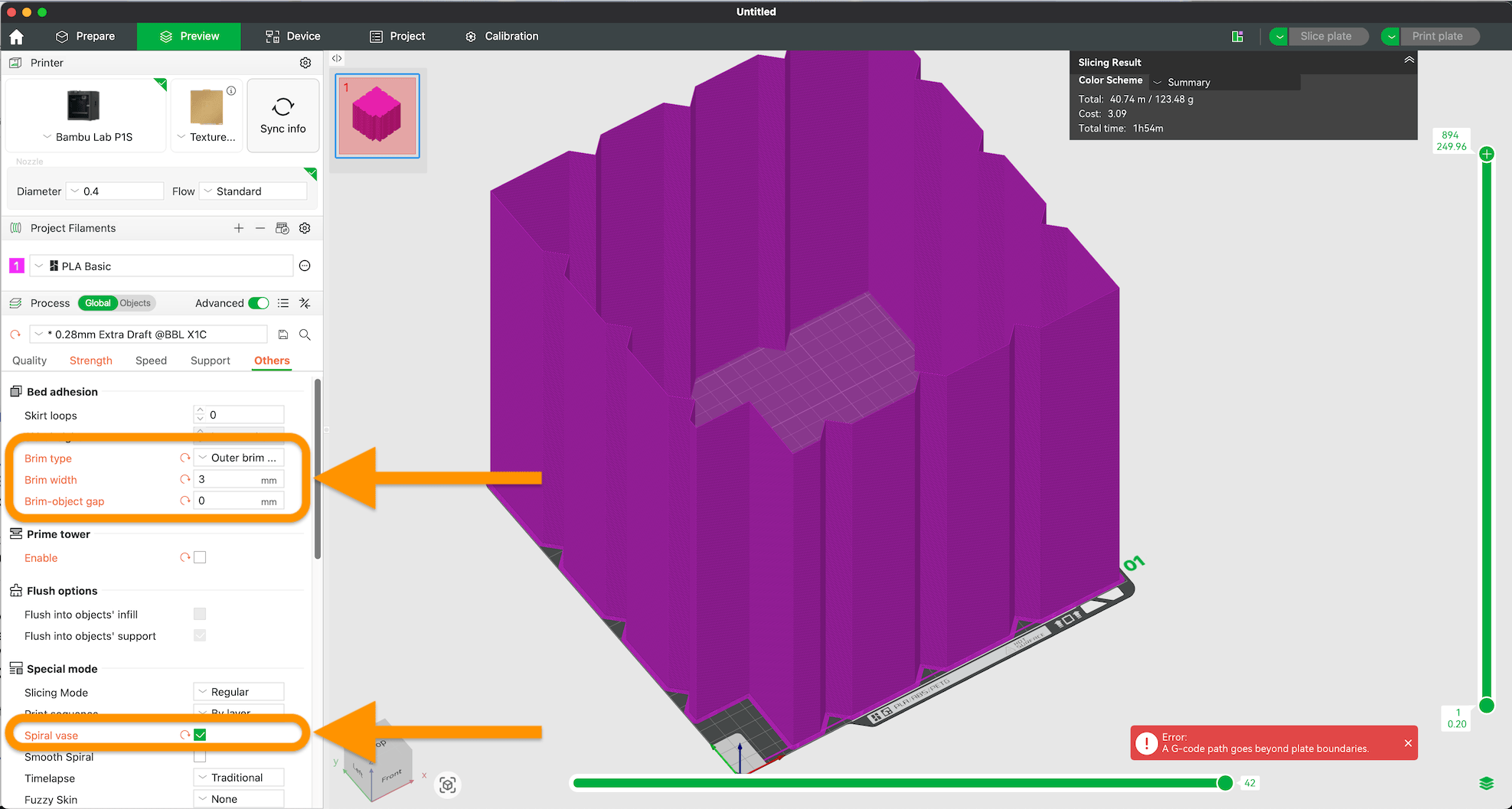

bring into Bambu Studio, enable vase mode, set bottom shell layers to 0 (in the Strength tab, not shown here), and add a small brim to keep it in place:
You also can modify the printer settings to ignore the exclusion zone, documented in the link above. (I didn’t bother because I am not actually going to print this test.)
This is huge, yeah, but it gets the print head near all edges, so if something is wrong at a specific spot you’ll probably be able to spot it. To be more thorough, disable the exclusion zone and don’t notch the corner.
