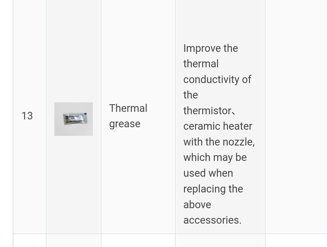

I am new to 3D printing and have a X1C with AMS. The package came with some lube packets and thermal grease. Is there a guide for what needs to be lubed, how often, etc.? What about the thermal grease? I understand it’s purpose since I have been building PCs for decades, but I don’t see how it fits in with my new printer.

https://wiki.bambulab.com/en/filament-acc/acc/lubricant-grease-oil
https://wiki.bambulab.com/en/general/lead-screws-lubrication
Oh! The accessory list on the link explains their purpose! Thank you for that!!!

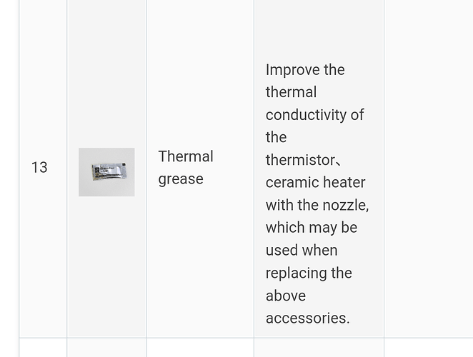

sorry to beat a dead horse but these dont explain the thermal grease use?
I had read this but thank you for making it clear for the community. Is there a video or guide that explains the proper contact points or is it obvious? I’m guessing it’ll be obvious.
Ugh… I need to get a LOT better at searching the docs. Thank you for your patience with a newbie. That is absolutely perfect and I love that the videos are extremely short and to the point.

The grease is for the lead screws and the thermal paste is for the nozzle.
Ok nevermind I think I found it… in the section: supplementary instructions for X1C and X1C combo accessories in the box:
it says the “grease is for the Lead screws”, so I guess not need to buy SuperLube yet.
