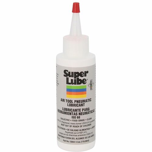

Here’s one Super Lube brand product that was listed on Amazon UK but the data sheet from their website does not specify PTFE but some lubricant is better than no lubricant even if it lacks PTFE.
https://www.amazon.co.uk/Super-Lube-692-12004-Pneumatic-Tooloil/dp/B00N77RY8O/
