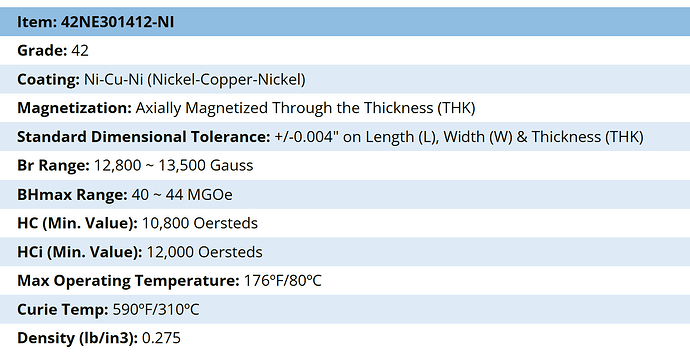

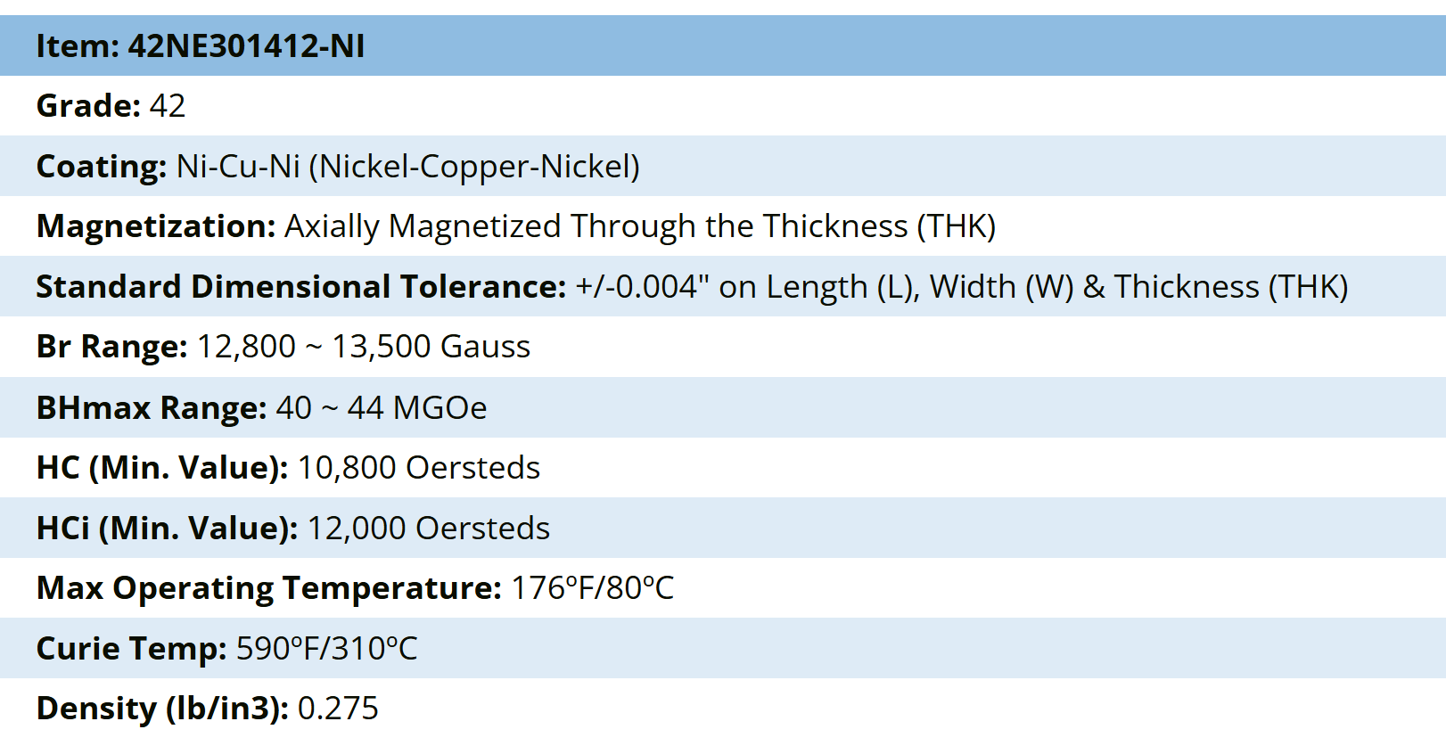

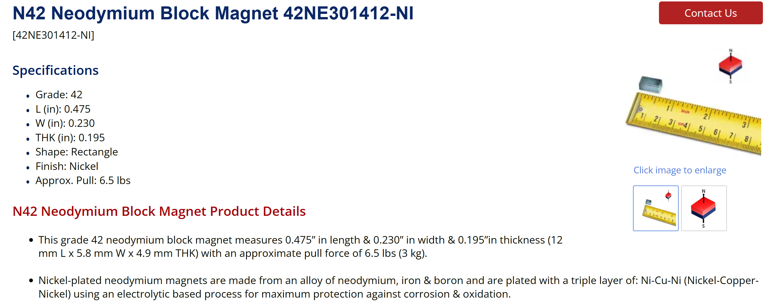

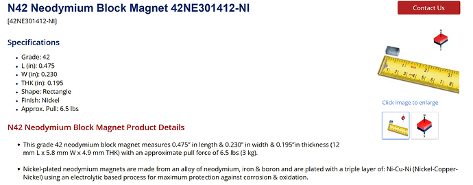

I don’t personally know of any specific retailers in the US, but I can tell you exactly how a website and associated product information should be presented - something that Amazon, for example, doesn’t do. This is what it should look like:
Everything else is just junk: A reputable dealer knows the pull, the dimensions, the alloy, etc. If there isn’t a long description like 42NE301412-NI or Q-10-04-1.5-N, you can forget about that dealer right away.
All reputable retailers provide a precise product description that accurately describes the magnet, including tolerances:
