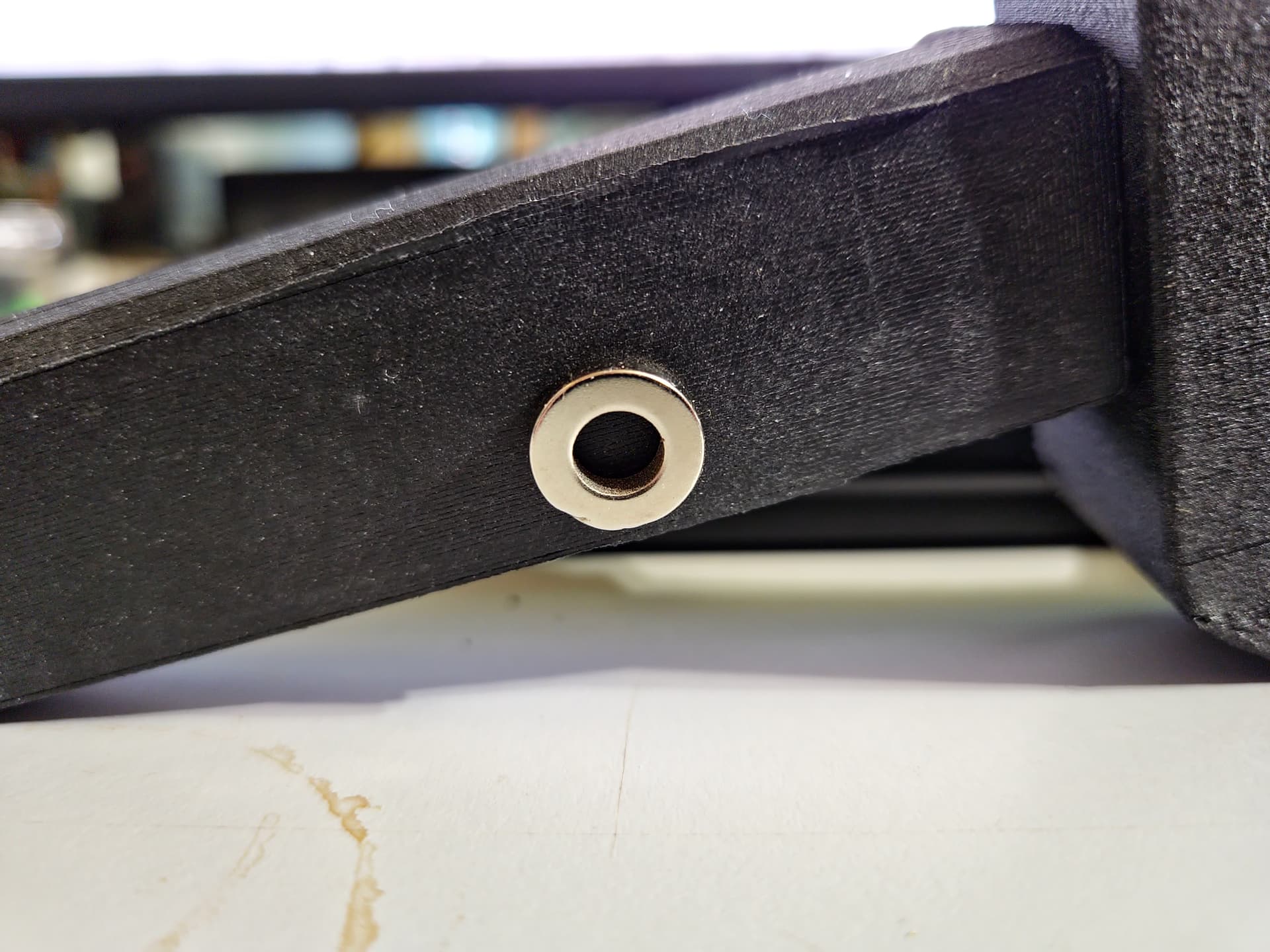

BBL PA-CF is magnetic. Not very magnetic, though. And no one knows why…

That’s fascinating. I did not know that. While I don’t have PA-CF, I will check out some PLA-CF that I have and see if it has any magnetic properties. I don’t see how Bambu PA-CF can have magnetic properties unless it has some ferrous, Nickle or Cobalt in the material and neither Polyamide nor Carbon Fiber has these properties. That said, what else is in there that isn’t on the SDS? :confused:
There’s a thread I started when I discovered this a couple of years ago, I think. Wasn’t that long after I got my X1C. I was going to do SEM/EDX on a sample to see what its constituents were. I have to think there’s Iron in there for some reason. But I never got around to it.

I am intrigued as to why the PA-CF seems to be ferro magnetic.
