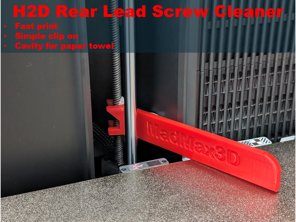

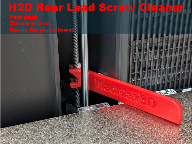

The rear leadscrew of the H2D is a bit tricky to reach, so I’m currently looking at some printable tools meant to address that, such as:
