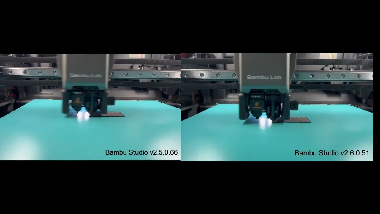

Major bug in studio 2.5.3/2.6.0, fail to pre-heat left nzl (solved with beta FW)
BS 2.5.3.61. (25characters)
I have the same issue on my H2C. Reported in github.
Thank you, hope it gets fixed because the improvements of 2.6.0 will be hard to pass when the H2C firmware is updated.
I’ve made a side-by-side video of the issue. Both videos start at the same time and stop when the same layer is finished. For this simple one nozzle change it adds 20 seconds to the print!!

Yes, I made a comparison. Indeed, the code from the latest version of Studio includes a command to heat the left nozzle at the very end of each layer. However, the heating of the right nozzle is turned on beforehand. This is a bug in the slicer code; it can’t be fixed by adjusting the start, end, and other g-code in printer parameters.
Yes I was confident it was in the machine gcode but no change related to it in start or filament change gcode so we cannot temporarily fix it ourselves
I received a response to my ticket. From what I could gather from this response is that the issue is known and is related to an incompatibility between studio v2.5.3/2.6 and current H2C firmware. So I guess this issue is specific to H2C and new studio version may behave fine on H2Ds. I wonder what other studio features are impeded when used on H2C…

Since I was already digging into the Bambu Studio codebase for other issues, I also traced this regression. Below is a technical analysis showing where the behaviour changed, which commits are involved, and why H2C ended up being affected as well.
Regression: Pre-heating of the idle nozzle no longer reaches print temperature in BambuStudio 2.5.3 on H2C
Summary
Between BambuStudio 2.5.0 and 2.5.3, the pre-heating behavior of the idle nozzle on multi-extruder printers changed in two measurable ways. The pre-heating machinery itself was not removed; it was modified:
  1. The pre-heat target temperature was lowered from the filament’s nominal nozzle_temperature to nozzle_temperature − N, where N = filament_cooling_before_tower (typically 10 °C). The remaining offset is covered by a synchronous M109 at the tool-change point rather than by pre-heating during the preceding idle window.
  2. An M400 synchronization barrier (wait-for-motion-complete) was inserted before the pre-heat M104. This guarantees that heating only begins after all buffered moves have finished, which in practice shifts the M104 command closer to the tool change when it is preceded by a long travel.
Both changes were introduced as part of the work that added X2D support, between 2026-03-25 and 2026-04-08. The H2C is affected because two of the underlying mechanisms are not gated by printer model: the M400 barrier applies unconditionally, and the filament_cooling_before_tower parameter is stored in the H2C filament profiles rather than on the machine.
The combined effect at each right-to-left tool change is an added dwell of approximately the time required to cover the residual temperature delta (≈ 5 – 15 seconds, depending on filament temperature and hotend heating rate). The impact accumulates over the number of tool changes in the print.
