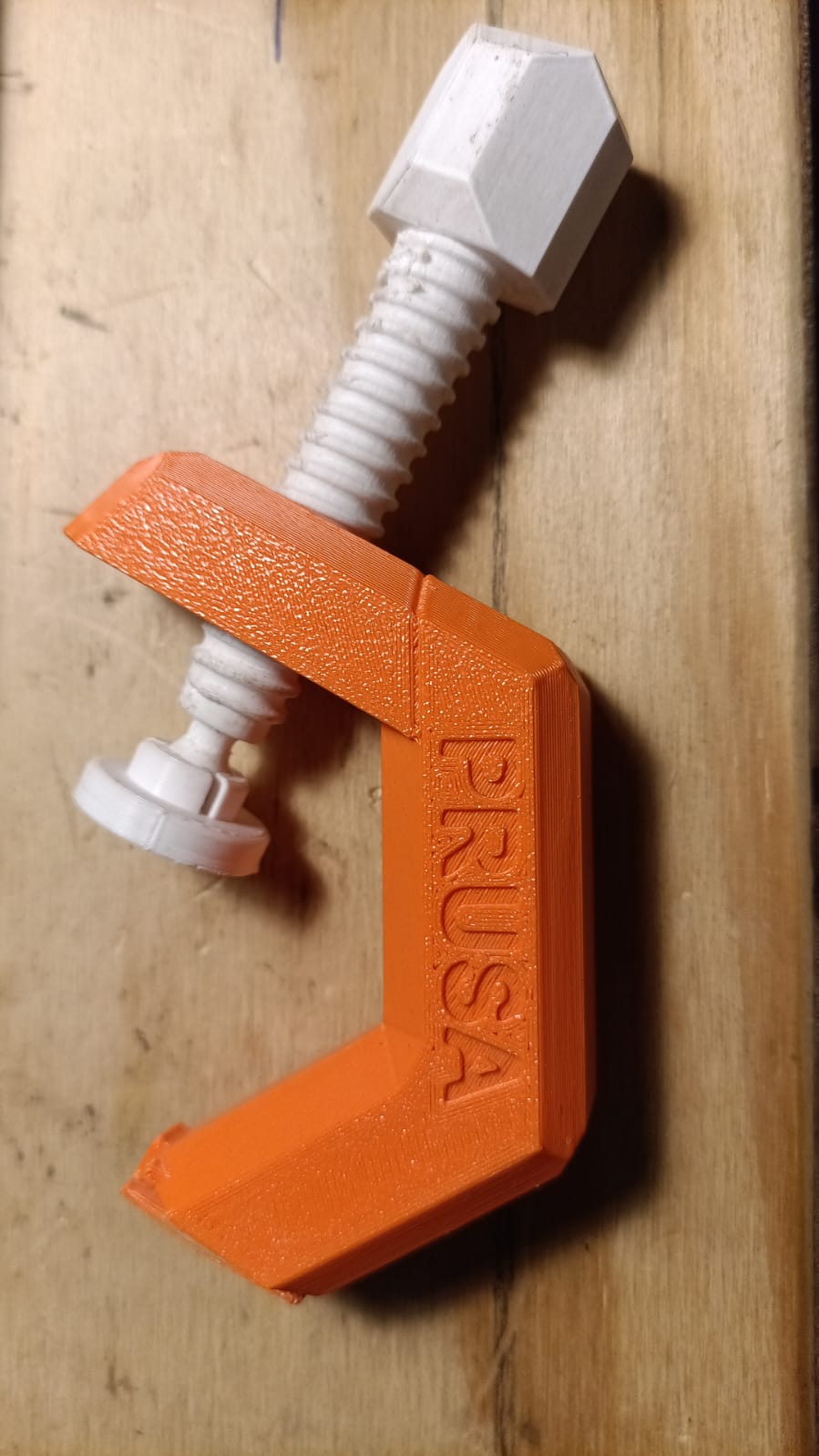

How do I make a print flush to the first layer? Example: I want to put text on the bottom of my print where the first layer is. I want the text to be a part of my first layer, or in woodworking terms, flush with the first layer. How do I do this? Any tips?

Sending you a picture of clamp for the rail of a plunge saw that has lettering both sides, on the bottom and top faces.
Assuming you’re adding text in the slicer (BS/Orca), first, for simplicity, turn (place) your object text-side up. Then using the Text tool place text on your surface with a “Thickness” of 0 (or 0.1 which seems to be a minimum for some reason) and “Embedded depth” of however deep you want your letters to be embedded (eg. 2mm). The will crate a “text shape” object part with the top of the text flush with the surface. Then exit the text tool and flip the object back over so the text is facing down.
One you have a “text shape” you can assign various properties to it, like a different color filament, or a different bottom surface pattern, or just have it be all walls, for example. You can also turn the text in to a “negative” modifier which will carve out the text (like in the clamp example by Albatroz). But be careful because this creates overhangs since there will be no bottom layer(s) where the text is (since it’s empty space). Embossed text/designs typically do best on top.

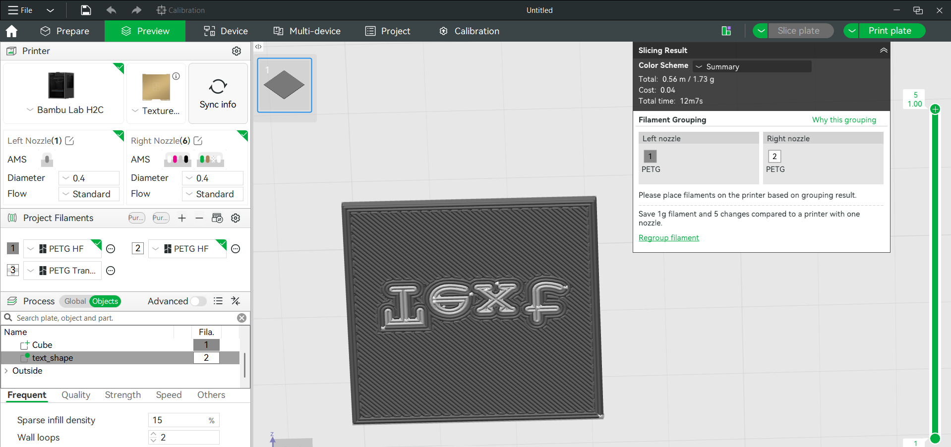

[This is showing the first layer.]

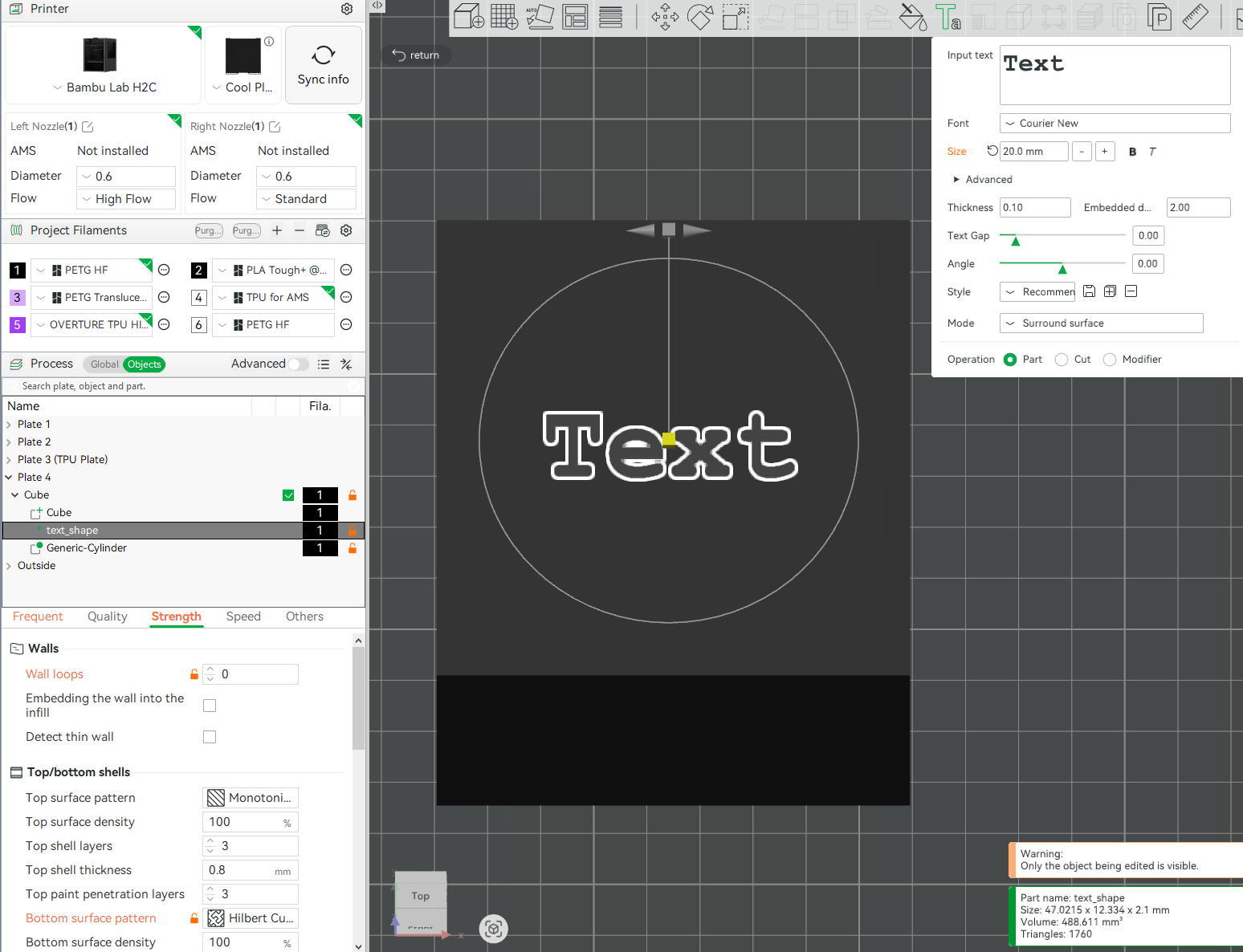

Adding text in Studio:
Changing its type into a modifier (right click):

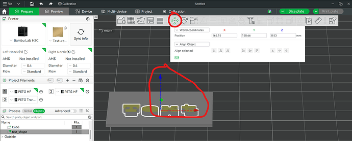

Placement (and, if desired, size adjustment two icons further to the right):

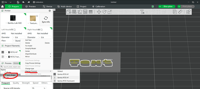

Change filament (right click):

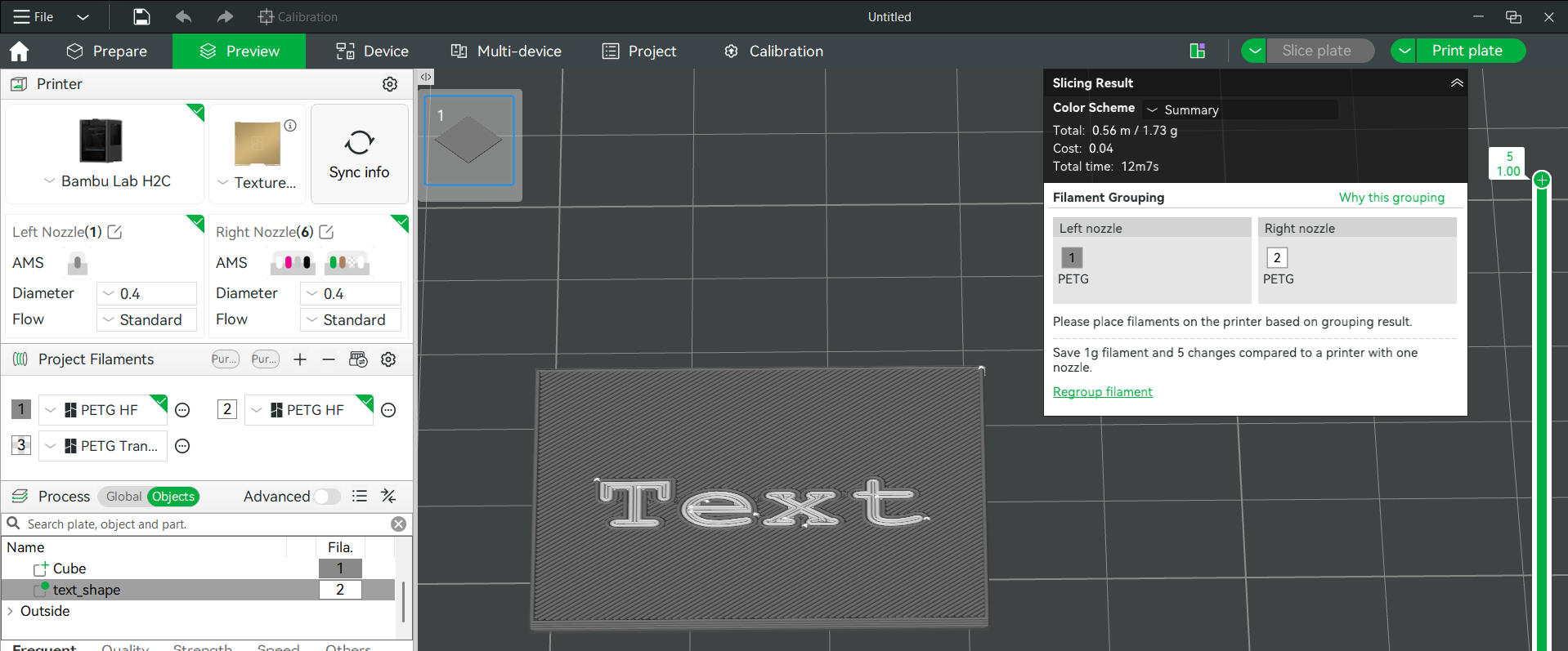

Slice => Flush top and bottom in this example
