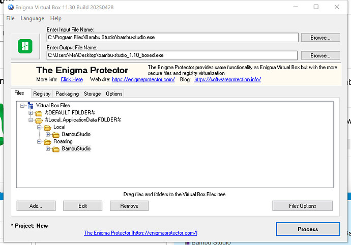

After installing the virtual box you need to add Bambu Studio to it.
As you can see it is a matter of adding the program folder first under “Enter Input File Name:”.
But that is only for the folder location, not the contents.
To add the contents we also have to add the Bambu Studio folder in the Files window below.
Simple click on ADD, select “Add Folder Recursive” and select your Bambu Studio folder.
It should be “C:\Program Files\Bambu Studio”.

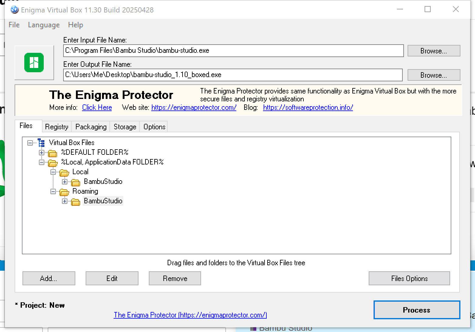

This alone only gives you the basic Studio installation but no user related data and not the vital network plugin.
To get it complete add the folders as in the pic above.
In the Files window click on “Virtual Box Files” to highlight it.
Click on the “ADD” button and select New Root Folder".
Select “%Local ApplicationData Folder%”.
Click OK :wink:
Highlight this folder and with a right click select “New Folder”.
Do this twice, first for the Local user data folder than for the roaming one.
Should be>
C:\Users"YOUR USERNAME HERE"\AppData\Local
and
C:\Users"YOUR USERNAME HERE"\AppData\Roaming
Do the same again in the freshly created folders to create a ‘BambuStudio’ folder in each of them - as in the pic above.
Last but not least add the content of the two folders to the virtual box.
Means you right click on the BambuStudio folder under Local and select “Add Folder Recursive” to select the BambuStudio folder in YOUR local user data folder.
Before clicking on "Process’ make sure you selected a meaningful output folder, like right on the Desktop :wink:
Backup anyone ?
Simply select the same three folder as above and pack them with Winrar or such - just make sure to store the complete path and not just the relative one.
