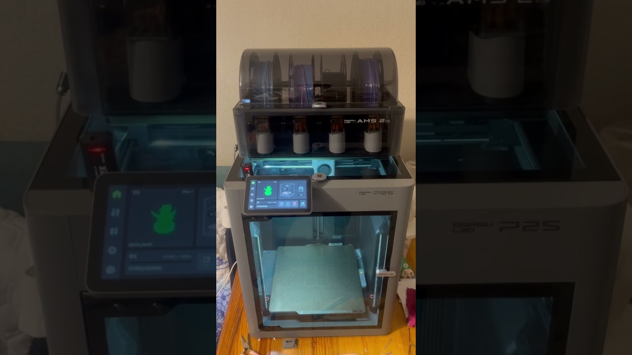

Here’s what it sounds like on my P2S:

The conversion is the easy half. The hard half is the MIDI itself. The motors give you a narrow range and one note at a time, and a file downloaded off the internet was written for instruments with none of those limits. Converted straight across it comes out as noise that only vaguely resembles the tune, which is why most people try this once and give up.
A friend of mine is a musician and he reworked the files by hand: octaves shifted, chords stripped to a single line, note lengths adjusted so the rhythm survives. That’s what makes them recognisable. No converter can fix a file that was never going to fit the range in the first place.

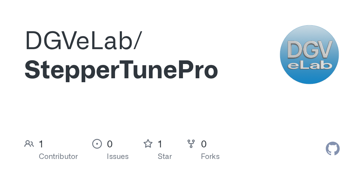

In my own software I took a slightly different approach: instead of reducing the arrangement to a single melody, I split the different voices across multiple stepper motors. This makes it possible to keep the main melody while also adding simple accompaniment or additional voices.
It requires some manual work as well, but I found that using the motors separately opens up some interesting possibilities for more complex arrangements.

In my case I’m not limited to a single melody line. In StepperTune Professional I can split the arrangement into multiple voices and assign them to different stepper motors, so one motor can carry the main melody while the others handle accompaniment or additional parts.
The software then generates the G-code for the arrangement, so it’s closer to using the printer’s motion system as a multi-voice instrument rather than relying only on a simple MIDI-to-M1006 conversion.
I also treat each printer model separately, because the usable note range, resonance and motor behaviour can change from one machine to another. So an arrangement that sounds good on one printer may need different tuning on another — for example on the P2S compared with other Bambu models.
I do have recordings and demos. I can send you one so you can hear how the multi-motor arrangements sound, and of course feel free to show it to your friend.

You can try StepperTune directly on your P2S and generate the G-code yourself. It lets you split the arrangement across multiple stepper motors, so it should be a good comparison with your current M1006 workflow.
Here’s the GitHub page:
If you and your friend try a few arrangements, I’d be really interested to hear how they sound on the P2S. A recording would also help me improve the profile.
