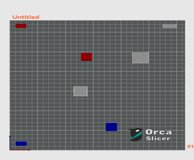

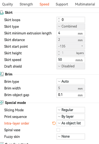

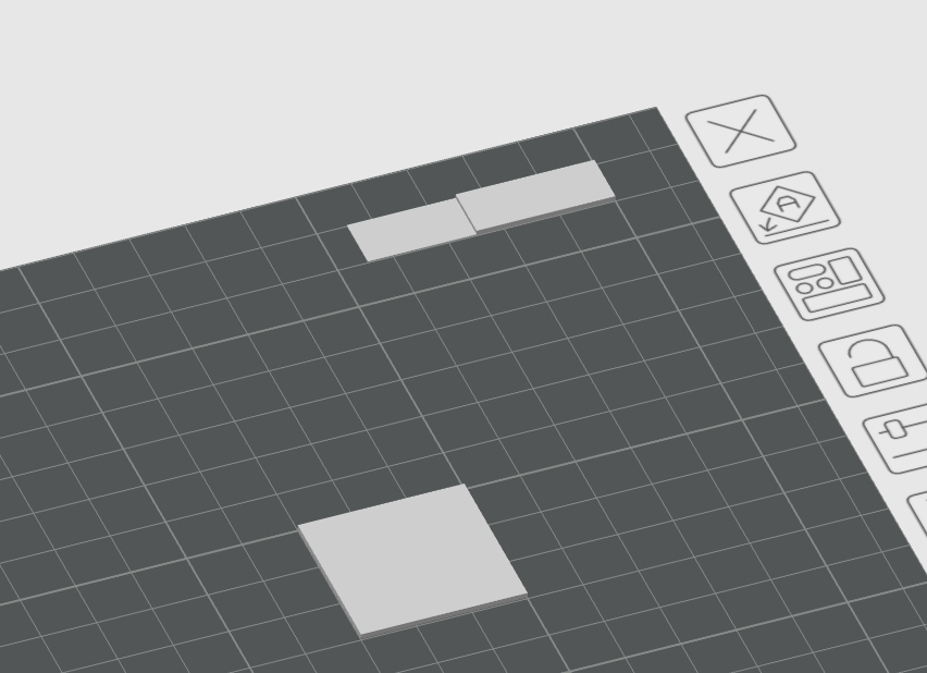

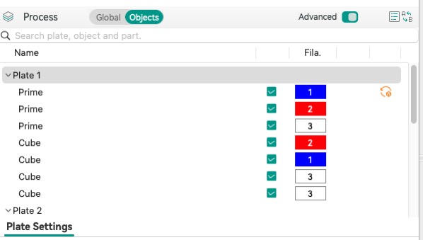

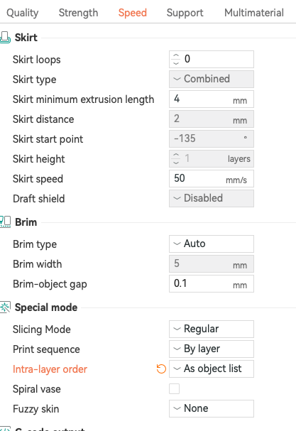

For another printer I am working on - which actually requires 3 prime towers I have actually modelled the prime towers as individual objects - which could eventually be something useful, and then using the ‘Intra-Layer-Order’ option in Orca Slicer
Put the prime objects first in the order, and also named them prime
Then they act automatically like little prime towers.
NB/. A post processor then actually picks out the prime object for parallel printing too - so that priming is done in parallel to tool changes - a feature that I hope will be available in future Bambulab printers - see my YouTube channel @dwuk3d for more info if anyone is interested.
