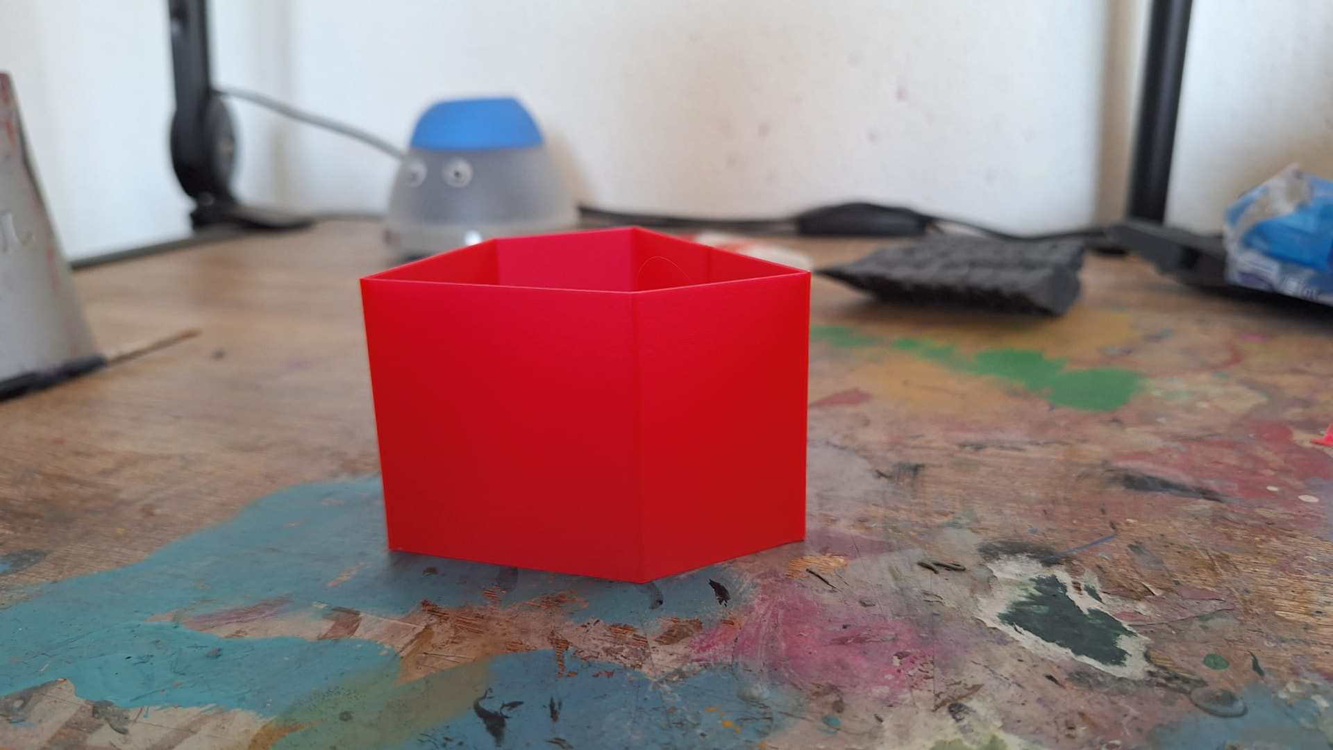

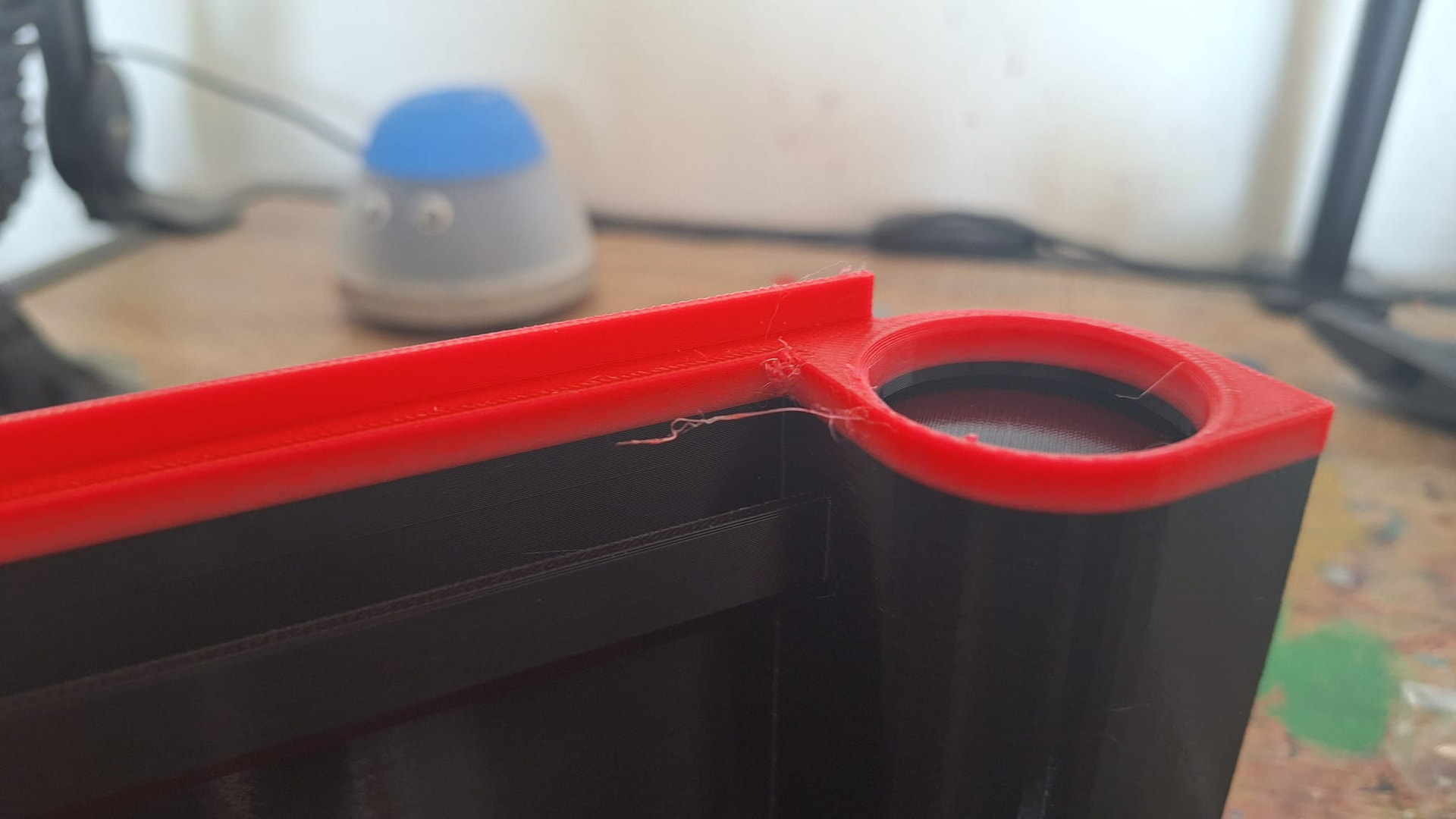

First thing I’ve noticed was that the Filament kept piling up in curved areas of the print:

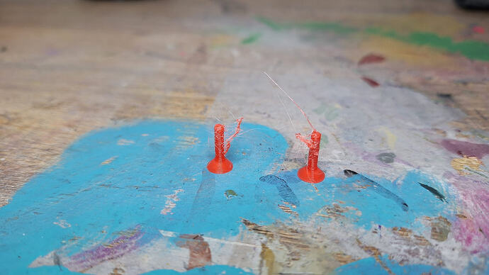

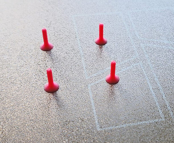

You can see that there is a large clump of red filament right on the edge of that corner. This was printed with Glow PETG on the Aux Nozzle. Another absolutely desastrous print were these little pins, also printed on the Aux Nozzle:

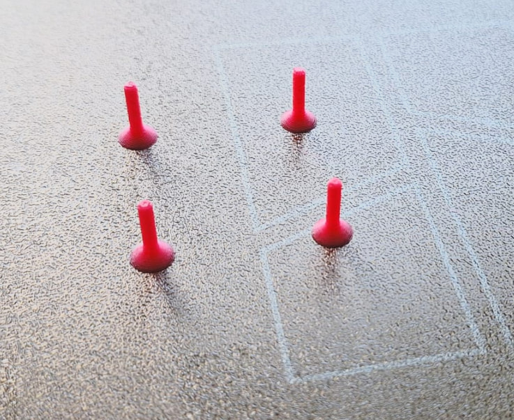

For reference, this is what they look like on my A1:

So I essentially had to Brute-Force the Retraction Settings, slightly increasing and decreasing them until the Pins finally came out alright. Not great, still worse than on the A1, but okay.

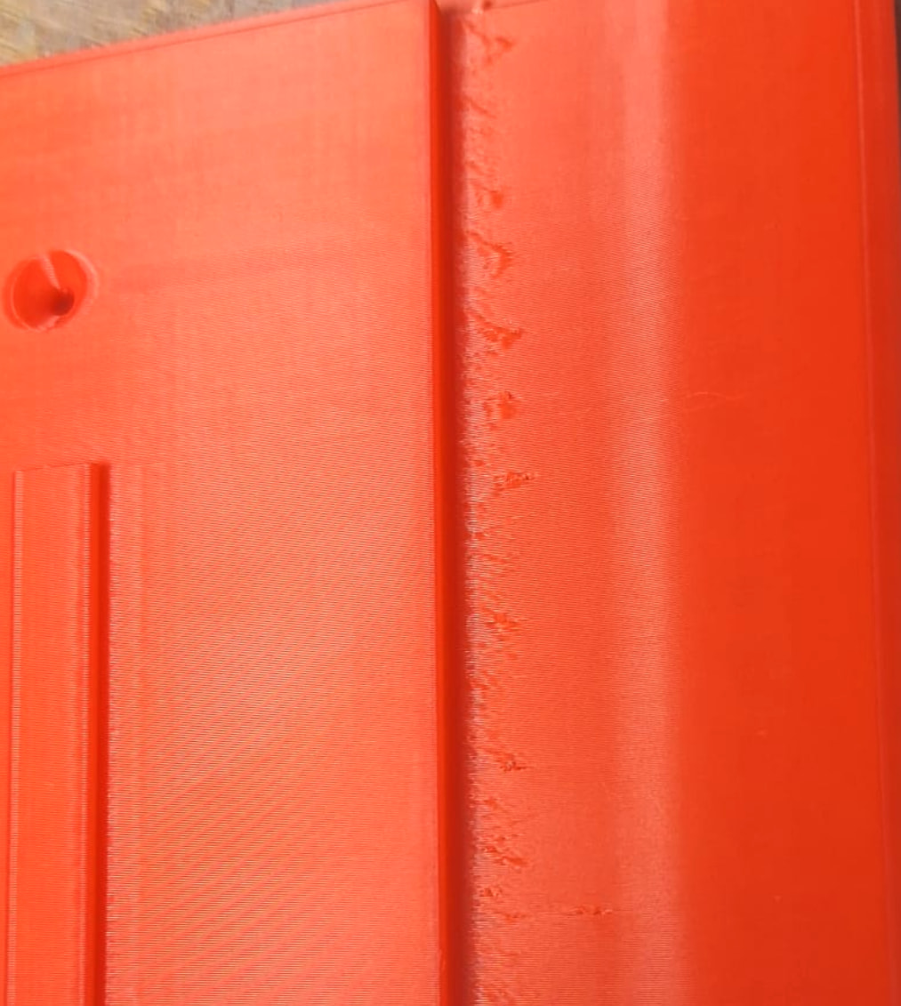

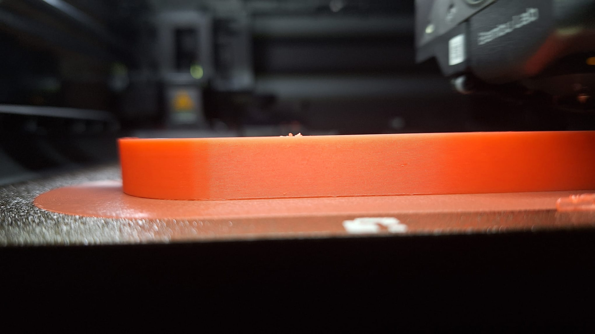

But the Filament keeps building up / oozing / overextruding in corners:
Which results in a jagged, torn surface area:

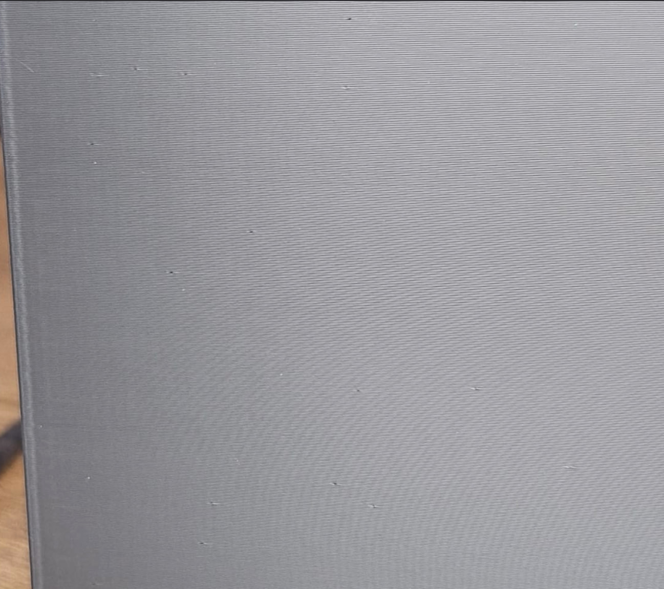

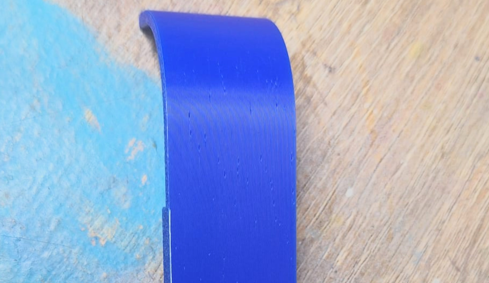

So I figured, Okay, maybe it’s just PETG. Just try it with PLA. Only for the print to be completely covered with tiny holes:

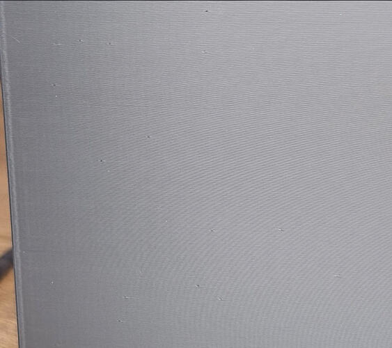

To make matters worse, this ALSO happens on the Main Nozzle, again with PLA:

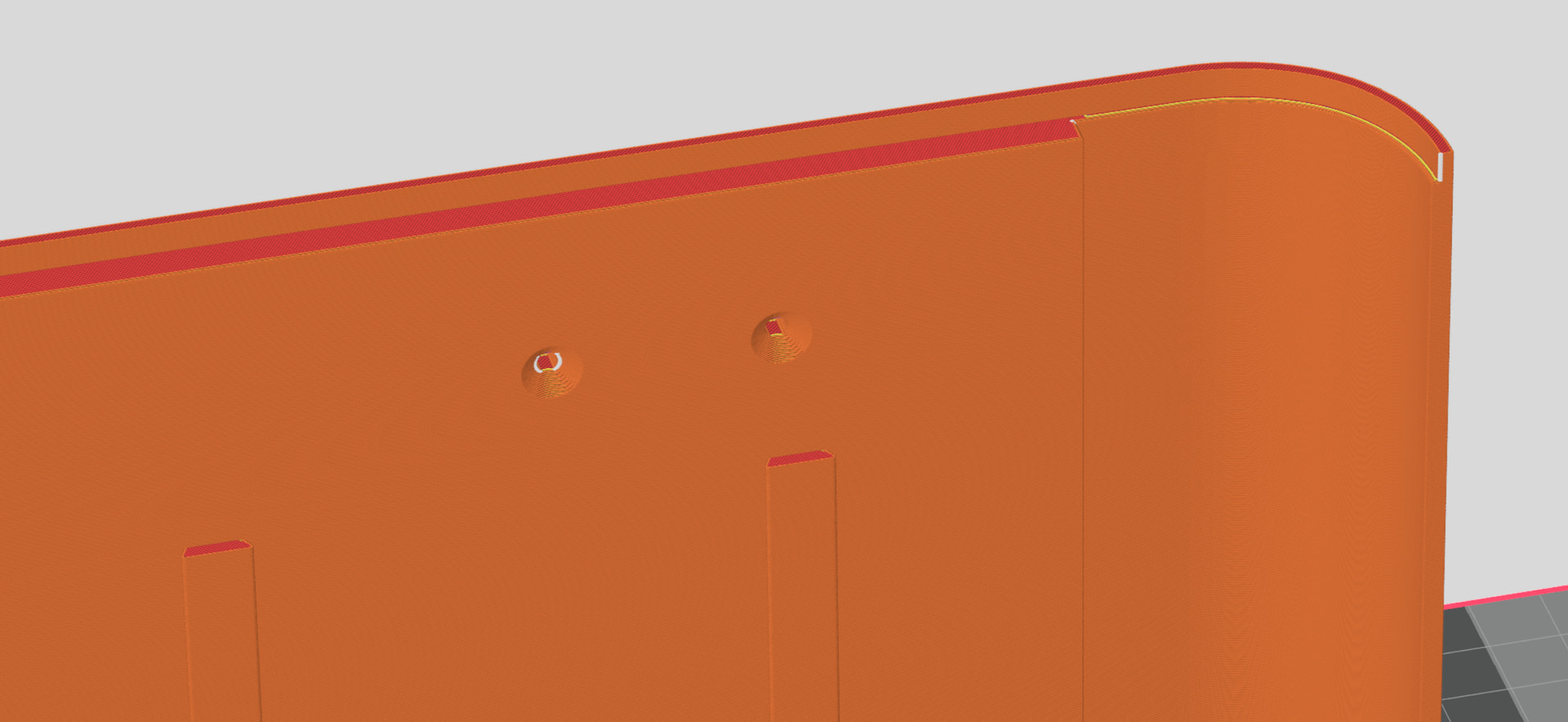

  8. No, it’s not the Seams, they aren’t placed near the spots where the holes or imperfections are:

It’s not clear exactly what your issue is, specifically the bubbles on Plain PLA. I know you mentioned it but you are REALLY sure that specific test wasnt random seam? :slight_smile: [the photo shows zero layers exhibiting more than 1 defect, the defect doesnt look “blown out”, it looks “emerging from within” — seam is occams razor] How’s your surroudning setup? Are you using like 4 ams with 12 splitters and track switches and rube goldberg machines? Whats plugged into each nozzle, a single directly plumbed AMS, external spool on a roller, etc ?
This with the random seam is interesting. He should be able to see it in the slicer if enable seams to be displayed.
