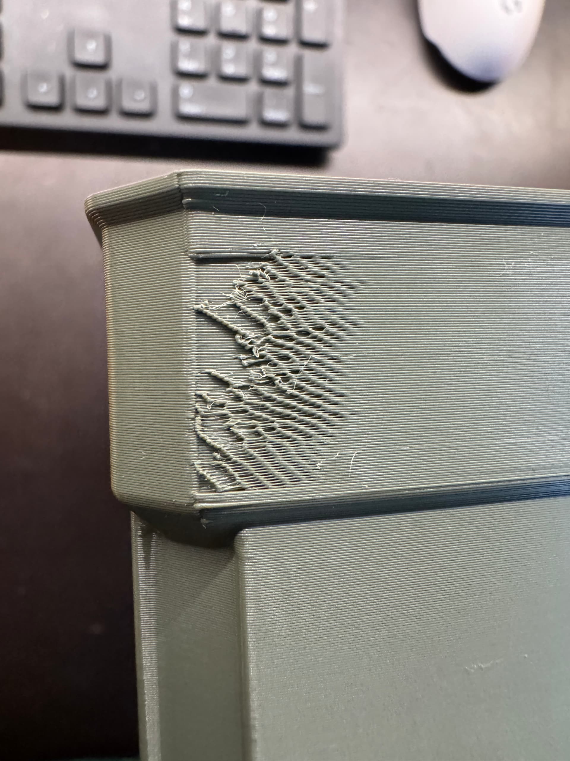

Max Outer wall speed
Has anyone experienced something similar?
Stock H2C.
Bambu PLA Basic (various colours)

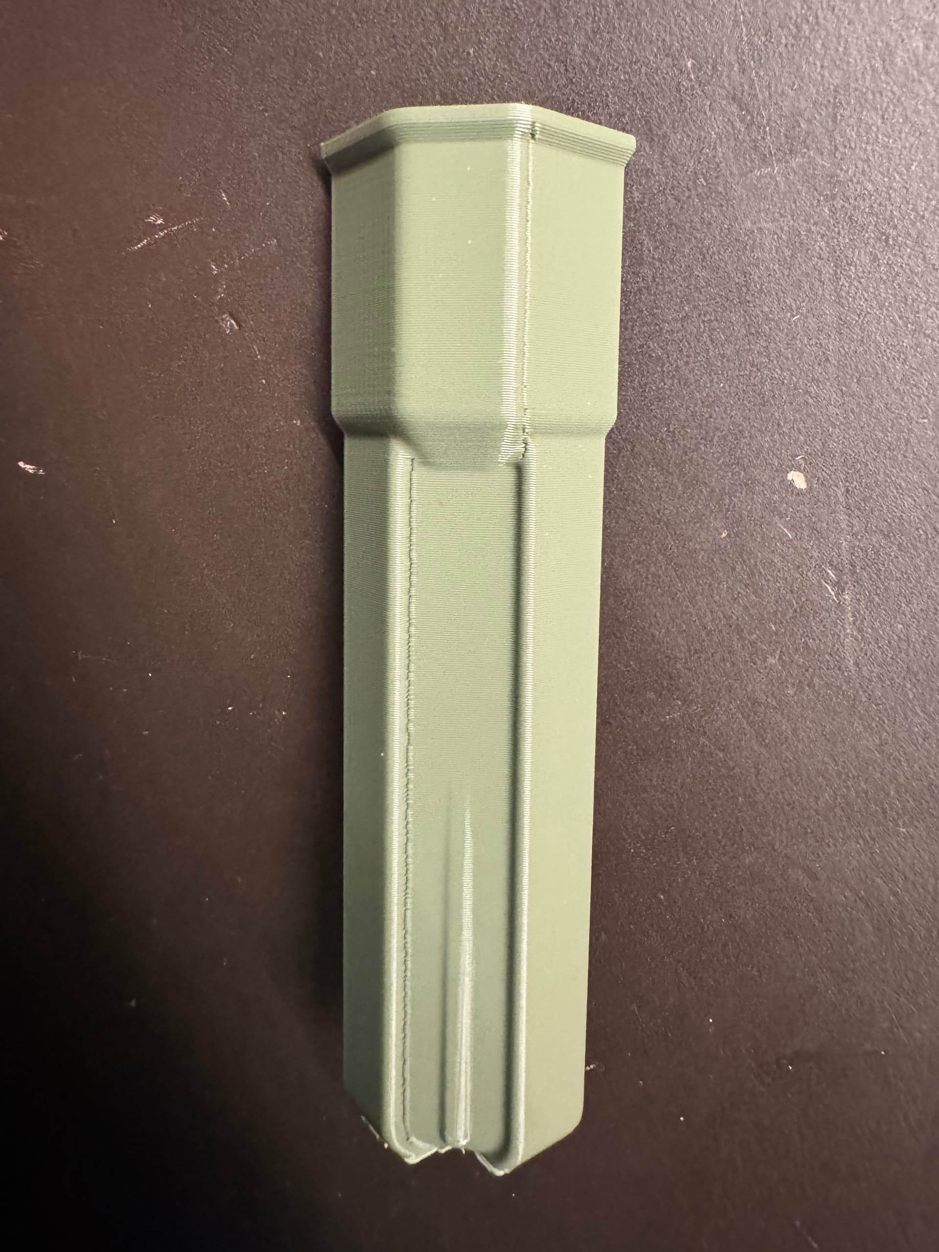

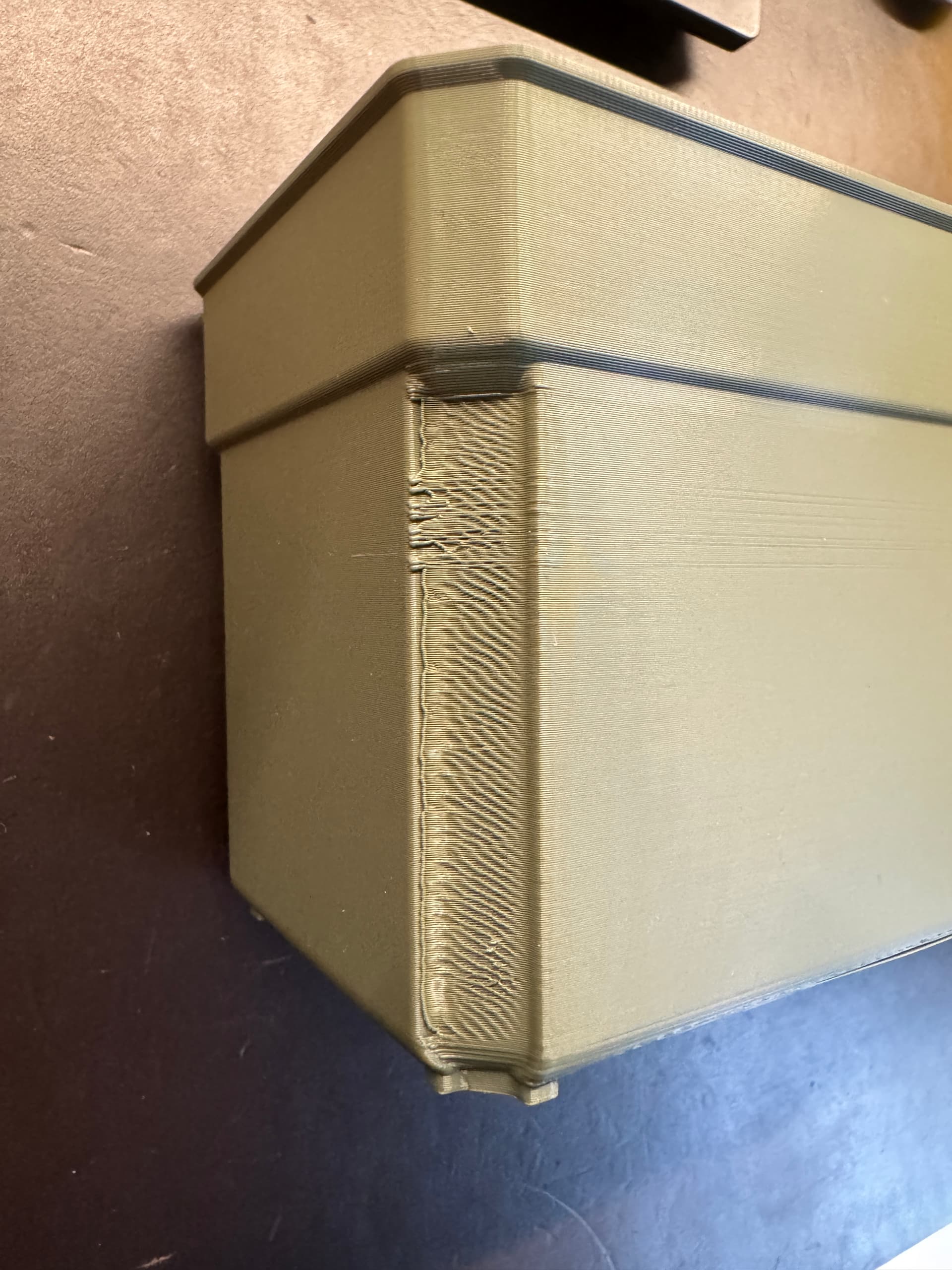

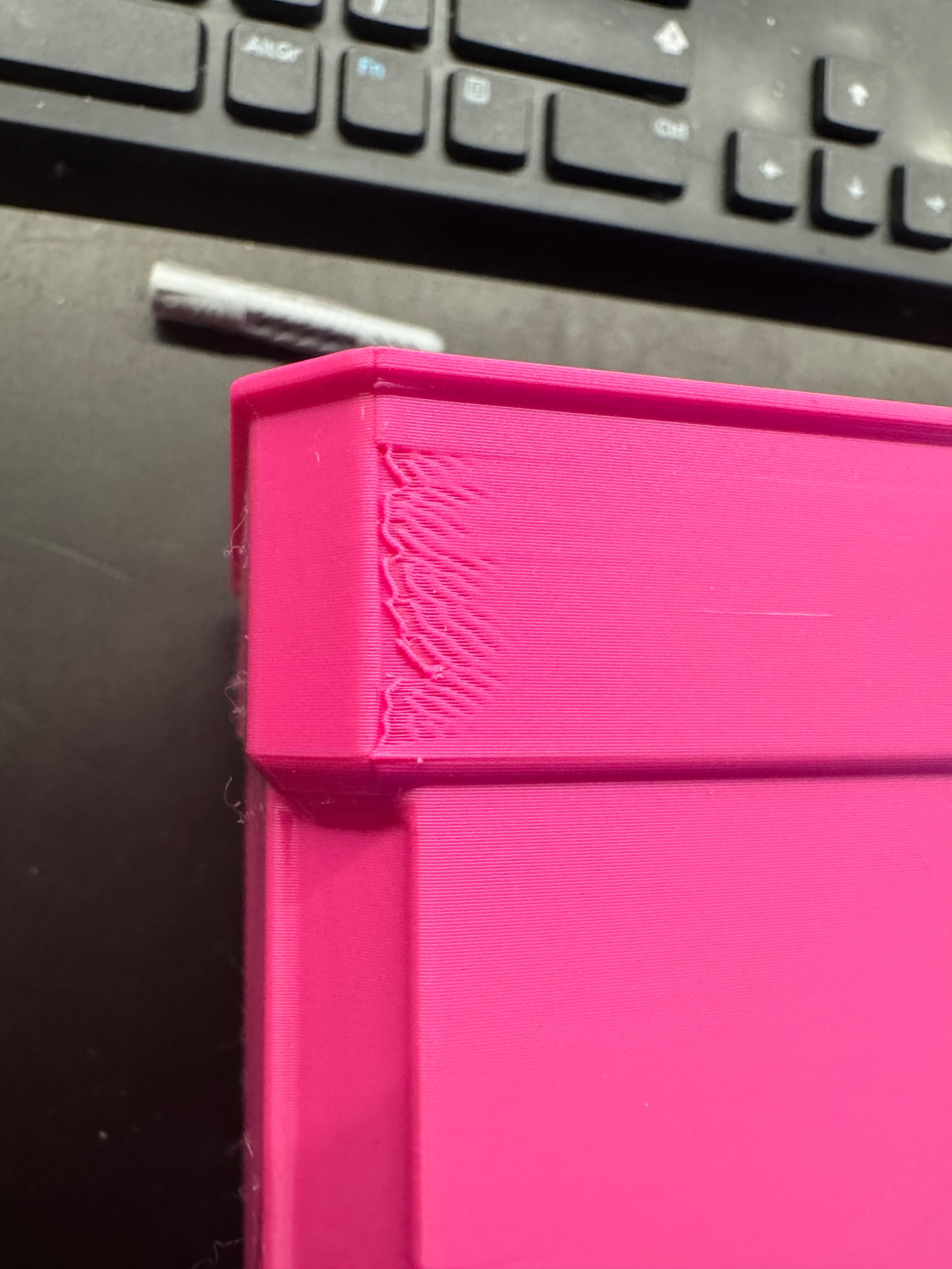

No matter what I do, I can’t get it to print section of outer wall at the start of the layer reliably at 200mm/s.
Inner walls print fine. Some parts of outer wall print fine. As you can see in the images it eventually prints better towards the top of the print.
Prints fine at lower speeds.
Prints fine on P1S at 200mm/s
Tried brand new induction nozzle, tried few different colour filaments. All filaments dried.
Only thing that makes a difference is reducing speed but I need to print them quickly as I need many.

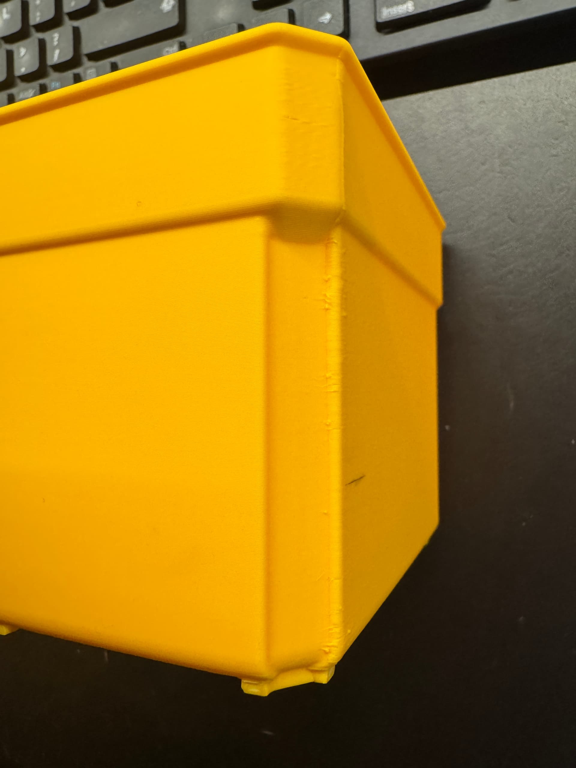

Small section shown in second to last image printed with stock 0.20mm standard profile. Print quality is acceptable but it printed much slower due to minimum layer time. Yellow printed at 100mm/s.

I’ve tried positioning this seam at all 4 corners.
Tried printing with aux fan off and door open.
All produce similar result. I will be testing it further to get to the bottom of it but at the moment I am just printing it slower to get it done.

Cranking the part fan to100% did not help. Made it worse. Tried both with printer door open and shut.

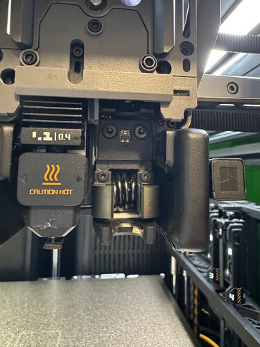

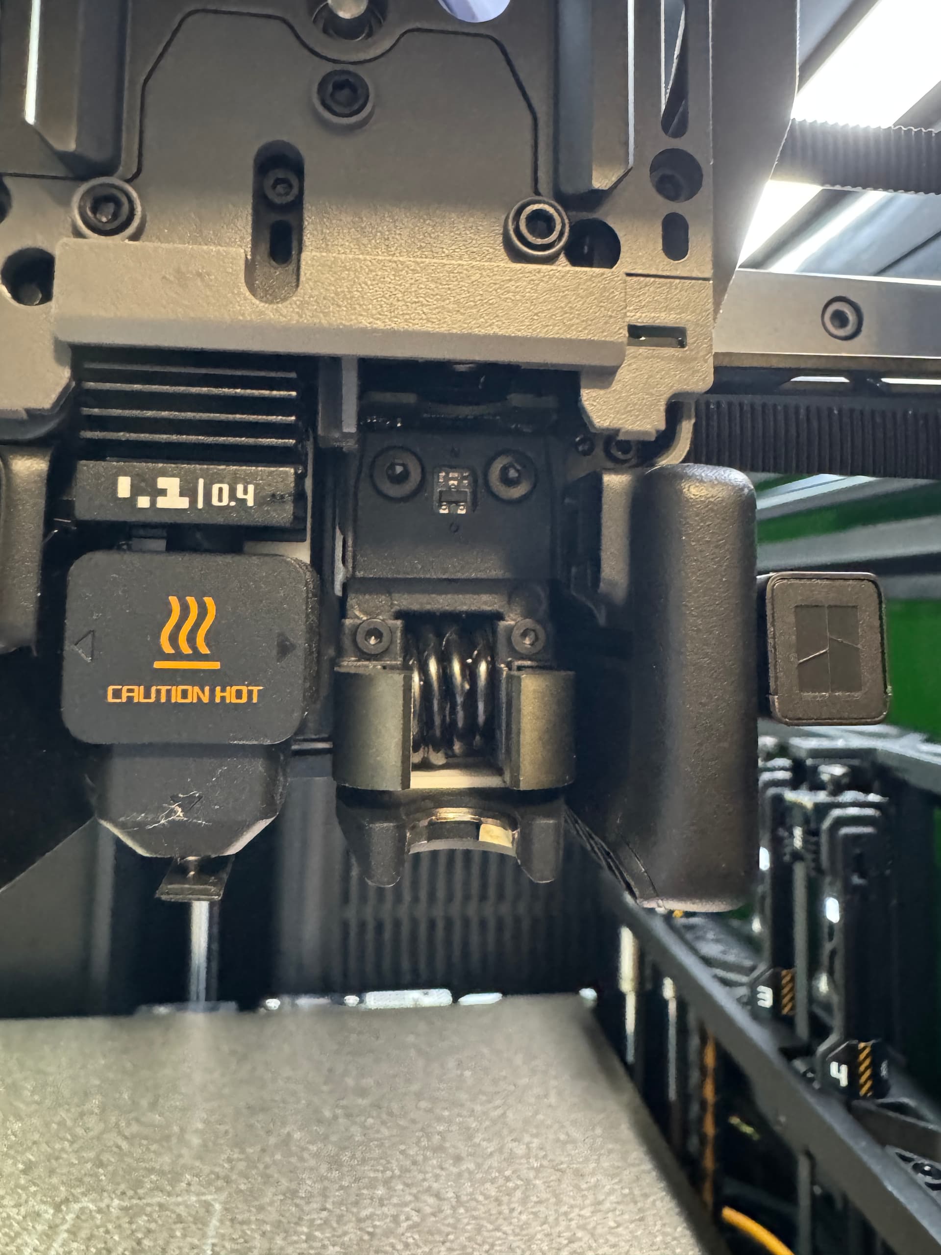

I think I found the problem. Decided to go over the print head and discovered some loosened/ not fully tightened screws. All 4 screws in the right hotend area were not fully tightened. I could turn all of them between quarter and half a turn without much force.
I’m now printing same model to see it this resolved the issue
I think it’s fixed now.
Printed two boxes with good results
