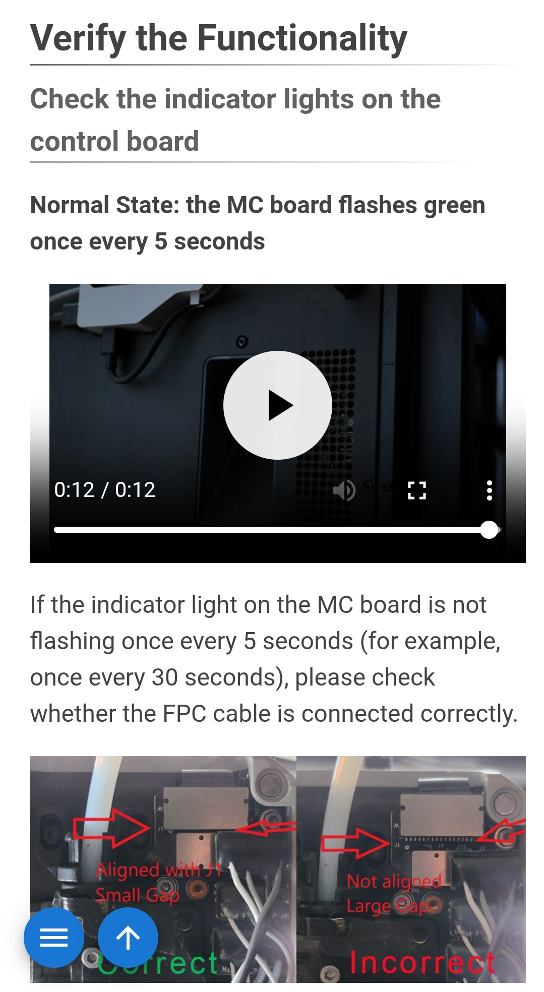

MC Board green light on?
should I be able to see a green light on the MC board through the front of the machine?
and should there be a green light when looking at the rear of the machine below the ext spool hollder?
Yes, there is a green light that should flash. From the Bambu Wiki:
