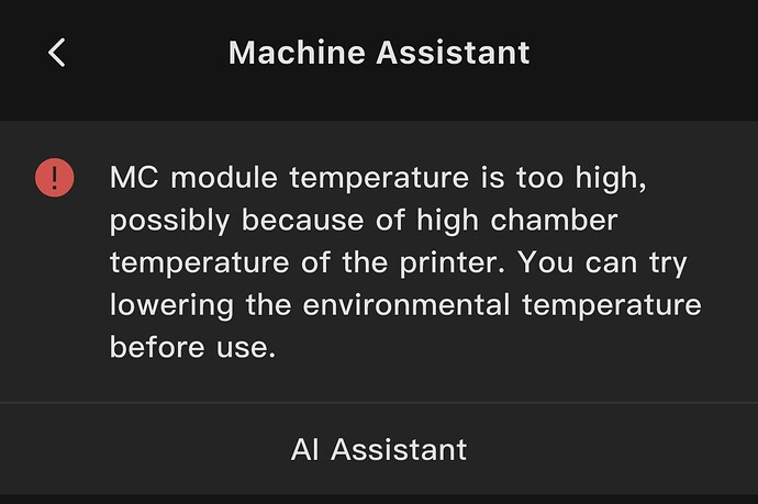

Completed a 20 hour PA6-GF print today. Bed heated to 110°c and chamber heated to 65°c.
This error popped up intermittently about 3 times towards the 16 hour mark. A quick google search shows I’m not alone on this.
It just so happened to be that this was about mid day where the sun was warming up the ambient temp in my home. It’s starting to get cooler out so I turned my AC off. Running the chamber and bed so hot I’m sure the electronics compartment was cooking. I turned my air conditioning on to cool off the house and lowered the chamber temp to 60. That seemed to clear the warning.

I had a similar error when I was doing a long Nylon print and my chamber was set to 65c. Thankfully it was not a critical error and the printing was not paused. I turned down the chamber temp to 60c and the error cleared pretty much instantly. When Im doing a long (10+ hour) print I just turn down the chamber to 60c.

That sensor is probably tuned for 60c chamber temp that is standard on the filament profiles, so even if it throws the error its probably not a big deal. I had chamber heaters on my P1s and X1 and they were all fine with 7000+ hours between them. I did have the TH board fail on X1, but that was due to the dual hot end heaters I was running.

You will make the chamber heater work harder if you install that extra fan as you will be pushing cold air in, they will be working against each other. Will probably take away that 5c extra temp we set in the first place.
They most likley have it set to 60c to keep a 5c buffer and prevent the errors we are seeing.
