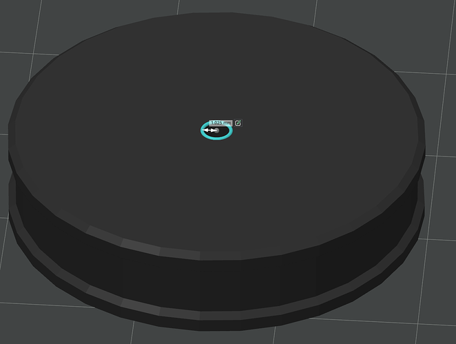

I don’t quite understand, I measure a radius in the Bambu Lab studio for an inner diameter of a wheel to put an axis in. However, after printing the diameter does not match and is substantially smaller? Do I need to consider outer wall thickness on top and design the model larger? How can I exactly print to mm measure?

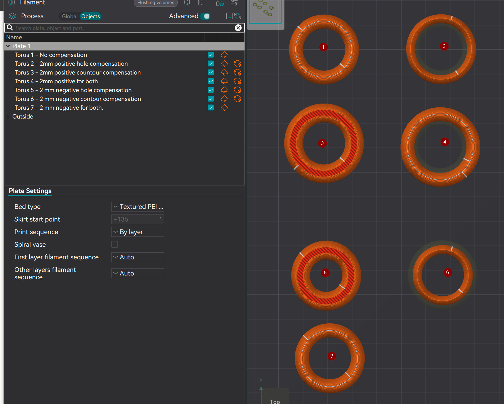

Go into the X-Y compensation and adjust for the differences in what you wrote down. Minus values shrink holes, plus values increase holes. Contours are for outside boundaries. ±2mm is the max that the slicer will allow. For any values beyond that, your best to modify the model in CAD.
Here are some extreme examples for visualization. Notice that the changes in X-Y compensation are not visible until the model is sliced. This is using a torus primitive with the default values of 28.48 x 28.48 x 5.66mm

I couldn’t help notice that your model is a bit on the low resolution side. I’m guessing you’re using STL files. STL files are a mesh and the slicer is only going to adapt the polygons that the CAD program provides. However, STEP files are mathematical vectors and therefore provide for infinite resolution. True, once you import a STEP file, you will have a mesh and lose all future fine scaling abilities but you will be starting out with quality curves and dimensions.
