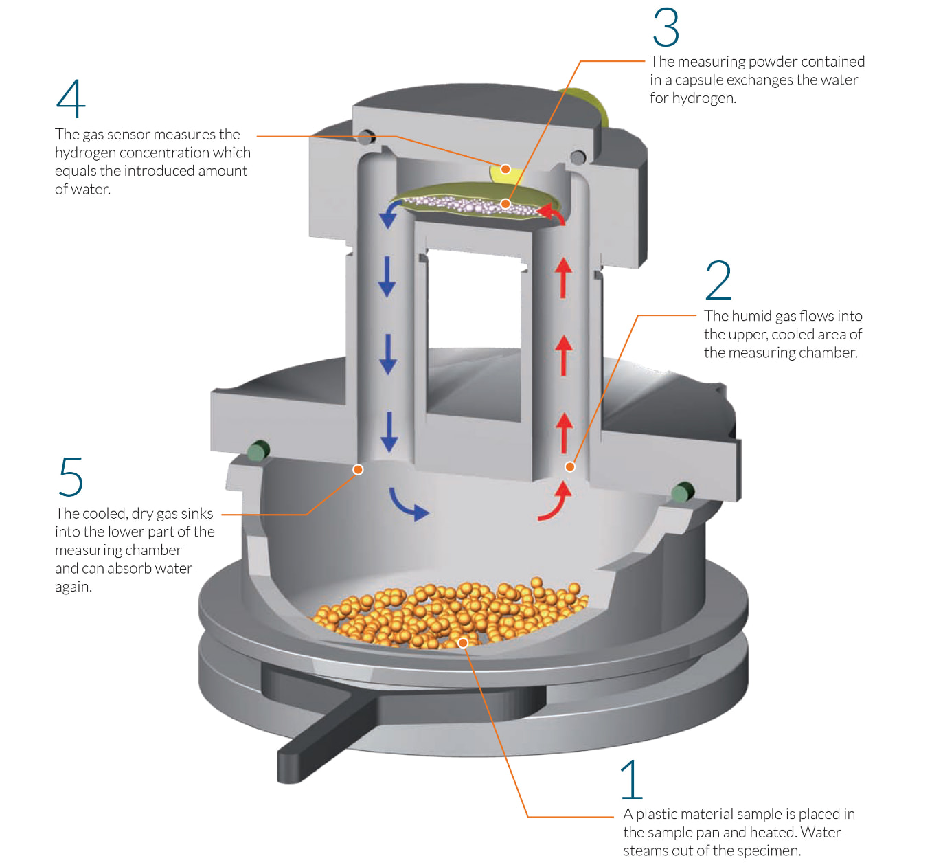

The HydroTracer 3 sells between $14,000 and $23,000 depending on accessories. If you don’t mind waiting 30-45 minutes you can do the same testing on filaments for about $10 for a Praki thick-walled sealing container and a cheap hygrometer. It might not be as accurate and certainly is slower, but the principle is the same. Humidity tells you moisture content. They just go a step farther to convert to actual moisture content and get the numbers faster.
From their web page - it’s a schematic of how their instrument operates. They let the plastic equilibrate with the air and then indirectly measure humidity. But make no mistake - the underlying principle is using humidity to know moisture content.
So for those who doubt it works, companies drop thousands of dollars on testing equipment that does the same measurement albeit much faster. But we can do it on the cheap if you don’t mind the 30-45 minutes you have to wait for a hygrometer to settle. You can even use a ziplock bag instead of a Praki. The plastic bags are just subject to water vapor diffusing across the bag walls and affecting the measurement if you leave them longer than necessary.

If I understand it correctly, it seem to work by heating the water out of the sample and measuring the quantity of water liberated via a stoichiometric intermediate reaction.
If someone asks “how is this different than loss-on-drying” this method is highly selective for moisture and ignores VOCs.

They are doing a controlled heating to help liberate water. That’s what filament dryers do. The heat just helps evolve the water. Gets them bigger numbers and better signal to noise. Their heating is going to be carefully controlled and reproducible and really will only serve to put more water into the vapor phase.
Yes, they will be working at higher humidities because presumably water will come off faster than the heat reduces relative humidity, but they aren’t measuring the humidity or the relative humidity. They are quantitatively measuring hydrogen liberated from water.

They heat the sample. Equilibrium humidity is at room temperature because of the temperature dependence on relative humidity. The difference is they evolve more water faster but it’s still just water. You could do the equilibrium humidity test at elevated temperature too but you’d need to make sure all tests were done the same to compare results. Even saying room temperature allows for differences and errors to creep in but they aren’t even measuring minor. We don’t need super-accurate numbers for our purposes. No temperature controlled oven is needed and the measurement is available to lots more people since you don’t need much hardware.
They use a chemical reaction to convert water to hydrogen and measure that. Equilibrium humidity is measuring the water itself.

Also checked the temperatures they heat to and the range is 50-210C. It’s not going to be a decomposition. It may soften or even melt, but not enough information to know the strategy and I haven’t found what temperatures are used with which plastics. But 210C is extruder range. It seems the heating is likely more to speed up the test and results.
I’ve been thinking about it Krell and you have a point. There is a fundamental difference in the techniques. Worst case comparison is if they heat it hot enough and long enough to quantitatively recover all (almost all) of the water trapped in the filament.
A humidity measurement just relies on some amount of water proportional to the water contained in the filament to be present in the air around it. Back to the measuring cup holding all the water vs looking at something physically related to the amount of water present.
So yes, in that respect the measurements are very different and it’s obvious that if you can capture all the water even if you change it to hydrogen and measure that, you are capturing and quantifying all the water.
However, filament is a desiccant too and the humidity around it is physically and directly related to moisture content just like it is with other desiccants that reversibly adsorb water. To measure the RH in an equilibrium test is also a measurement - indirect - of the filament moisture.
So in that respect, I’ll give that the two tests are less comparable than I originally said, but they are still equivalent in many ways. Just as the instrument isn’t actually measuring water but is instead measuring hydrogen derived from the water, using RH isn’t actually measuring water content directly either. But both give numbers physically related to the amount of water present in the filament.
So good point but both tests seem absolutely valid and still similar even though the operating principle is different. How different depends on how much they heat the plastic and if they get all the water or if there is some factor involved for leaving some amount of water behind. That would move the instrument test closer to raw values that are physically proportional to the amount of water but that are not the true total amount of water.
