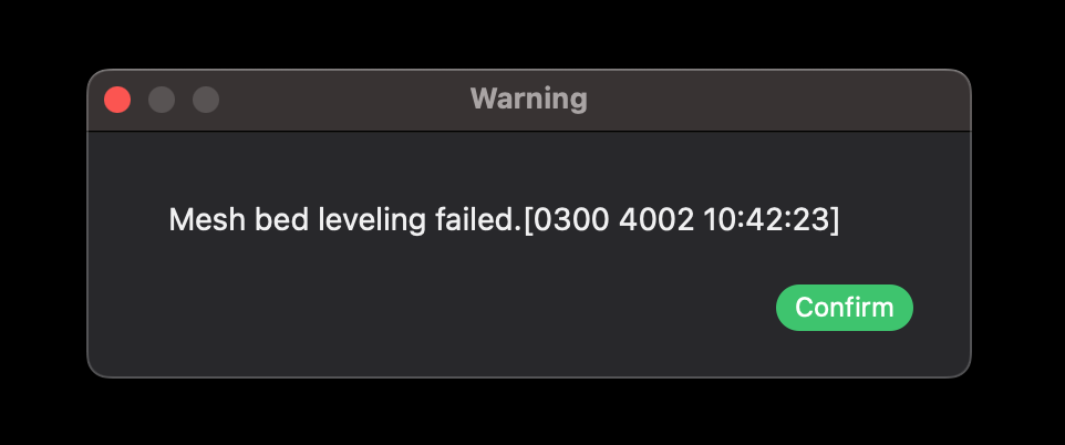

So, I don’t print too much with high temperature plates like the textured one, but in the last week I did it sometimes but after the first successfully print I started receiving this error if I try to print something else (with bed calibration).
I did a full recalibration successful (with the same plate on), but the problem raises again if I try to print.
P1P with AMS and some mods (enclosed, chamber fan, mcu fan)
Error code 0300_4002 doesn’t seem to be one shown in the wiki, last 3 couples of digits are the error time (10:42:23)
Any idea?
No idea, but there’s the error code and detail.
“ecode”: “03004002”,
“intro”: “Mesh bed leveling failed.”

I had the same “problem” – I had the magnetic build plate turned 90 degrees. Probably not your problem, but thought I would suggest it.
