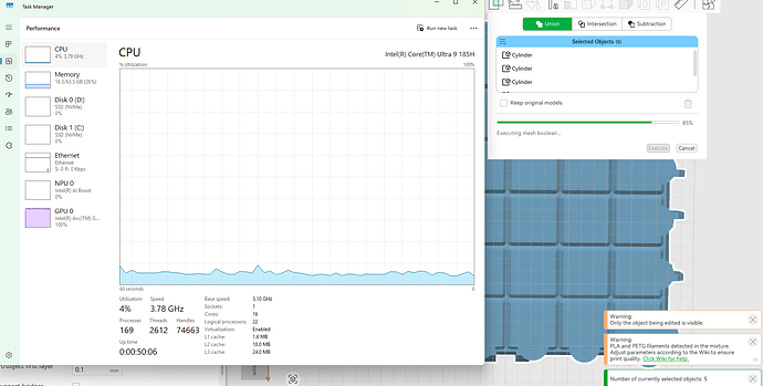

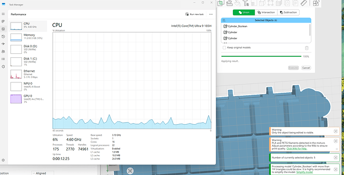

It’s still insanely slow:
Been grinding away on it for over 10 minutes. It’s warning about too many triangles as a possible cause for slowing down.
Since the bottleneck is GPU, apparently I either find a way to use fewer triangles, or else I need a better GPU.
At this rate it’s going to be literally multiple hours to union the last four mouse ears using mesh boolean. Ouch. Bambu needs to hire some real computer scientists to speed up their algorithm.
I rebooted prior to running the mesh union, so up-time is fairly close to execution time.
The progress bar just seems to keep getting slower and slower.
I gave up and ran simplify. Apparently it has more than 11 million triangles.
