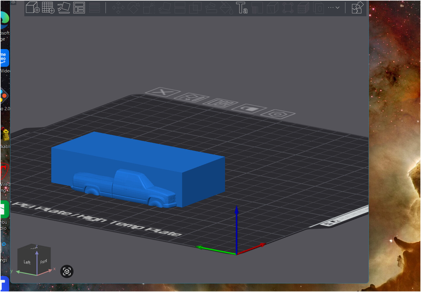

using a model and added cube in slicer to creat hollow space is not working for me. it slices solid every time i have tried many different methods to do so.
this worked before many times, what changed ??

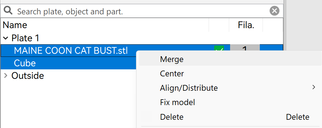

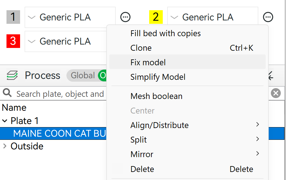

The mesh is probably faulty, but you can try repairing it in Bambu Studio. However, I should mention that this often fails. Bambu is not the right software for fixing mesh issues. In the object window, you must click on ā€œfix model.ā€

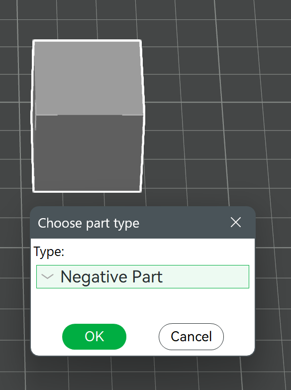

Also make sure that your objects are grouped - at least in this scenario. Click on ā€œmergeā€

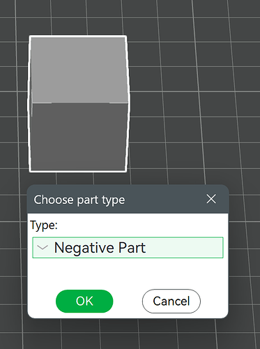

Don’t forget to set your added cube to negative!

It appears to be working correctly , when a negative part is added

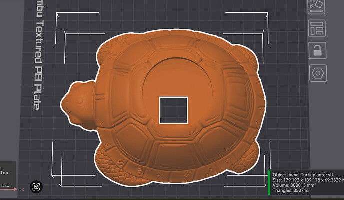

Could you please elaborate on what you mean here by inverting the model? Running into the same issue with my model, I just want to remove the imprint of a cube from my model and it does nothing when meshing.

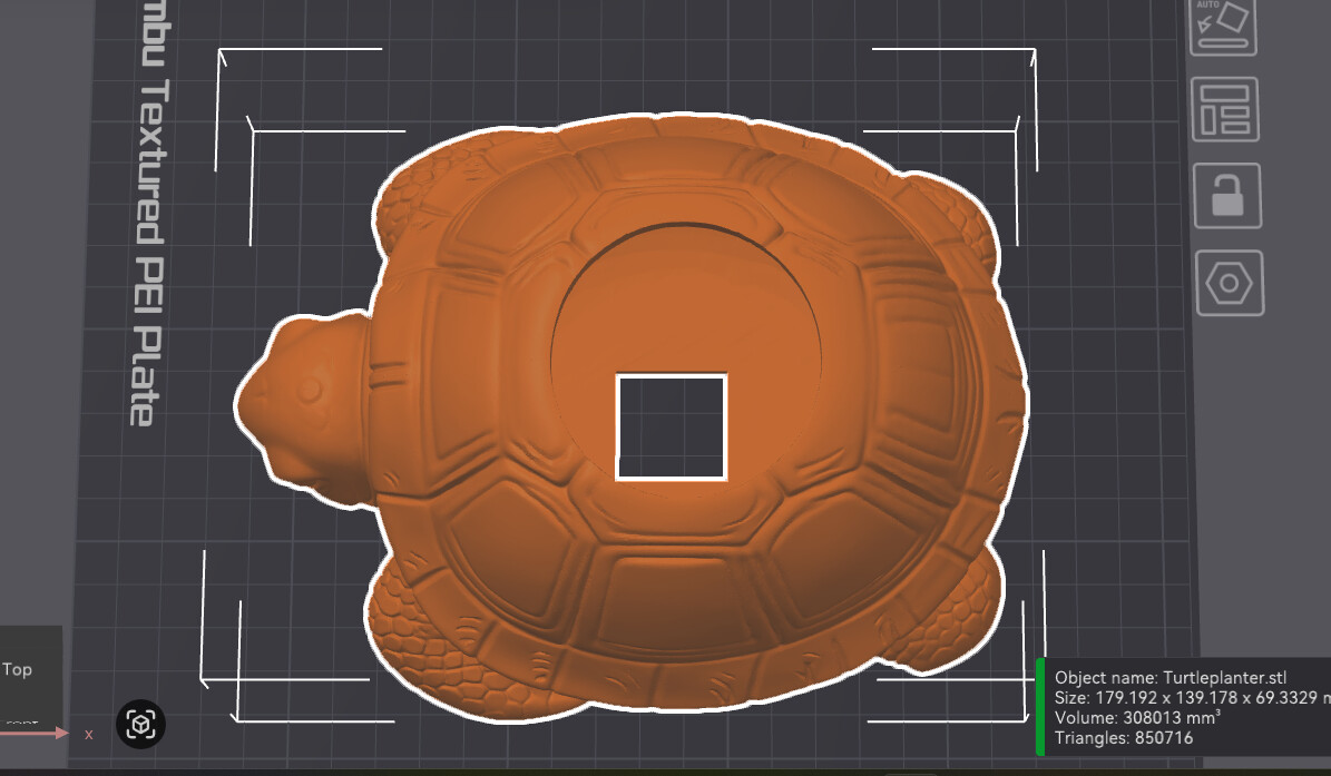

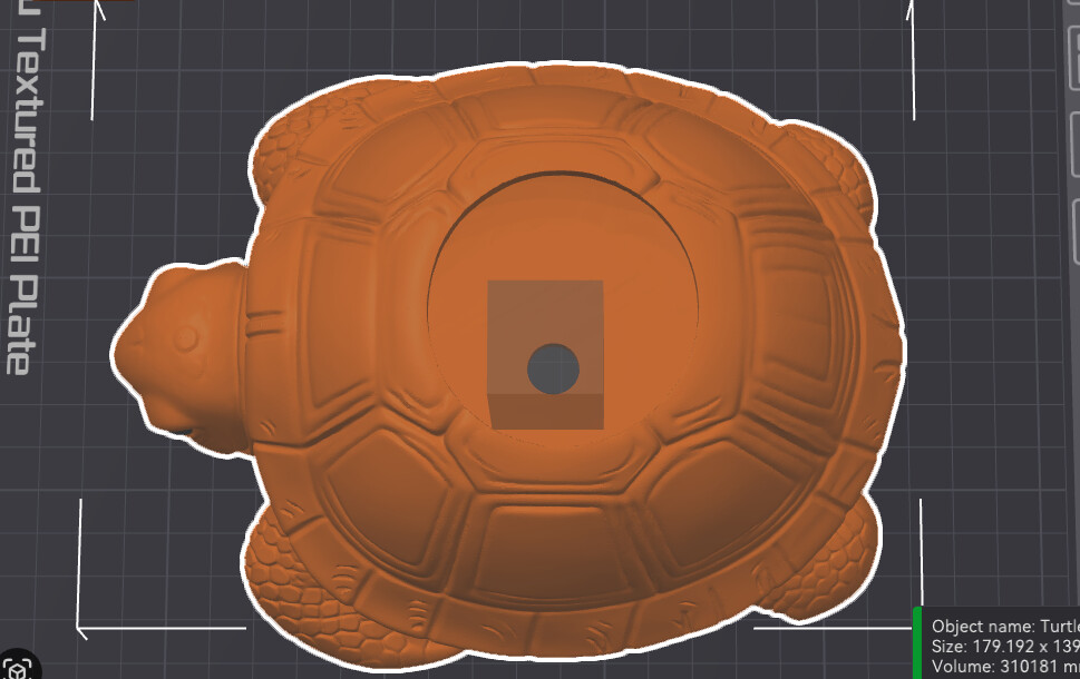

the first image is what i tried to do, the second image is what worked after a while. i left the model out of the box for reference only
this way didn’t work and sliced as solid box
this way sort of worked after a few tries
left model just out side of box for referance

  • Check your objects are merged into one assembly - Easy one to miss.

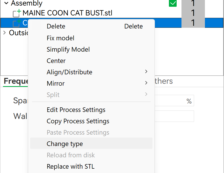

  • Repair the model by right clicking > Fix model - I fix both objects for good measure, especially if I’ve done a bit of fiddling.
  • Export the object you are using to subtract as an .stl file by right clicking > Export as one STL - I saw this trick in a similar post and it has solved most of my encounters with failed meshing. Fix the model before exporting.
    • Next, delete the old object, add its .stl file back into the project and make sure to merge.
    • Sometimes, I’ve had to reload my project first for the importing trick to work. Don’t ask why, I don’t question anything at this point.
  • If your mesh subtraction is taking a long time and then failing, it may be because your model has too many triangles. Try simplifying the model (detail level = extra high) then sprinkle in any of the above steps as required. Not sure if this has implications for model quality but I haven’t seen any myself.
My usual process is: Fix/simplify model > Export as .stl > Import .stl > Merge > Subtraction > Profit. I’m not too well versed in Bambu Studio so some of this may be overkill, though is largely the result of trial and error. Hope it helps :slight_smile:

Unfortunately I’m on MacOS and there is no ā€œFix modelā€ option. I’ve tried everything else and ultimately I ended up getting the desired result by downloading Blender and performing the mesh there. I was able to export the difference back into Bambu Studio as an .stl.
