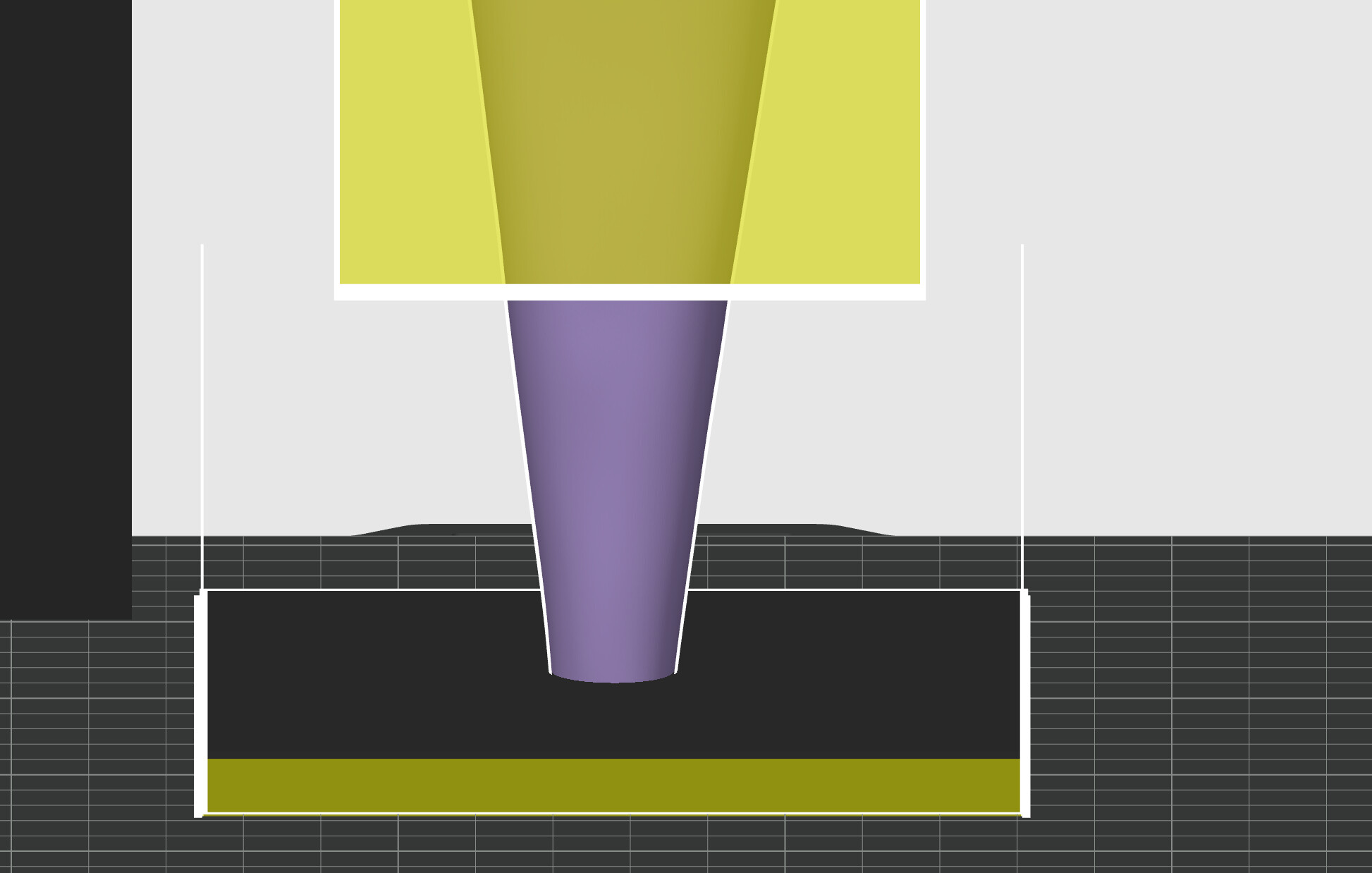

is there a way to view my models as a mesh or outline and not as smooth shaded in the “prepare” mode ?
I am trying to add modifiers inside objects for extra strength but its impossible to position them properly as once they are inside another object you cant see anything…
a mesh view would solve this but i dont see the option anywhere…

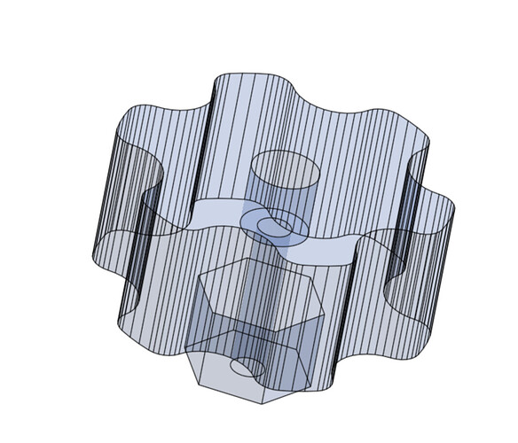

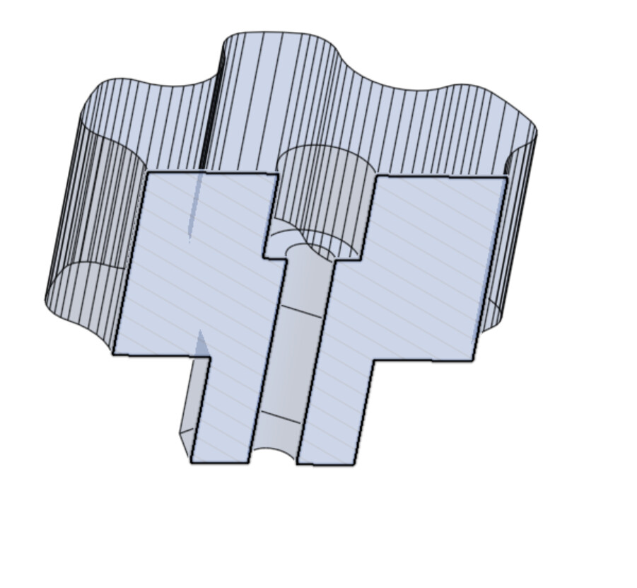

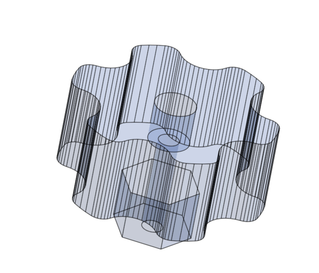

If I understand you correctly, your looking for something like one of these.
Hidden lines or sometimes called X-Ray in solidworks
Cross Section

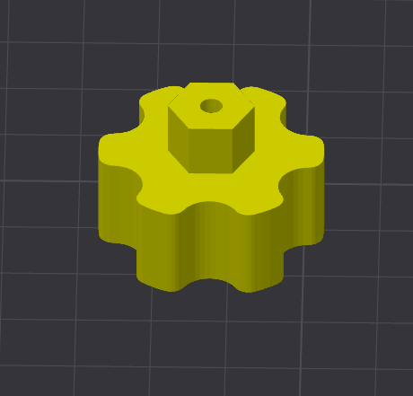

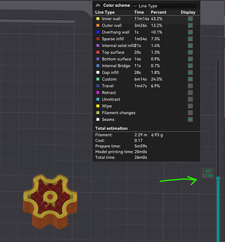

The object as it looks in the slicer

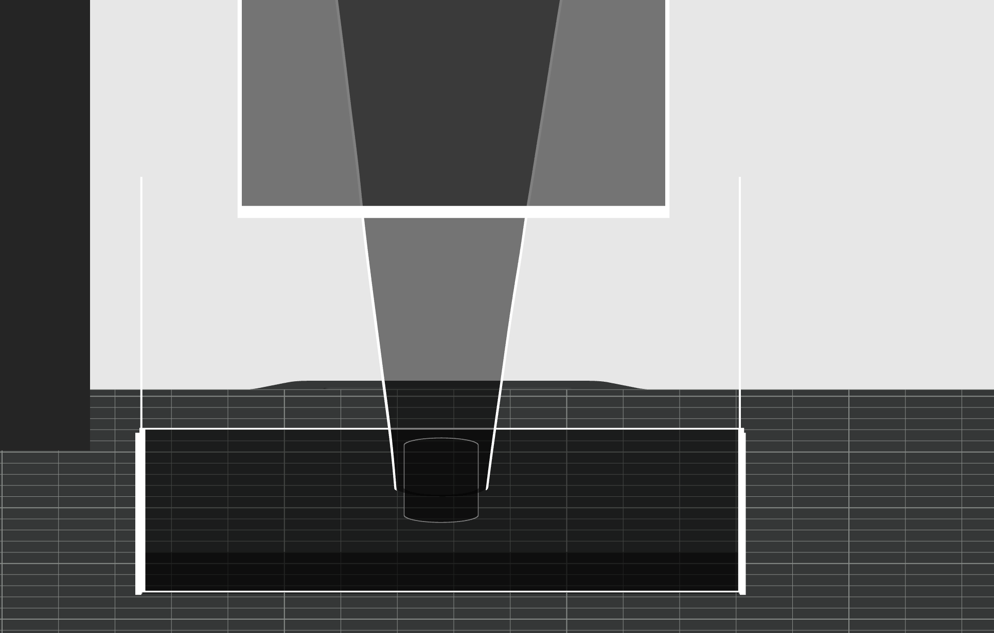

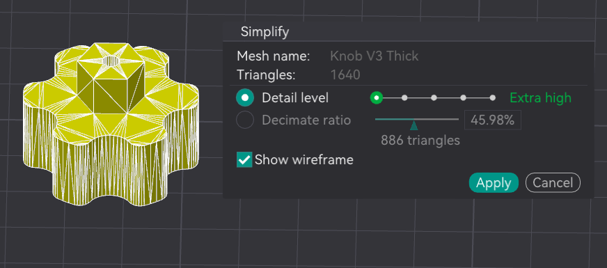

And with the mesh view turned on in the simplify tool.

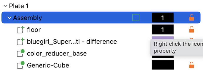

Firstly, merge a bunch of objects, they should now appear in the object list as an Assembly.
Right click objects and go Change Type. You can now make them a Part or a Negative Part (which are not printed).
You must always have at least one set to Part, but you can create another random object in the assembly and keep it as a “part”.
This lets you hide the outer most mesh and see whats “happening inside”.
Before you slice, you just need to think about whether you want every object to be a real Part or Negative Part.

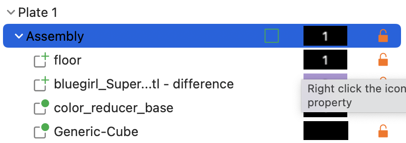

solution i found, which works ok for now, is if you have multiple parts in a group, you can just disable the group using the checkbox next to its name (Assembly here)…
the entire group becomes transparent :slight_smile: and you can them see pieces.
