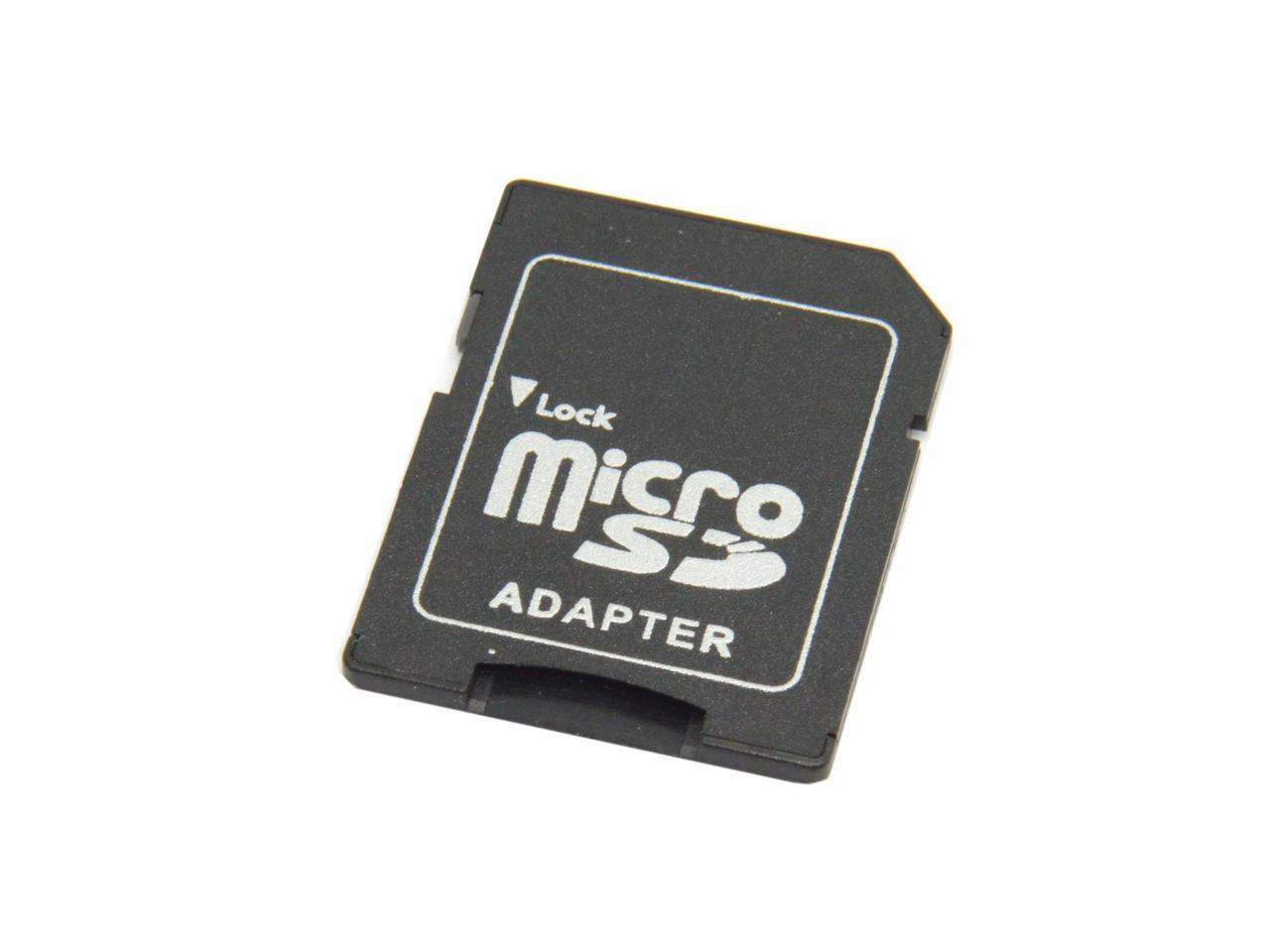

It doesn’t print without an SD card inserted, but instead of spending $40 on a new AP board, I decided to try replacing the broken microSD slot with a full sized SD to micro SD card adapter. My plan is to solder individual wires to the pads on the AP board where the microSD slot was, then connect the other ends of the wires to the corresponding pins on the SD to microSD adapter.

Now, here’s where I’m confused: there are nine pads on the AP board, but a microSD card only has eight pins.
From what I can tell, it’s likely that only the leftmost eight pads on the AP board are relevant, while the ninth one (the far-right pad) might not be necessary. I’m assuming this because the far-right pad appears to be positioned too far over to line up with the pins on a microSD card when inserted into the P1S.
Please see the below image with more info:
