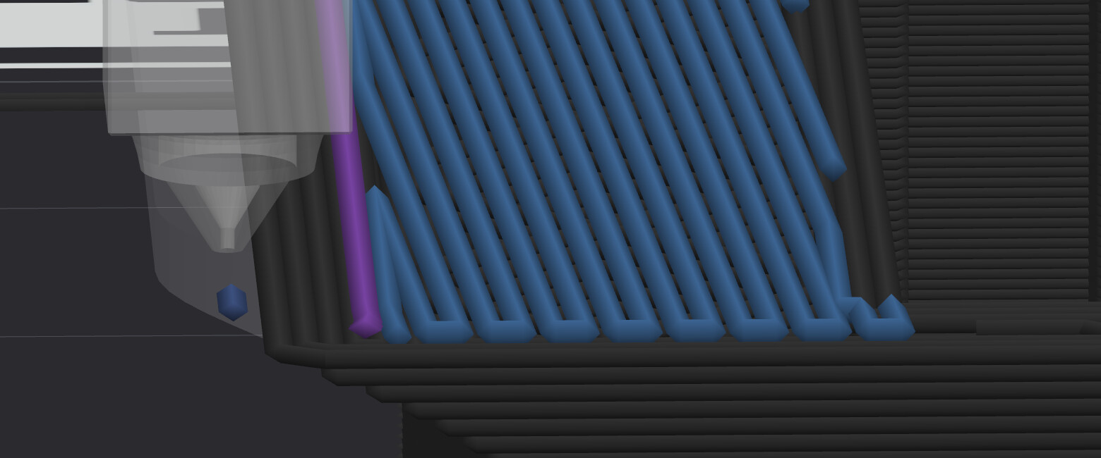

Mid-air print start of bridges
Is there a way to force start the position of bridges?
They are starting in mid air…
I dont understand why it starts there when i have support beside it.
I’ve tried to rotate the model.
Choose all options in “walls printing order”, tried the “bridge flow ratio” and reversed the “walls printing order”
somebody has an idea? can’t find a way to reverse the bridge start-end print sequence
Try adjust the support threshold angle so that it generates supports there. I never sure which way to go, but try either side of the default 30 degrees and slice to see if it works.
i noticed manual supports (painted) dont always hit the mark when dealing with thin overhangs, even though the painting is there
you may need to change this
i don’t have support.
What i’ve done is change the height to the lowest. The bridges got changed to internal solid and innner walls.
Unabled the “print infill first” so i have a neighbouring infill to stick the print on.
Still … would be nice to reverse the bridge print sequence…
