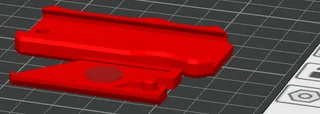

From one end of the body to the other there is .010" difference in ID width.
The slide is loose at one end, tight at the other when opening and closing.
0.4 nozzle, 0.2 layer, dry PLA+, almost 500hrs. on printer

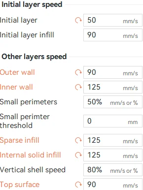

My speed setting shouldn’t be to fast. I’m using SUNLU PLA+ 2.0 Black and eSUN PLA+ Red for the 2 tone colors.
